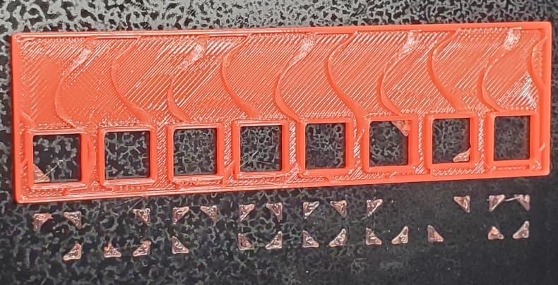

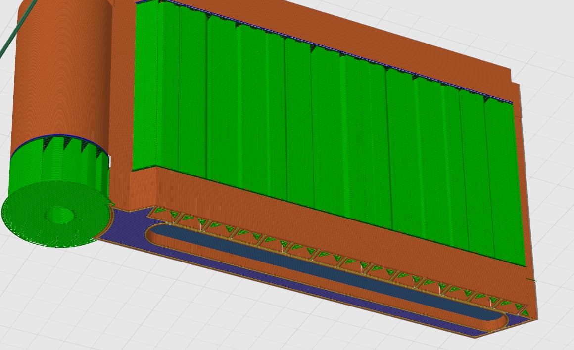

Undesired Support brim/raft
Any idea about how to remove these things? They are super annoying to take off from the plate.
I think is the support raft, even if the support are not even close to the plate. I believe is a bug but I can’t find a way to prevent them.
Normal manual support, style: Snug.

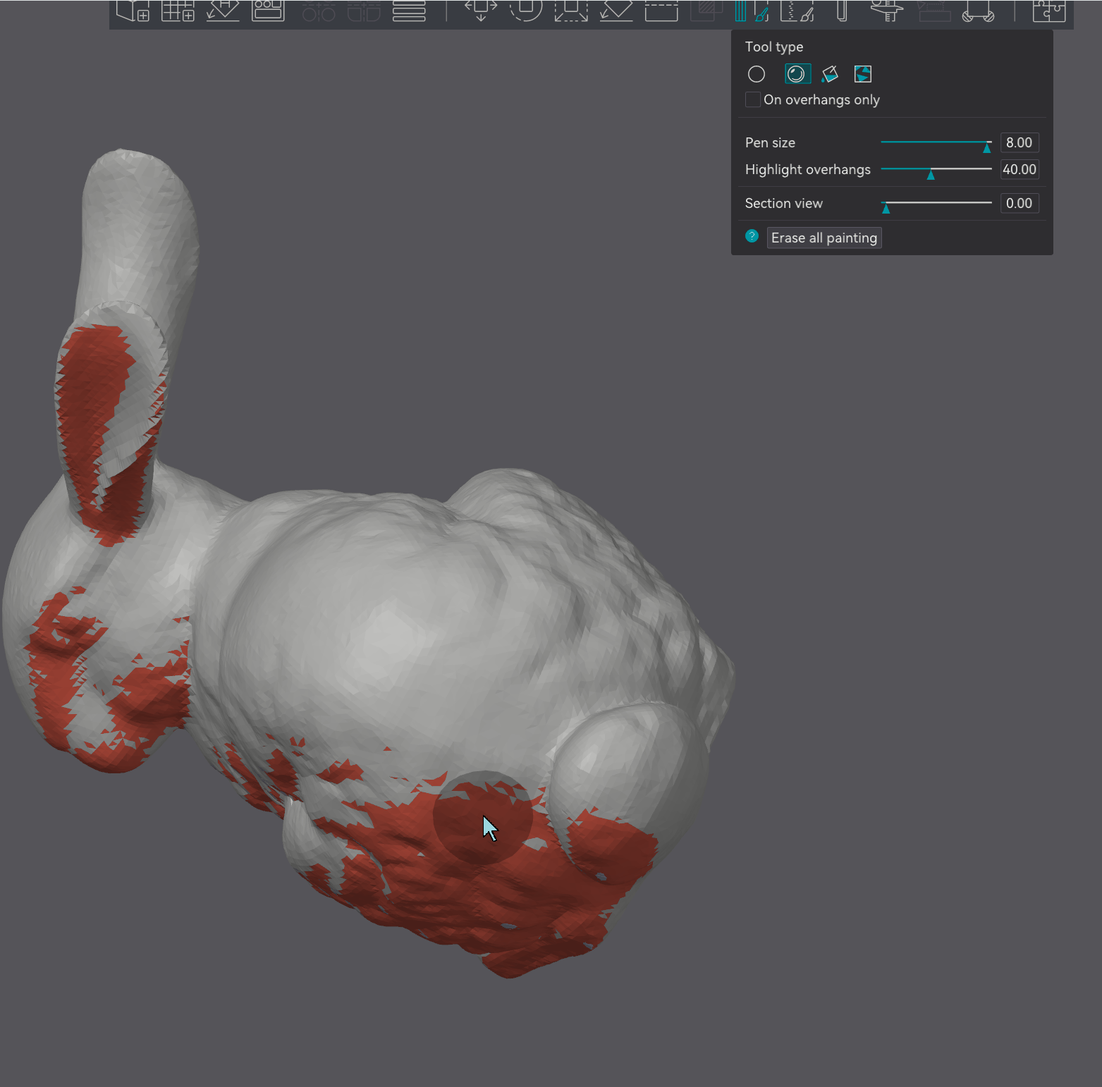

This is the painting for the support:
Option 1
Using paint tree supports and right-clicking to paint support blockers is probably the easiest.

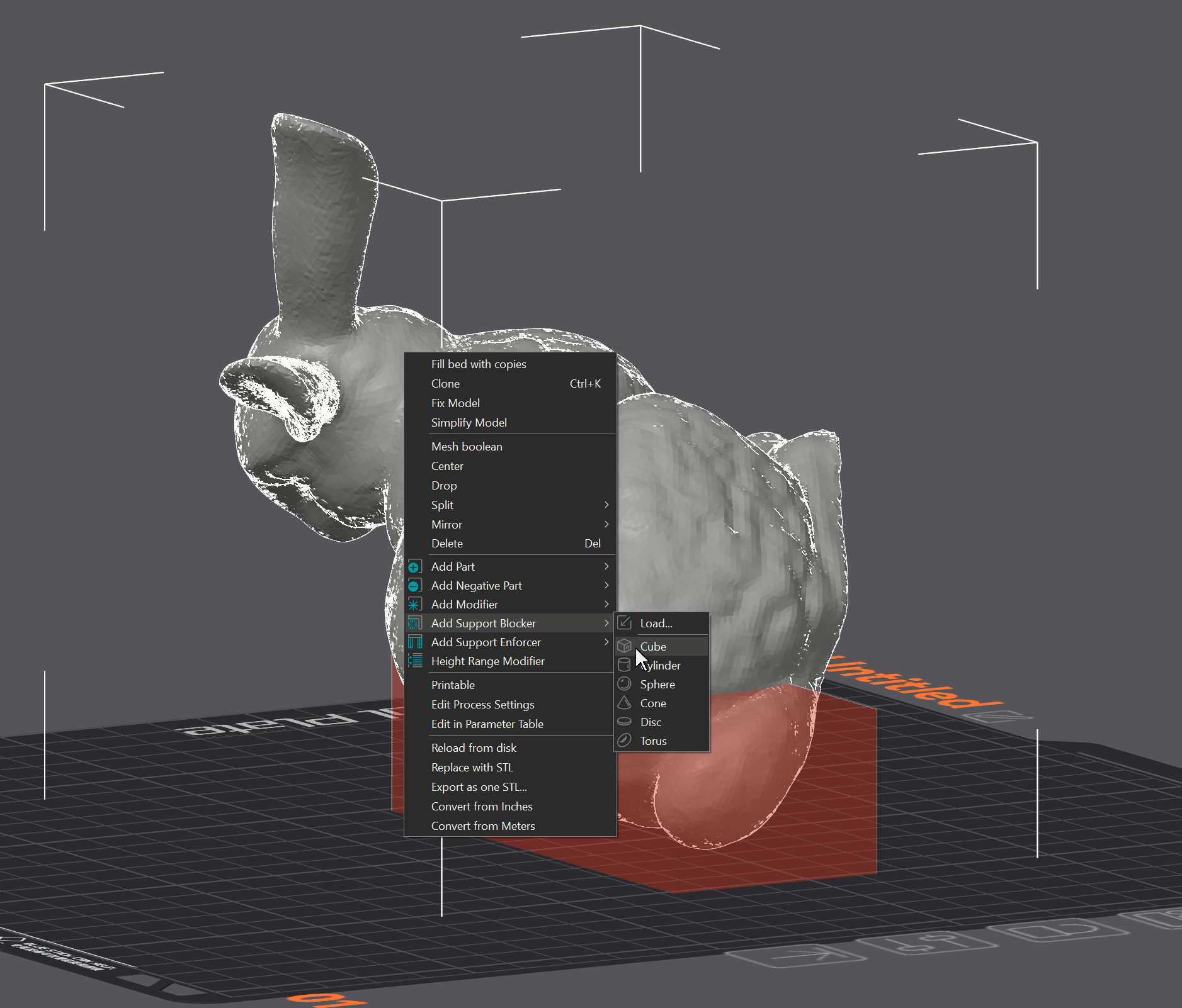

Option 2
Or you can right-click on the model and select support blocker and then resize and position the blocked shape. In this example, I’m using a cube but you can use any shape including a cut down version of the original model.
Raw model with supports.
Add support blocker via right-click
New slice with that region now blocked.

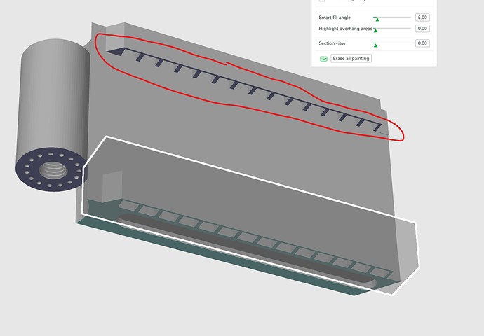

Support blocker doesn’t work as I already said. And for a very obvious reason:
The support are painted here, on a single layer. If you put a blocker under that layer… you ain’t blocking anything.

Those little tags are often vestigial parts of the “first layer expansion” brim-like constructs.
Set that to 0 and see if it gets rid of it. Otherwise you’ll need to paint specific supports and twiddle with the settings as Olias recommended. The support paint tool has a nice “on overhangs only” mode where it’ll only paint on areas >someDegree, which makes it very quick to slap on. The paint tool also can be RIGHT CLICKED to paint a no-support region, instead of using a support blocker cube, which has different behavior in the algorithms.
I tried the first layer expansion thing:
You are supposed to set a support raft, then set the first layer expansion to zero and take off the raft.
Worked in the past but here, unfortunately didn’t work as well. :frowning:
At this point I’ll keep those, doesn’t seem to be a solution in the support’s setting for what I believe it’s a bug, and the alternatives are worse than the problem itself.

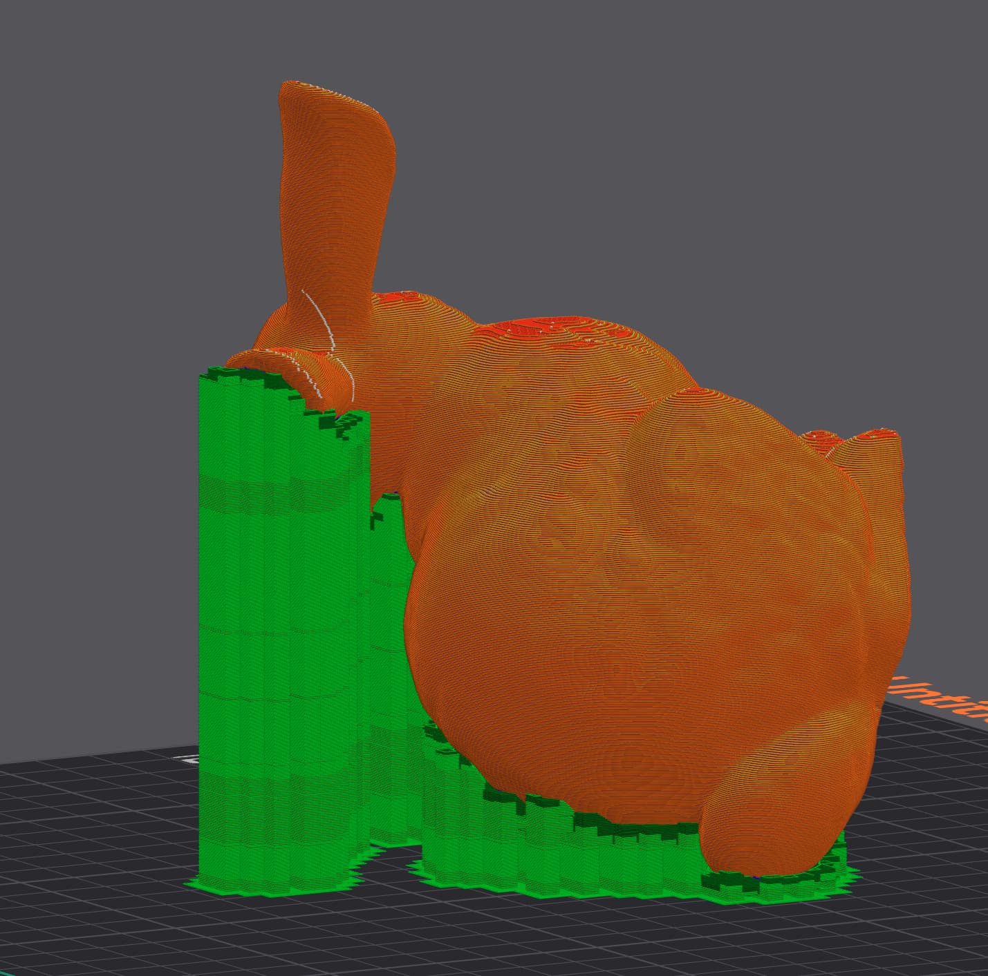

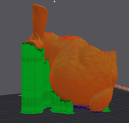

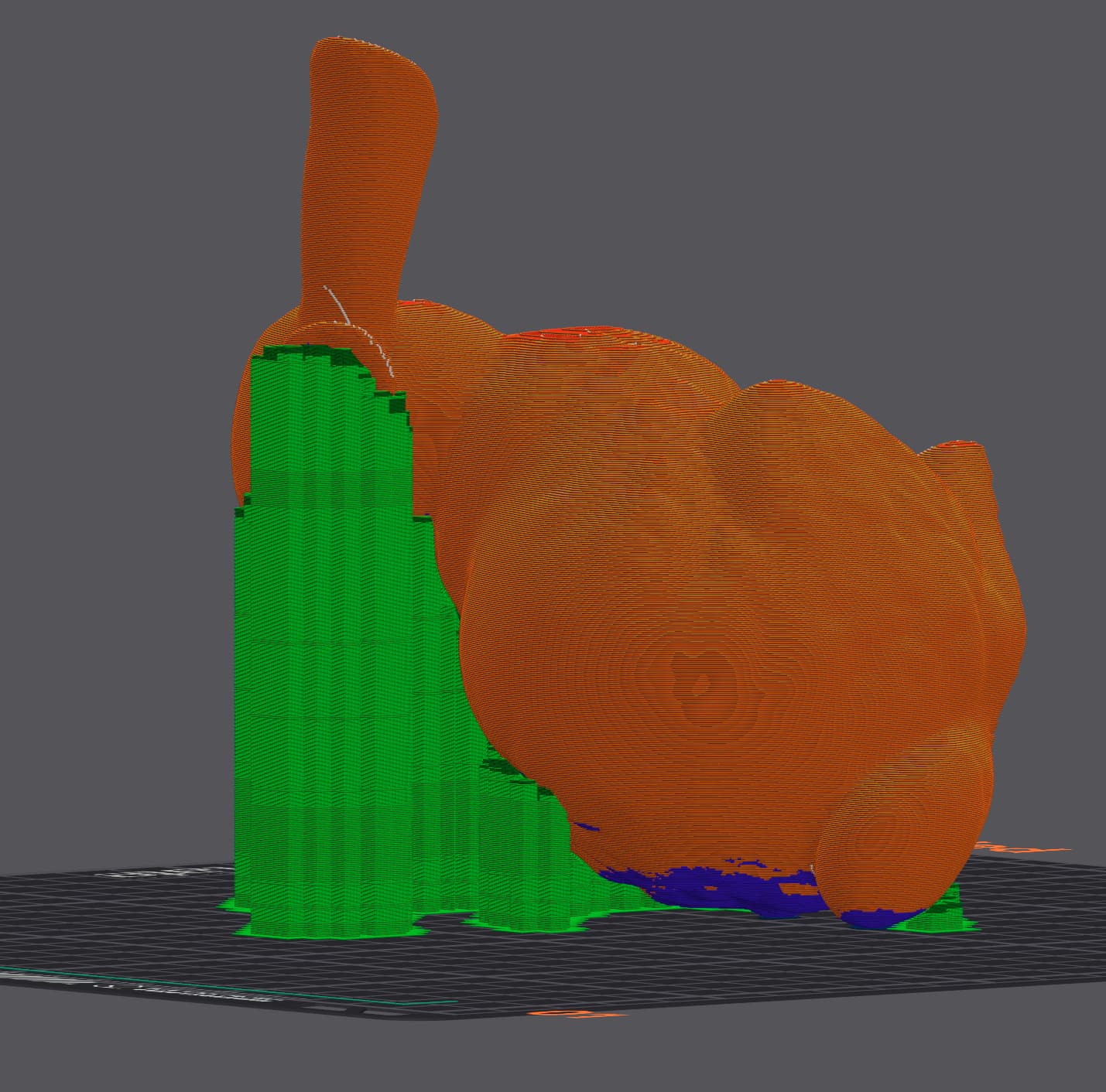

I guess we use a different definition of “efficient”.

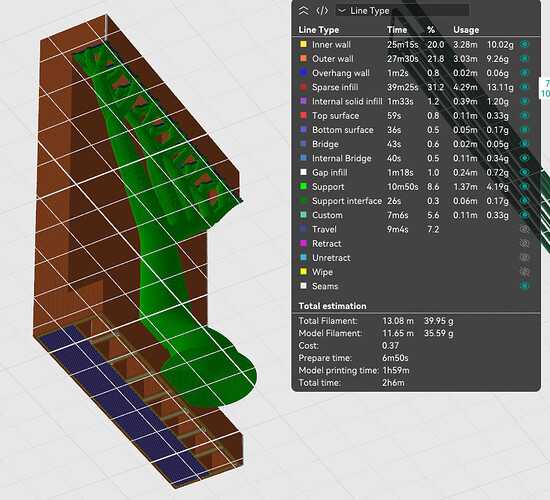

Support+Interface
Weight and Print Time
Normal Snug  4.57g/26:59
Tree Default 5.88g/21:57
Tree Organic 5.88g/19:51
Tree Slim    4.31g/11:09
Tree Strong  6.02g/13:45
Tree Hybrid  4.36g/11:16
Tree(Auto) in all forms requires less time than Normal Snug, uses less material in two.
No need to paint blockers. Easy removal. Interfaces on only one surface, not two, reducing potential scars. No supports in hard-to-reach areas.

This is the problem you asked to have solved. You did not put constraints on the solution at that time. The correct answer would be a scraper. I recommend plastic razor blades.
Instead we suggested several solutions to resolve the stated problem. I suggested Tree supports, which prevent the formation of “these things” in the first place, so there is nothing to remove, while using less material and time. You find trees “inefficient” in some unstated manner, so that made you upset. How are Trees “worse than the problem itself”? This is a forum, we are free to suggest any solution we like. You do not get to dictate the form of those suggestions. If you don’t accept a solution, simply ignore it. If you prefer to get angry, you will find few willing to help you.
We had foolishly thought the goal was to create a print. Now you are changing the problem, “insisting on something that works perfectly”, even when your choice of supports is suboptimal.
I did initially misunderstand the issue, thinking that those bits of support in the hole corners extended up to the first interface layer. Since you did not provide a sample project for us to examine, I drew up and sliced a portion of a similar model. I was surprised to see that Normal/Snug places these tiny support bits only on the first layer, and they should not touch the model with well-calibrated filament. These tiny bits are your problem???
I printed the first few layers with junk filament and found that when removing the model from the plate, most of the holes were clean with most of the bits left on the plate. The few stuck to the model fell off when touched and the rest fell off the plate when it cooled.
I find that increasing Support/object xy distance to 0.60mm or more will prevent these trivial corner pieces from being generated.
That said, these tiny bits do not serve any purpose that I can see and probably are a minor bug. Feel free to submit a bug report to the developers on Github as a New Issue. Bugs reported only in the forum are seldom fixed. The forum is by and for the users, and the developers seldom visit this forum. The users here cannot make the software conform to your ideals of perfection, they can only make suggestions to help you achieve reasonable results with the available tools.
