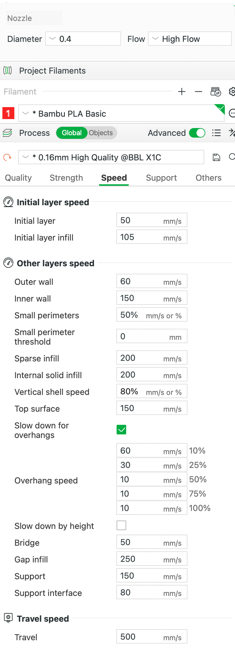

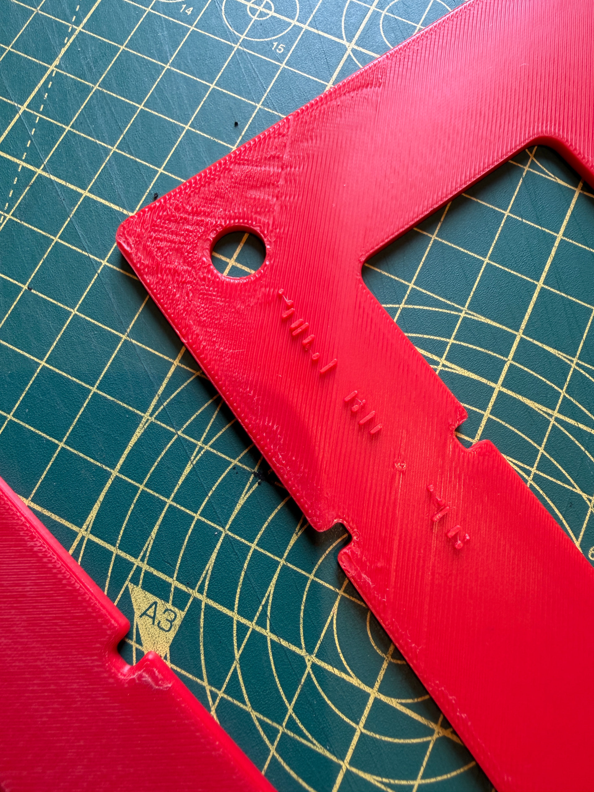

I have a P1S using the E3D Hotend, Bambu Labs PLA, slicer settings attached. I’m having issues on the top surface in the corners, see attached. Text is weird but one thing at a time.
Any thoughts? Many Thanks, Morgan.
The part or the build plate and part are warping up in the corner. This closes the gap between the nozzle and part in that area and the plastic extruded as the nozzle prints isn’t deposited where it should be.
First thing to do is make sure your build plate is super clean using hot water and dish soap.
Hi Jon
Yes I looked at the part and it seems to be a little warped on the edge so I think the plate was not clean there.
Thanks.
SOLVED- Clean your Plate!
Areas thinner than a layer or narrower than a line width will be omitted by the slicer as unprintable. Missing portions of text are often too narrow to print. Try bold text, a larger font, or a smaller nozzle.
