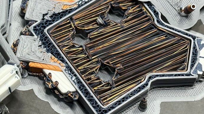

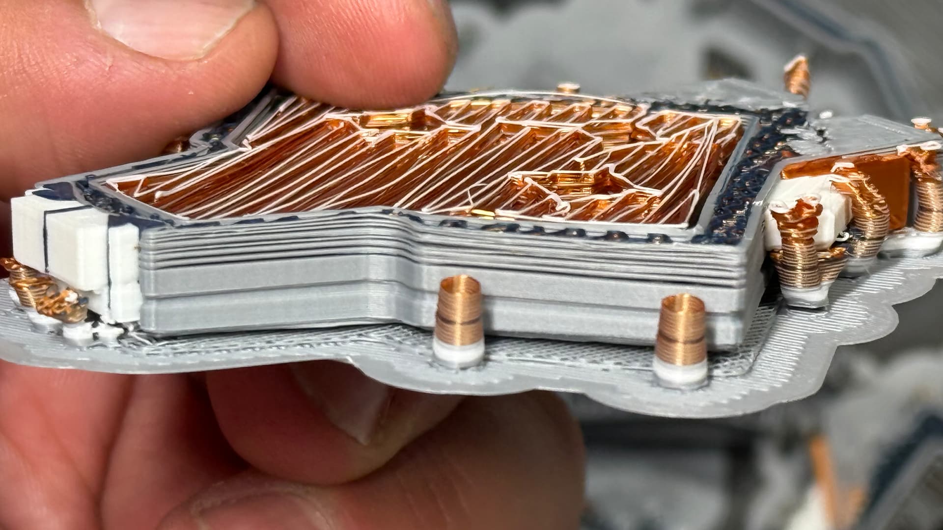

Unexplainable bug in latest firmware ruining dozens of prints
I’ve been printing these 0.2mm plates full of prints for over a year, they are 40+ hour prints with 5 colors of Bambu PLA on 2 AMS with a print that has been tuned extensively for everything on the X1C (I can’t get these to print even close to X1C quality on the H2D disappointingly) so I have to continue to use my garden of 5 X1Cs for this print job. Today all 5 of my X1Cs failed in the same way, and I can’t determine if it’s Bambu Studio or the latest firmware. I originally thought there was some kind of AirPrint/extruder jam situation happening and layers were somehow being missed, but no - it’s some kind of combination of flushing volumes and code being sent wrong somehow. Ive sent 6 different jobs from Bambu Studio trying to fix it, so it’s not just a bad gcode, but a repeating problem:
While watching it print, I noticed the most bizarre never-before-seen behavior on my X1Cs, after loading a new filament color, 0.2mm poops take a long time, several minutes usually, but these poops were quick, and they would end up wiping on the prime tower the ‘old’ color, and then start printing the ‘old’ color on the print, but the print towers would have missing areas on them, causing some printed filament in both the prime tower and print to just sit on top and never adhere properly. this super strange behavior causes all the fails below, I’m almost in tears here, not sure wether to downgrade firmware or bambu studio, or both. The ‘working’ prints unfortunately are no longer in my Print History because I’ve printed so many jobs that they are pushed into oblivion.
Isolate the source of your trouble by changing only one variable at a time. It is easy enough to return to older versions of Studio and firmware. I would probably try an older Studio first, then roll back firmware on one machine if the problem persists.
Old versions of Studio are available at Github:
Scroll down to the last version that worked for your model, then expand the associated “Assets” to download the correct version for your computer.
For a PC, get the portable .zip version, extract all the files to a single folder, then run the bambu-studio.exe in that folder. This lets you have multiple versions of Studio available for testing on a single computer. (I do not know how or if Mac/Linux can have multiple versions.) I only install the .exe version after I know it is working for me.
If using an older slicer does not fix the problem, roll back the firmware on just one machine and try again. You can use Handy to roll back the firmware, or download an older firmware and install it via a µSDcard.
I also recommend running “Restore factory settings” from the printer menu after every firmware change. This seems to clear out memory and prevent weird problems, though it does wipe out filament calibrations stored on the printer. (I don’t do that - I use Orcaslicer and put the calibrations in the filament profile where it is safe.)
To me this issue smells heavily like the (somewhat ) new feature “long retraction when cut”.

OrcaSlicer has a checkbox to enable or disable this feature. I’m on a very old BambuStudio Version, so I can’t check it there. In Orca, you can find it in the filament profiles → tab “settings override” → long retraction when cut (far down). Maybe there is the same option in latest Bambu Studio?

Are you sure the slicer isn’t telling you about this?
Slice model, Preview panel, sort by: Filament
How many filament change times does it say?
How much is in the Flushed column, in grams? Does this seem like the current behavior’s flush amount, or the previous good prints flush amounts?
Prepare panel → filament → flushing volumes
Are these set to 0, or oddly low? If you reset this, then re-slice, does your “flushed” amount change?
Prepare panel → General Process → Multimaterial → Are Flush into objects support/infill checked when you did not expect them to be checked? (your pics look like its flushing into a support in the middle … or it could be an infill area… but without the 3mf i have no idea what your prints supposed to be)

I have e the same bug with my X1E and support is a joke. This isn’t letting my add photos, but it looks similar.
Lost a lot of prints. Some times it prints good then does the stringy thing then will suddenly print fine.
I suspect it has something to do with the lidar calibration data. But I haven’t finished testing.
