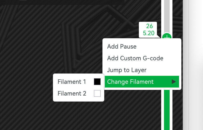

I am using an AMS gen 1, need an additiona slot #5, which I don’t have. So, I have added the pause command at the layer I need to change the filament. I cannot unload using the Handy App or the printers interface. How can I unload/load at pause using an AMS?
After the bew Update, the Pause doesen’t work anymore. You need ro add a filament Chance in the layer Premiere. When you print it, you can klick “multicolour with Extertal” and print. When it reaches the Layer, it automaticly unloads and loads with yout help, like normal.

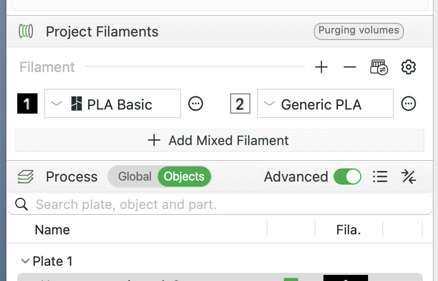

And for those of you struggling (like I was) to understand how to do this …
  • Add another filament using the + sign on the left side panel (the option to switch filaments does not occur unless you have more than one filament listed under ‘Project Filaments’)
  • Then select where you want to change the filament in layer Preview, by right-clicking on the slider and selecting the filament to use.
