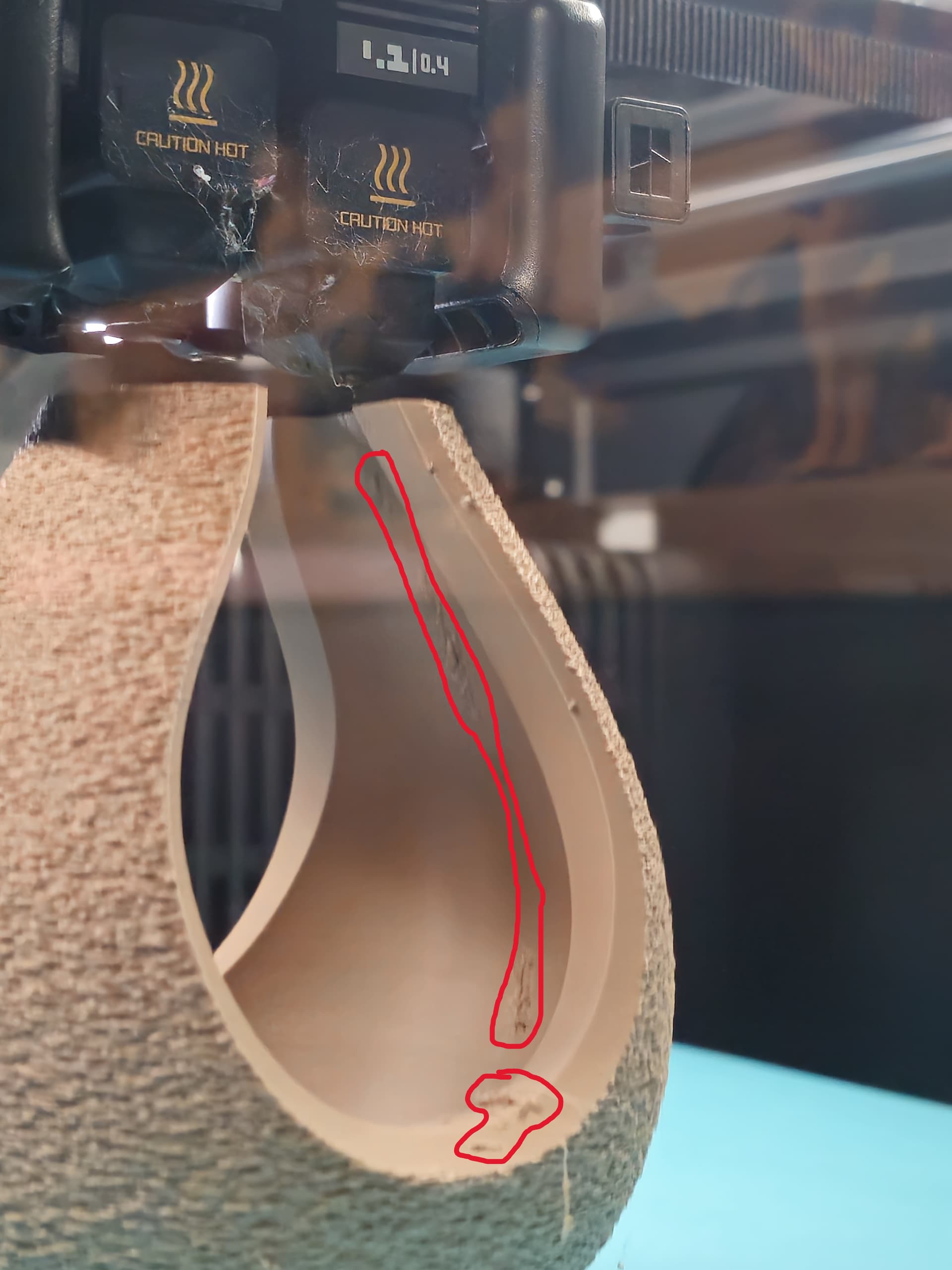

Issue:
Step 3 (extruder moves from park position to the print object) seems unnecessary and causes blobs on the print part, which should actually land on the Purge Tower.
Desired Sequence (What Should Happen):
  1. After a layer finishes printing, the extruder moves to the park position.
  2. A photo is taken.
  3. The extruder moves to the Purge Tower.
  4. The extruder moves back to the print object.
  5. The next layer starts.
  6. The cycle repeats.
Has anyone else experienced this problem? I’ve attached a GIF that shows the incorrect sequence at first half of the GIF.
I’ve also included an image that shows how blobs are forming on the print part, which should be landing on the Purge Tower instead.

It seems like it’s using a pause between layer for this.
And what I noticed is that it parks the tool head. Moves to it’s cleaning position end when resumed, always returns to the exact position where the pause was triggered.
And that is the point on the part.
if your filament is oozing slightly, this will cause these artifacts.
Definitely worthwhile to report it to BambuLabs in a ticket.
But I also see 2 fast solutions:
  • Disable “Smooth mode” timelapse and use the standard mode. Less nice TL’s but better part.
  • Drying your filament more to reduce oozing.

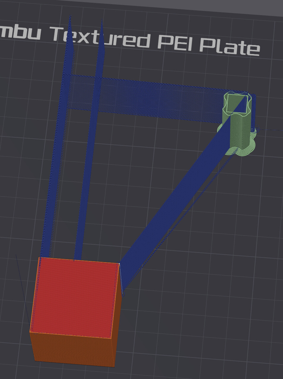

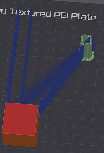

i found the error - but only way to avoid the wrong path after the picture in “Smooth Timelapse” is taken, is to deactivate the function “Avoid crossing Wall”
active “Avoid Crossing Wall" + “Smooth Timelapse” (Error) :nauseated_face:**
inactive “Avoid Crossing Wall” + “Smooth Timelapse”(OK) :wink:
