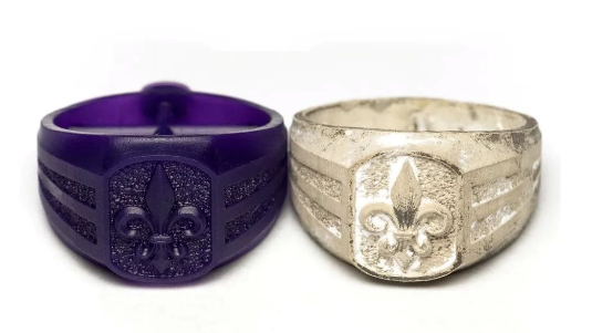

Howdy! First post here. It WILL be a categorically ignorant newbie post, so I hope you’ll bear with me. I have almost no experience with 3d printing, much less printing with PVA, and the bulk of the research I’ve managed to do seems to revolve around this material’s use as a support material, which makes all kinds of sense. However, could it also be used as a print medium by itself, to create models for processes such as ‘lost wax’ casting, where a detailed model is made of wax, then cast in another material such as clay, and then removed with a molten material? Instead of wax, could I use PVA, then surround the model with casting material and use water to remove the PVA before casting?

Of course you can use PVA for whatever you want, but keep in mind: PVA dissolves in water, so if you want to make a mold for clay, the clay can’t be very watery otherwise the mold itself will slowly dissolve before the clay hardens.
In a closed mould design, it’ll be tricky to get a reasonable PVA/water interface to dissolve the PVA in a reasonable time.
In an open mould design (e.g. two halves), you have many more options by, for example, using a PLA print.
However, there are specialist filaments for this or even just PLA…
https://all3dp.com/2/lost-pla-casting-guide/
Don’t. You are just making trouble for yourself with PVA. If you want to try water soluble filaments jump straight to BVOH. But in general, having dissolved lots of both, you are never going to get it to dissolve inside a cast like that.
If you want to try burning it out, there are some filament already designed for this or experiment with natural (un-colored) PVB filaments.
