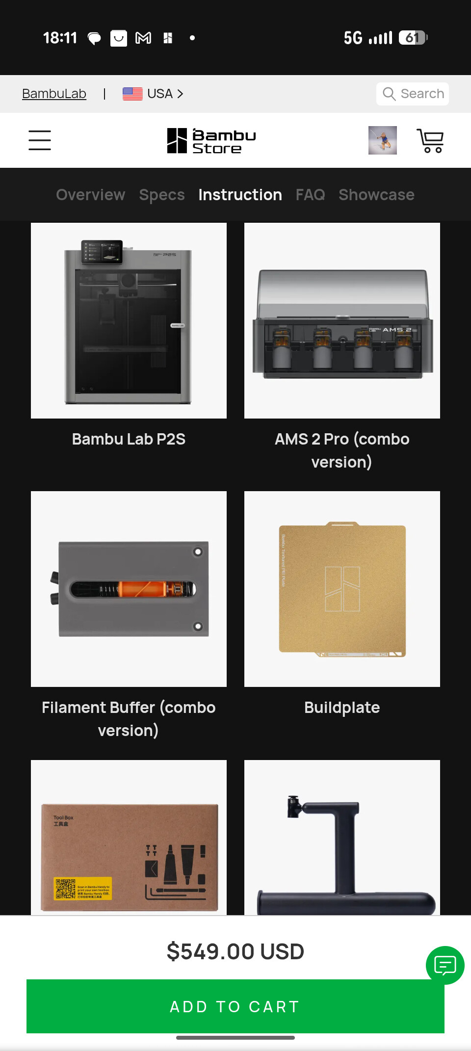

I recently upgraded(today) from a P1S with an AMS 2 Pro to a new P2S, and I’m starting to regret the decision. My plan was to continue using my existing AMS 2 Pro by moving it over to the P2S, but it appears there is no way to connect it. The P2S doesn’t have the required AMS port, and I didn’t see any indication during purchase that AMS support requires buying the bundle version. Before I write this off as a limitation and doom spiral, can someone confirm whether I’m missing something?

It does tell you on the Store website that you need the filament buffer
It does on the computer but not on the mobile version. Even now on the purchase page there is no mention.
This is the only mention at all on the mobile mobile app that would indicate The hub did not come with the non-combo version. As far as I’m concerned, this is ludicrous and unacceptable.

There is indeed no mention about it in the US store if you are visiting it on mobile. In the EU shop it appears also in the mobile version while selecting only the printer and no combo.
