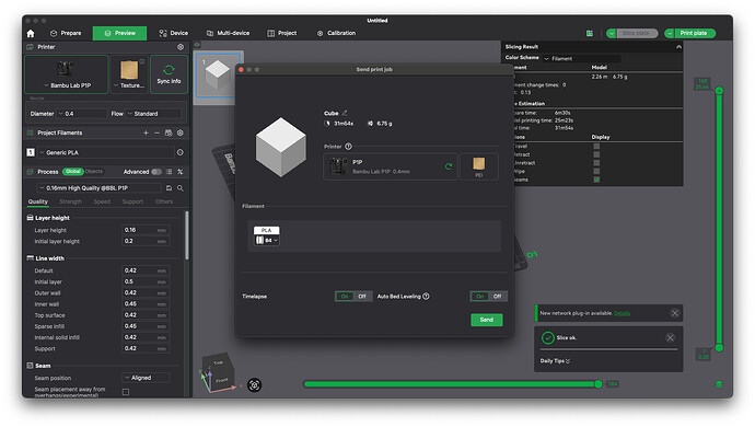

Are there any news here?
Bambu Studio is showing a green Check auf the P1S Printer Profile. But when i try to ru a print from the app, i get the “invompatible printer” error message
Are you sure, that you selected the right print profile?
My P1P is on 1.08.01.00 and with “offical enclosure kit” enabled, I can print from Bambu Studio using P1P and P1S printer profile and also from the Bambu Handy-App using a P1S print profile.

Yes, i downloaded the newest Software and Firmware.
I have a P1P with the official Enclosure. i Selected it on the Printer aswell.
01.09.00.00
Bambu Studio 2.3.1.51
When i Slice my Prints with a P1P-Setting, i get the following Message:
“Please check the following:
The printer type selected when generating the G-code is correct
does not match the currently selected printer. It will
recommended to use the same type of printer for slicing.
Please click “Confirm” if you still want to print”

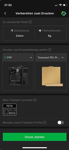

And when i Slice it with P1S selected, send my Print to the SD-Card and start it from the App (i do this a lot) i get the “incorrect Printer”-Error:
“Incomaptible Printer Model”
When i Slice with P1S Setting and print it directly from the Studio, i dont get any Errors.
App-Version is the iOs-App Version 3.9.0
