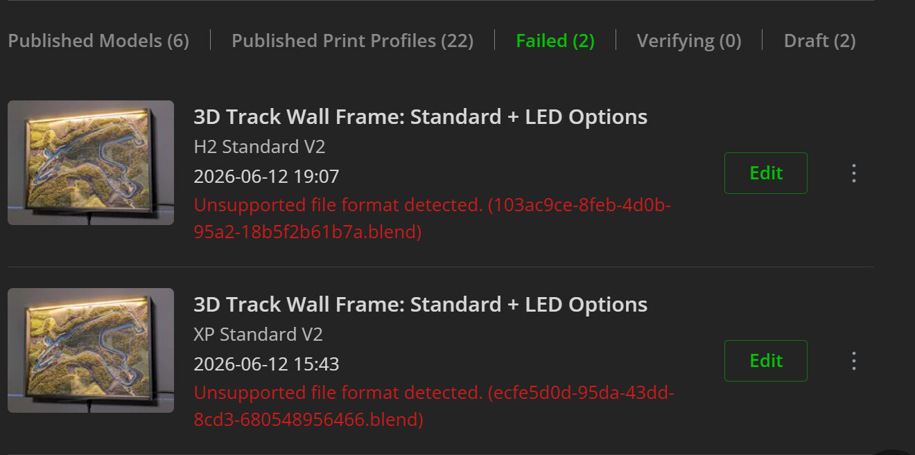

I am receiving a new error:
“Unsupported file format detected.
(103ac9ce-8feb-4d0b-95a2-18b5f2b61b7a.blend)”
A .blend file is obviously a Blender file, but this 3MF does not contain any .blend files. The only possibility I can think of is that some metadata inside the file says the STL originated from Blender, but I have no idea why that should matter. Blender is one of the largest 3D modeling programs in existence. What is the plan here, to ban Blender from being used?

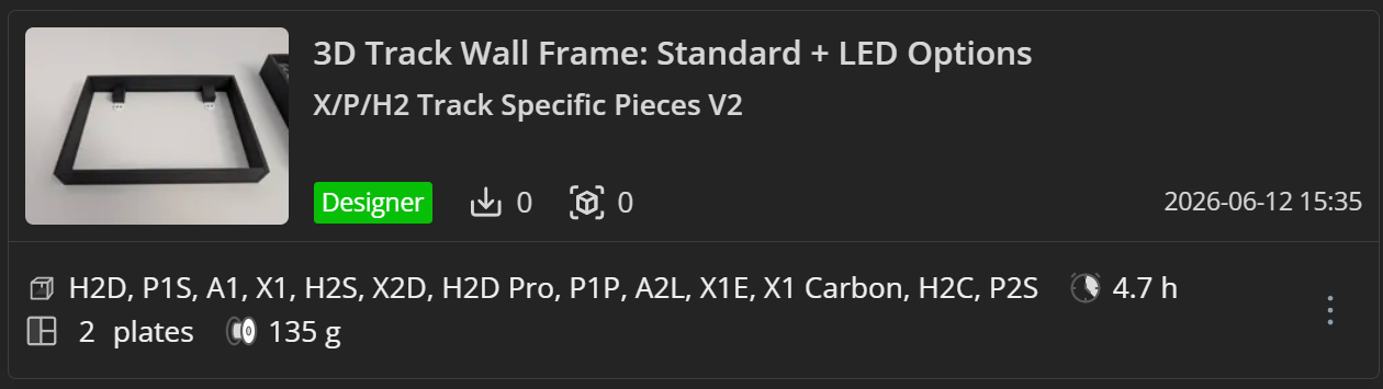

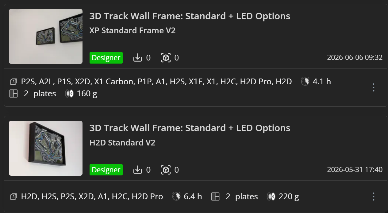

The most frustrating part is that this exact same file uploaded to MakerWorld just two weeks ago. It passed with no issue. I only wanted to separate one of the plates into its own profile, so I deleted the other plate and tried to re-upload it. Suddenly, it fails.
Even more confusing: I took the same original file, saved it as something else, deleted the main plate instead, and uploaded that as a new profile. That one worked fine. So one plate uploads, but the other plate does not, even though both came from the same original file and the same workflow.

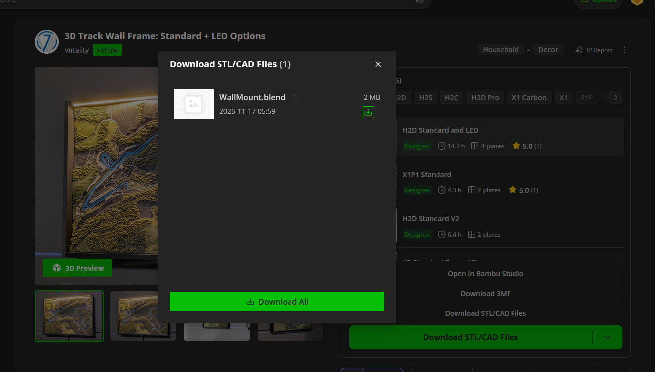

Its because you have a .blend file also uploaded, if you click the “download STL/CAD” its showing a .blend file which was probably added as an additional file when you originally uploaded it
The .blend file shown under “Download STL/CAD Files” is attached to the main model post as the CAD/source file. MakerWorld lists .blend as a supported CAD/source file type, which is why it was accepted there in the first place.
The problem I’m running into is with a print profile. The 3MF files are uploaded through the profiles, while the CAD/source file is tied to the main model post. I am not changing or replacing that main source file.
What makes it more confusing is that I was able to upload a brand-new profile for this same model recently, while another profile/edit fails with this .blend error. If the main post’s .blend file was the actual blocker, I would expect all profile uploads for this model to fail consistently, or for MakerWorld to clearly flag the source file itself.
So while the listing does have a .blend source file, that alone does not explain why one profile works and another fails when the 3MF being uploaded does not contain a .blend file.

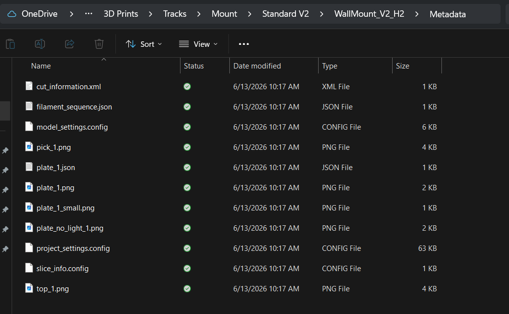

New attempt: I exported all of the parts from Bambu Studio back out as STLs, then imported those STLs into a completely fresh 3MF file and tried uploading again. Same failure.

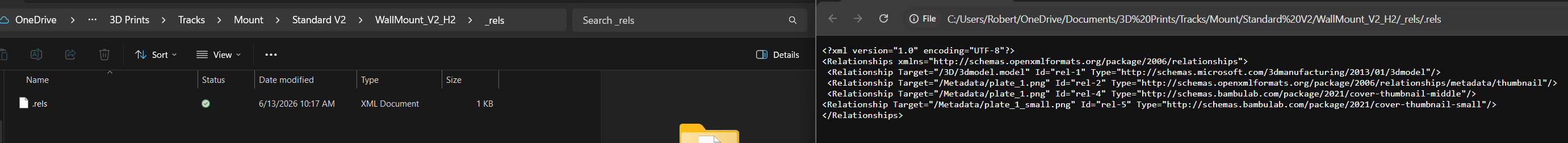

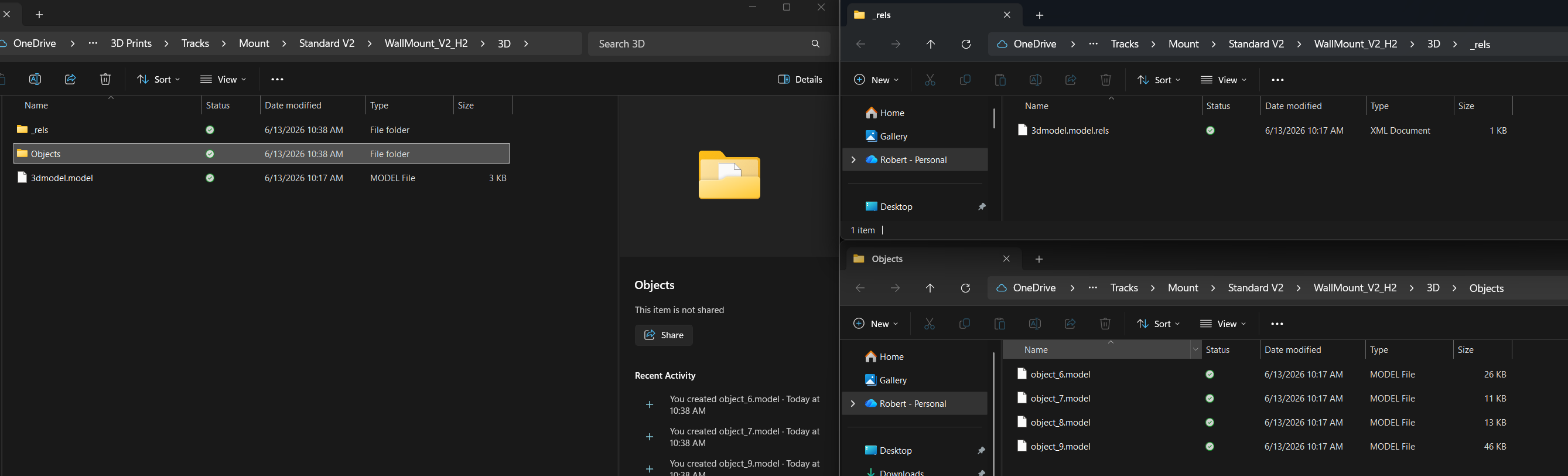

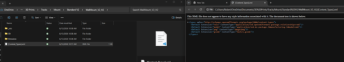

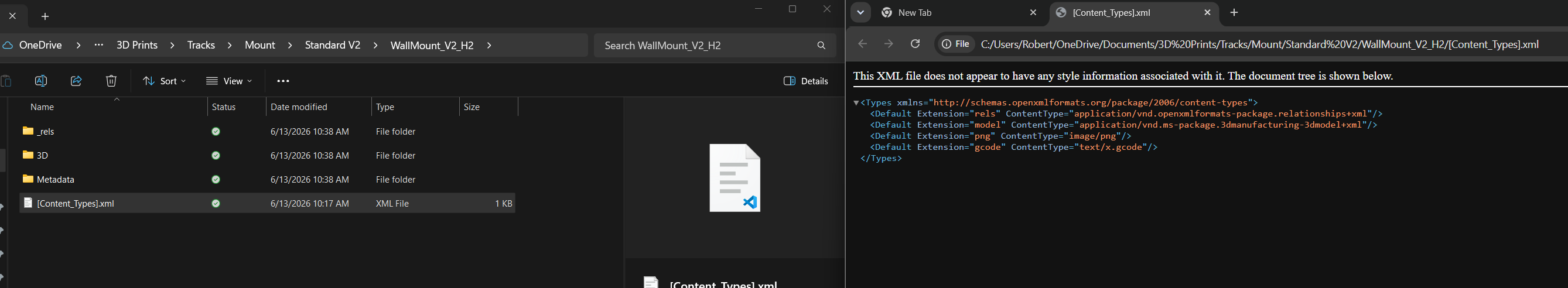

I also unpacked the 3MF as a ZIP and searched both the extracted file names and the contents of the text-based files inside it. There is no .blend file, no .blend reference, no Blender reference, and no matching UUID inside the profile 3MF.
So at this point, the profile 3MF appears clean. The error is still claiming an unsupported .blend file exists, but nothing in the actual uploaded 3MF supports that.
That makes this look much more like a MakerWorld validation bug, cached server-side reference, or some other internal validation issue rather than an actual unsupported file inside the print profile.

A helpful test I just ran was uploading more new profiles using the same file that fails on edit. The new profiles pass the 3MF validation and post successfully. But editing that same profile minutes later, even just changing the title, fails because MakerWorld checks the main post CAD/source file. That should not be happening when the profile 3MF contains no .blend file or .blend reference.

Thing is the profile always includes any source CAD files you uploaded as they have to be available if someone selects the profile and then hits the option to download the CAD files, geometry isn’t supposed to change between profiles so the assumption is the .blend file would still be the same as the model so gets dragged along for the ride
So one of two things has happened, they either no longer actually want .blend files to be included and just haven’t updated the list of allowed files or someone made an edit to the code and removed it from the list of supported file types which is now causing it to fail
