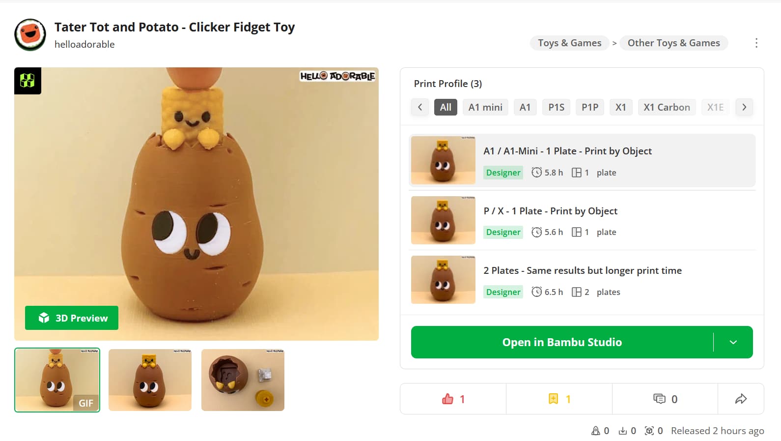

That’s a bummer. I wish there was something Bambu could do about this. Like if their “verification step” could attempt to just virtually auto-arrange the parts for each printer and check if it’s compatible.
For this model I just uploaded, I had to upload 3 versions.
