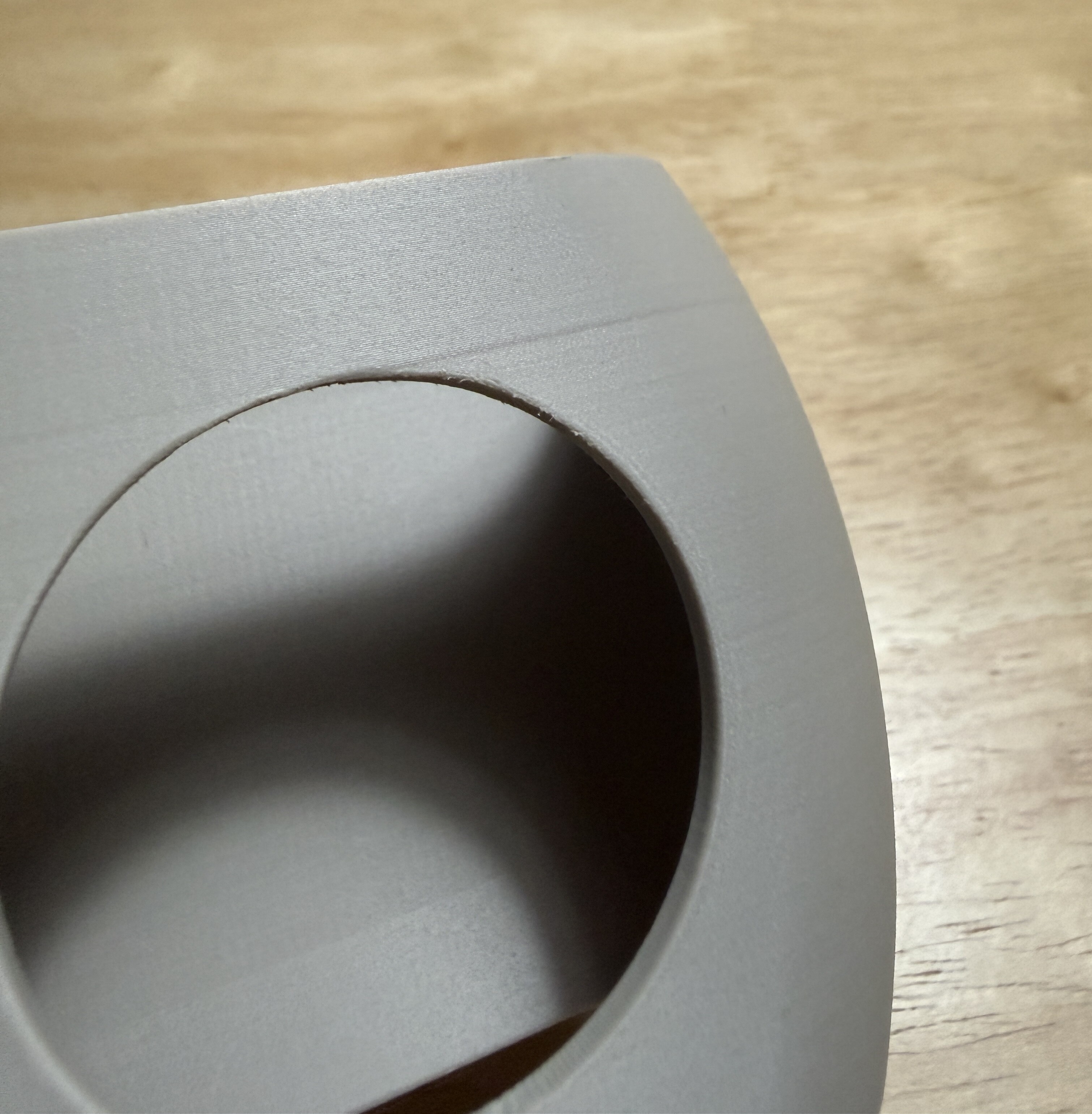

Hi there,
I‘m new here but not so new to 3D printing. But now I’m stumbling across a problem that I can’t solve. I‘m using a P1S with 0.4mm nozzle and want to print a upright hole in a 2,5mm wall. The hole isn‘t the Problem but the Layer at the end of the hole. It produces a Kind of offset to the Layer before
Initially I printed with a calibrated Polyterra muted PLA but it also occurs with other filaments. Speed and flow seems to be uniform and identical to the other layers. Tried a little Bit with speed and the inner/outer option but no success.
Any clues on why that happens? Thinking of more or less time to cool down than the previous layers, but I don‘t have a clue how to adress this.

May I assume that it’s this area in red that you are referring to?

Yes correct, thats the area I’m talking about.

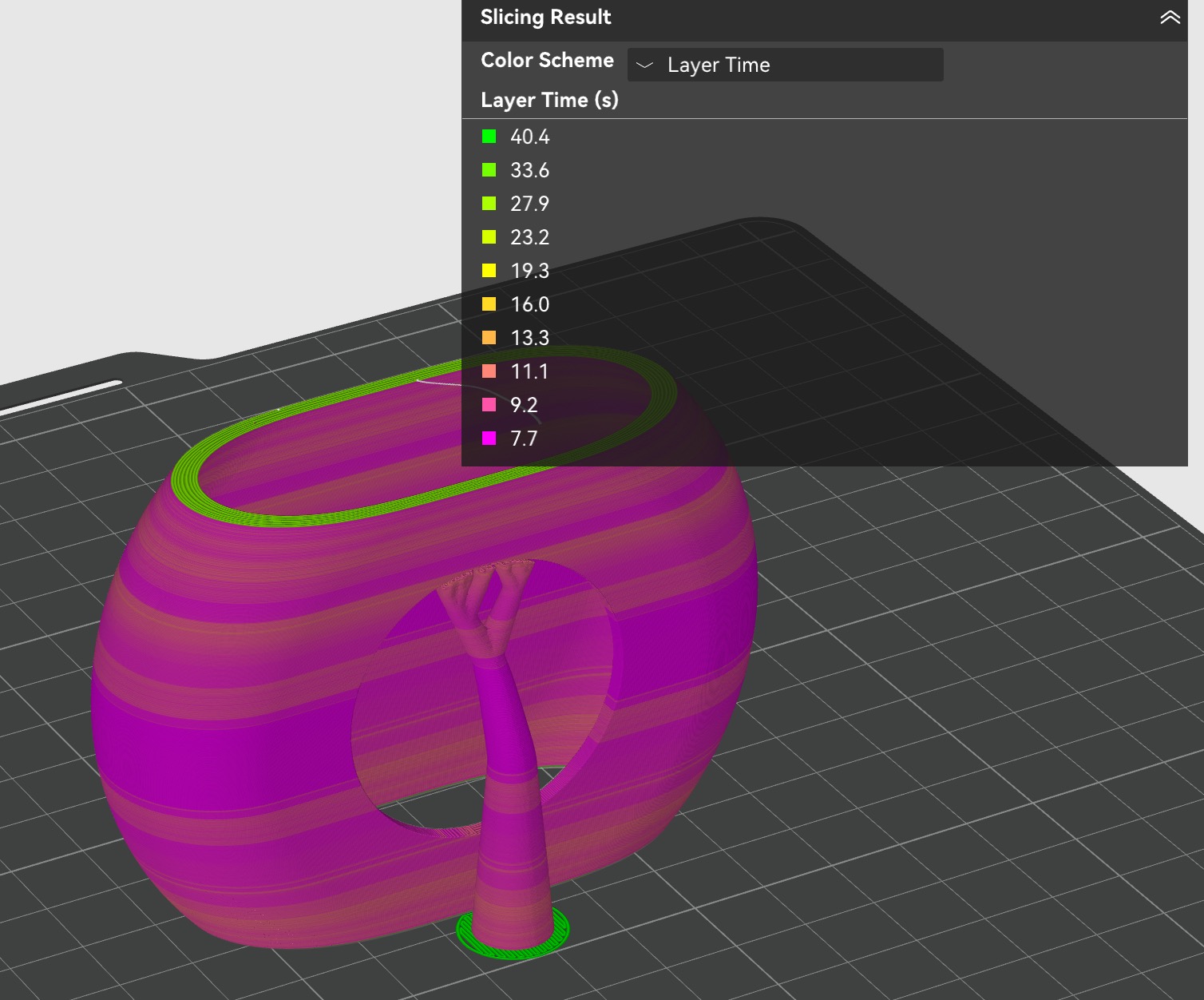

Here the screengrabs of the preview and the cross section of the layer:
I tried that without any improvement unfortunately.
In the preview everything (flow, speed, temperature, fan speed, …) looks homogeneous. The only thing that stands out is Layer Time. But based on the preview, I would expect to see more lines like this than just at the end of the hole.

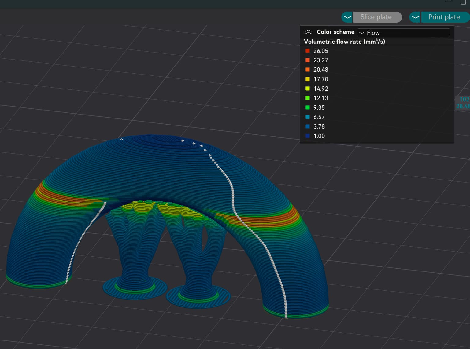

I’ll call your attention to this area of the slice where the support meets the model.
It’s a well understood phenomena that when filament density changes in a geometry, that’s where we see changes in both flow and shrinkage that the slicer does not readily reveal.
Here’s an example using a simple arch where flow rate option is selected in the preview.
Now if I add supports, the picture looks a lot worse.
It’s that change in speed that we see also in a benchy at the deck line which many complain about, that’s one reason the Benchy is so useful.
Now in this example, manual filament tuning fixed the problem but calibration alone is only one tool.
Unfortunately, this is where the science starts to fade and the art of 3D printing takes over. What do I mean by that? Trial and error. :disappointed:
