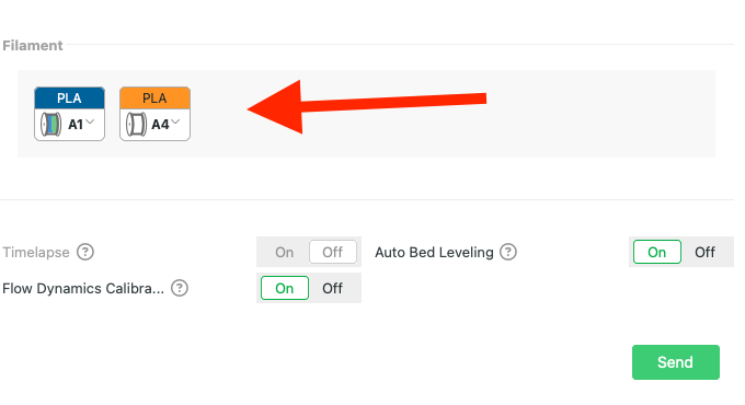

You’re missing the important picture of when you sent the print to the printer. This is where the AMS is matched (and can be adjusted) to what is in the printed file. The location in Studio of each filament doesn’t need to be related to where it is located in the AMS.

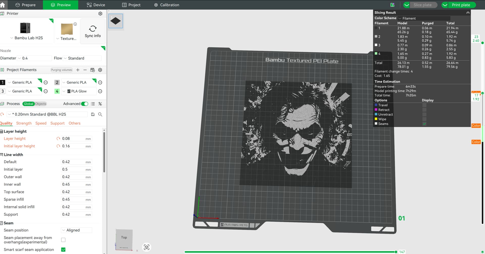

Thanks for the replys guys your all a great help to me although im still struggling to understand how this all works. Apologies about no picture, ive now taken one, it shows ive put the pla glow in but on number to or layer change at 11 it actually chose bank 2 in the ams, I was hoping because the ams didnt have glow connected it would pause n let me change it. This is the print and my poor attempts, and yes Thud that is exactly correct. Ill take a pic of my poor set up in a mo, what im trying to do. Do I set the glow as a external spool in bambu instead of in the ams mayb? Is that possible? Thank you all
I just realised its set as number 4 so if I move it to 2 will it work, stop printing and remove its filament allowing me the time to put the glow in? Thank you
It looks like you have chosen: black, glow green, grey and white by use of the layer bar colour change feature.
You also have these setup in the prepare tab.
Important:
  • You do not have to match the colour order from the prepare tab with the AMS.
  • You put all four colours in your AMS, the slots do nit matter.
  • You MUST tell the AMS what type of material and colour for the three generic filaments as these are not BL filaments, they do not have the RFID tags that automate that process for you.
You set up the AMS filaments in Bambu Studio (or Bambu Handy app) device tab.
  • Select each AMS slot in order that isn’t already correctly matched as glow will be.
  • You do need to correctly assign the type and colour to the AMS slot.
  • You click the swatch for each slot in turn
  • Set the filament type (like you did on the prepare tab)
  • Set the colour, as close as you like (like you did on the prepare tab)
  • Confirm
  • Move to the next swatch until all are correctly set
Now slice the plate by going back to the prepare tab and using the slice button.
Go to print the model, this will display the print window. I gave you a screenshot of this above with the thumbnails. Verify the black matches black and so on.
Then print.
If you do this, it will all work without intervention and you do not need the external spool.

When you are on the print window, the swatches should automatically match what you set in the project. If they don’t, click each one and choose the AMS slot it should use.
