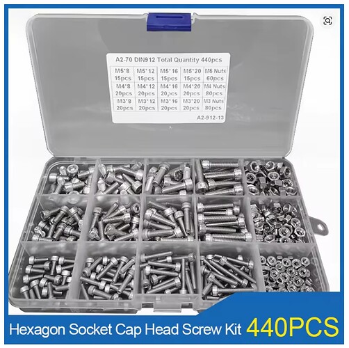

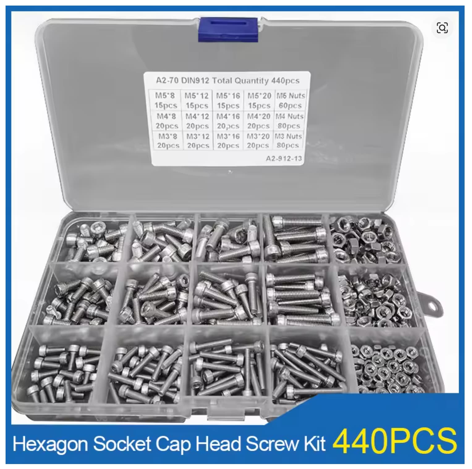

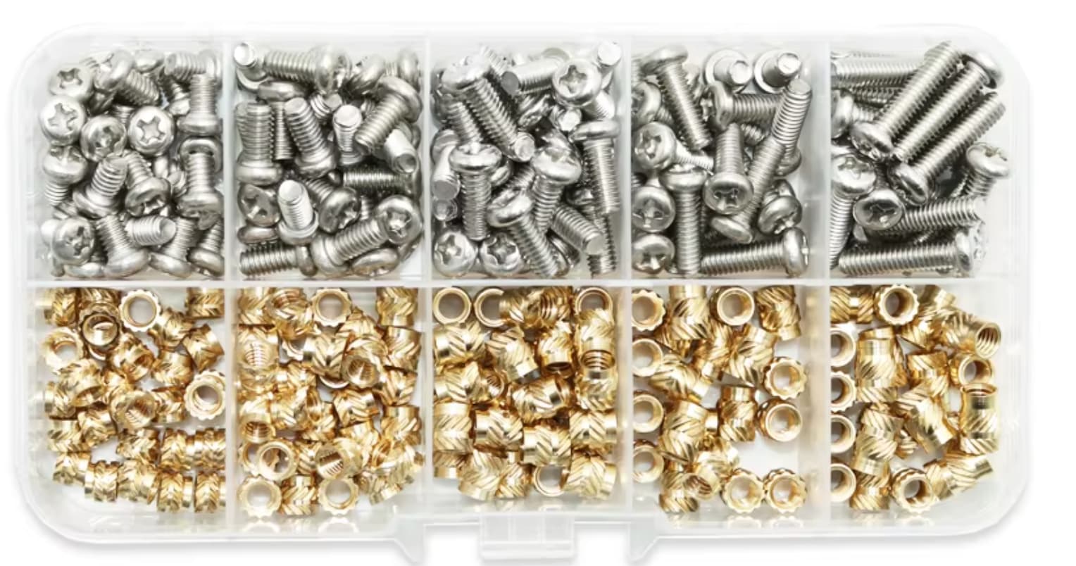

But let’s be honest: if screws are stopping you from printing something, come on, give it a try. You can get a set like this for 5 to 10$. Actually, everyone should have a set of these screws next to their 3D printer. They’re so handy when you need one around the house, too. :+1:
…or alternatively, a set that also includes the thread for 3D printing.

I have the screws, both types, but I don’t think the machine thread screw solution is as robust as the model designer thinks. Like I said, I avoid models that call for machine thread screws where a self-tapping screw would be more appropriate, as for being able to take it apart and put it back together multiple times, if that is what the modeler is aiming for, then it should be designed with threaded inserts.

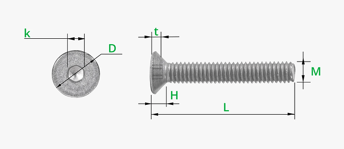

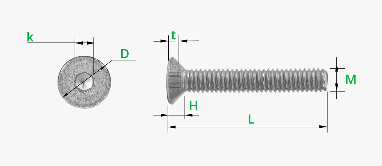

Makerworld offers self-tapping screws, but not always in the lengths and shapes required. Especially with this model, the screws are countersunk, which MakerWorld does not offer as self-tapping to my knowledge. The designer’s vision was that the screws should not stick out, but be flush.
