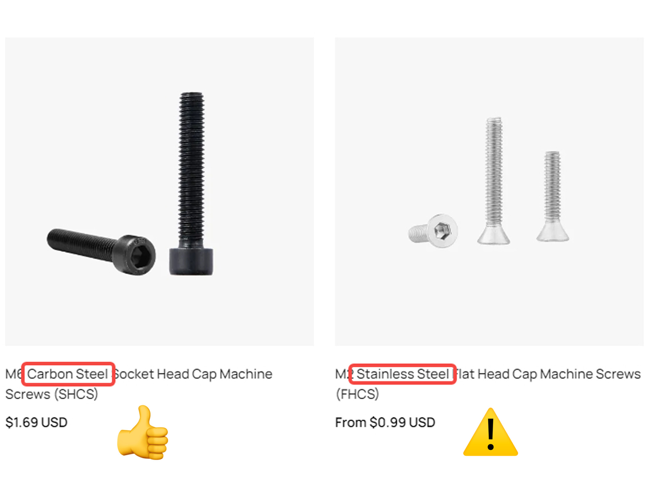

Option 1: Replace One of the Magnets with a Carbon Steel Screw
Magnets attract not only each other but also other steel components. For light-duty applications (e.g., lightweight lids), replace one magnet with a carbon steel screw. This can reduce the costs of a project and also make it impossible for users to reverse the polarity of the magnets during assembly
Stainless steel screws, like those made of 304 or 316 stainless steel, aren’t attracted to magnets, so be sure to double-check the material when purchasing screws! Maker’s Supply offers various sizes of carbon steel screws, which work well with magnets.

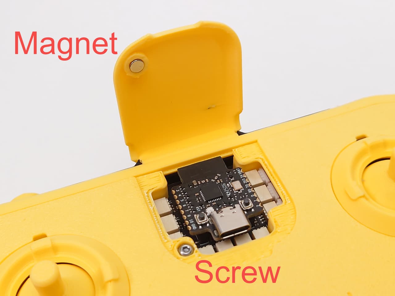

Take the controller of CyberBrick for instance. Its cover relies on magnetism to attach to the main body. Replacing one side with steel carbon screws is a good approach. Place the magnet in the thin cover, and put the screw on the main body side where there’s ample space.
Figure 1: Lid of CyberBrick General Controller, using a fixed screw to avoid polarity issues.

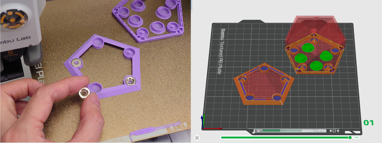

Option 2: Use Disc Countersunk Hole Magnets to Distinguish Magnetic Poles
If the two poles of a magnet have different shapes, it becomes easier to distinguish them. The disc countersunk hole magnet is an example of this.
In the version offered by Maker’s Supply, the larger recessed face is the N-pole, and the smaller flat face is the S-pole. Users can accurately distinguish the poles through these shapes. Furthermore, adding a slight protrusion to the mounting surface can create a foolproof design, effectively preventing installation errors.
Figure 2 : The polarity of the disc countersunk hole magnets from Maker’s Supply

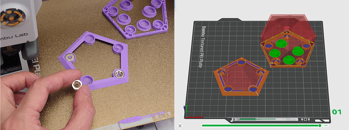

In the D20 Dice Box magnetic[Membership Ver.] designed by Preischl 3D, the sum of the numbers on opposite faces of a D20 dice should be 21. The magnet installation holes, with their alternating magnetic poles, help ensure the lid only closes properly when oriented correctly.
When installing the magnets, place the chamfered side down into the holes with pillars, and the flat side down into the holes without pillars.The bottom of the pillar has a protrusion, so incorrect magnet installation will cause unevenness, alerting users to check the direction.
Figure 3: Determine the installation direction via pillars and chamfers

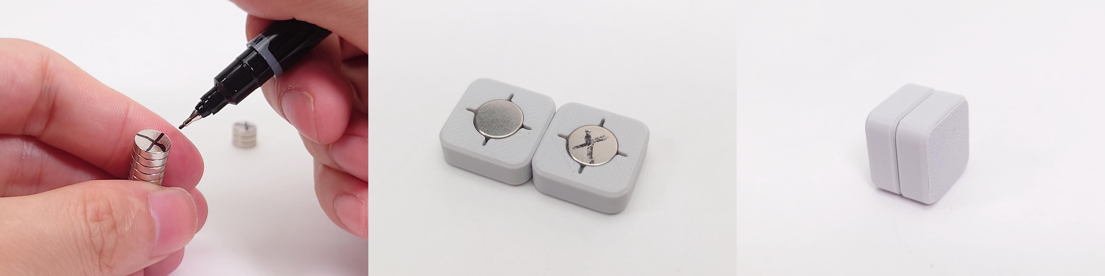

Option 3: Mark the Magnet Surface
Marking the poles of magnets is also a viable method to consider.
Intersect your users to check which faces of their magnets attract each other before installation and mark the poles with pencils, markers, or stickers. These marks can help to avoid mistakes in magnet pole installation.
Figure 4: Use a marker to indicate the magnet pole before installation

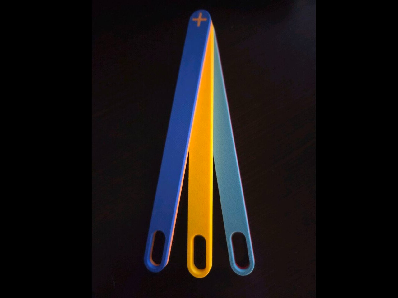

Tips From Users: Use Magnet Insertion Tools
Some talented creators have made a number of magnet installation tools, such as Magnet insertion Fast-Tool by Jorge Rui, Embedded Magnet Dispenser Tool for 3D Prints by Brian Dean and Magnet Insertion Tool v2 by EmGi.
You can use the colors of these tools to distinguish the magnetic poles, preventing installation errors. Additionally, these tools make it easier to grip magnets and provide guidance during installation.

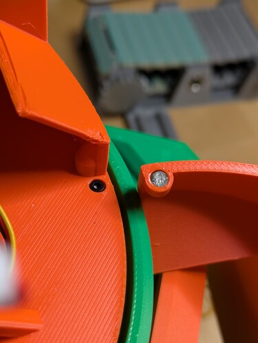

Recently I messed up a part by glueing in a magnet with the wrong orientation. I tested it before glueing but it was a small magnet and I must have flipped it. The tip about using a magnet + a screw was helpful to me - I’m using it in an upcoming design:
For comparing between magnet/magnet and magnet/steel, the force at zero gap will be about the same, but the magnetic attraction drops off roughly twice as fast for attraction to steel as opposed to another magnet.
If using a screw with a recess for a hex key, etc., you will loose a little force due to this, so its not quite an apples-apples comparison.
For sure - it is working well for light-duty applications but won’t always be the right choice.
Yeah, just trying to add some context!
