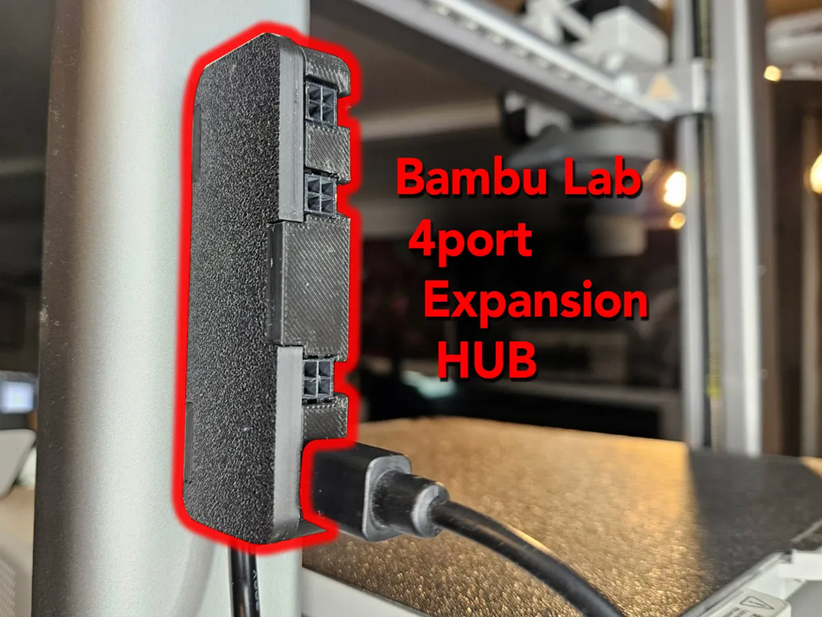

This looks like the most promising path so far.
I had searched for something like this before but couldn’t find anything. After using the exact name from that listing, I managed to find a single seller on a marketplace that ships to Brazil.
I’ve just placed the order and it should arrive in the next few days. Once I have everything set up and tested, I’ll come back here to share the results.
Thanks a lot for the insight — I’m hopeful this will solve the problem!

I actually just ordered the hub that @Arnd mentioned, and I’m hoping that will solve the connectivity issue. My main concern now is power — do you think connecting multiple accessories through the hub could overload the printer’s Bambu Bus port, especially considering everything runs on 24V?

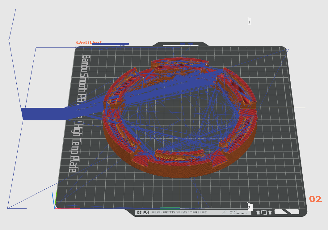

Think about a bed slinger and where the bed is going to be at the end of each layer. Unless you are building something where each layer ends at the same Y point, each image would from a different point, relative to the object. This means that for a conventional timelapse, the bed needs to be at the same Y point and the toolhead is moved to the side. The camera shutter is triggered. After some time the toolhead then moves to the start of the next layer.
Here’s an example with just the part I happened to have in the slicer and enabling showing Travel (blue lines).
Maybe you’re comfortable with that and the quality you are trying to get from your prints. For me, that is a ton of wasted moves, time, and the potential to drop filament where it shouldn’t be, have the layers cool more than I want before the next one gets laid down, and have the extruder do unwanted things due to the delay between layers.
Bought one of this hub and it’s working perfectly. Thank you!
