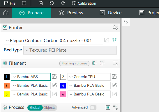

Add 2 filaments here

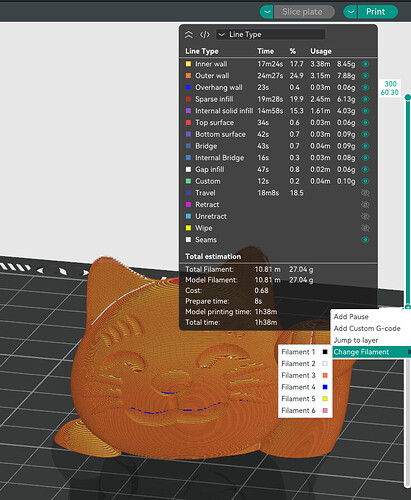

Slice your model

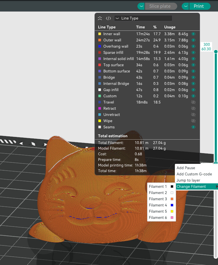

In preview panel, Select your boundary layer, right click the layer height slider, and tell it to change to filament
The various changes in your filament settings will apply (temp, volumetric speed, fan). You mention “speed” and “strength” and if you must alter those slicing parameters, you will need to do so via a modifier cube or something else clever, at the same layer boundary.
