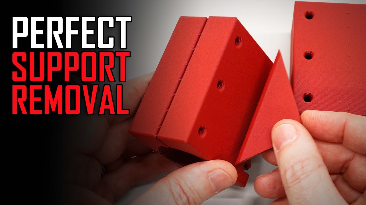

Many ways of doing this. If you create the support as a separate object in your CAD program, then you likely can get trivially easy and nearly invisible removal.
Edit: Here’s one of many approaches. This one from Clough42
Thanks for replying. Great vid by Clough42. Slant 3D did a vid recently where designing a part to be used as a support inside an overhang, inside the part. Purpose was for easy removal with near flawless surface finish. In clough’s example, my experiment would be investigating how wide the narrow section of support would need to be on a bed slinger? In this case, the support gains support from the length of contact the part has with the bed. I might suggest james support could have been narrower if designed narrow“wing” were added perpendicular to the support. Question is, how long the “wing” would be necessary for a particular height? Also, what size bed contact area would be necessary? On james part, additional tree supports were used. As the support needs were generated, a support contact area was formulated considering the height of the needed surface. I’m assuming the tree support design algo is the same for both styles of machines and that it works well due to a low failure rate of printing tree supports which don’t fall over due to bed movement or release from cooling shrinkage during a print.
