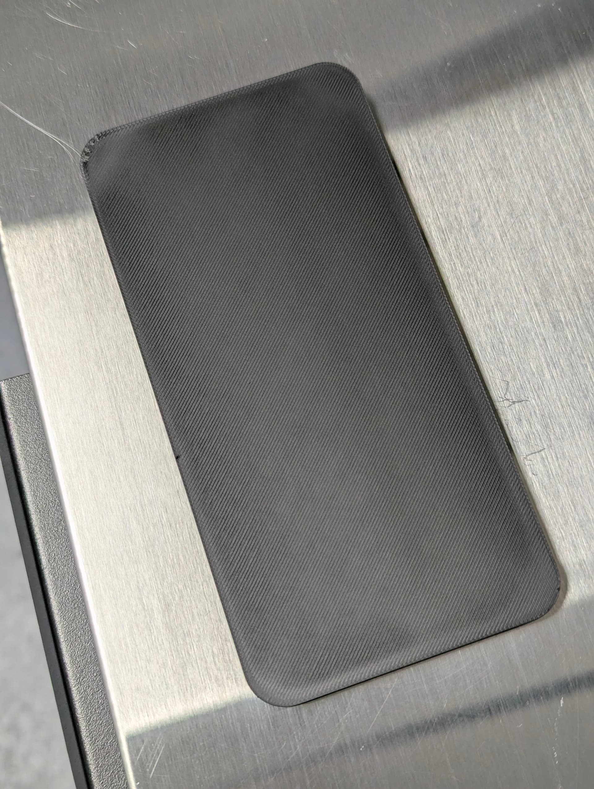

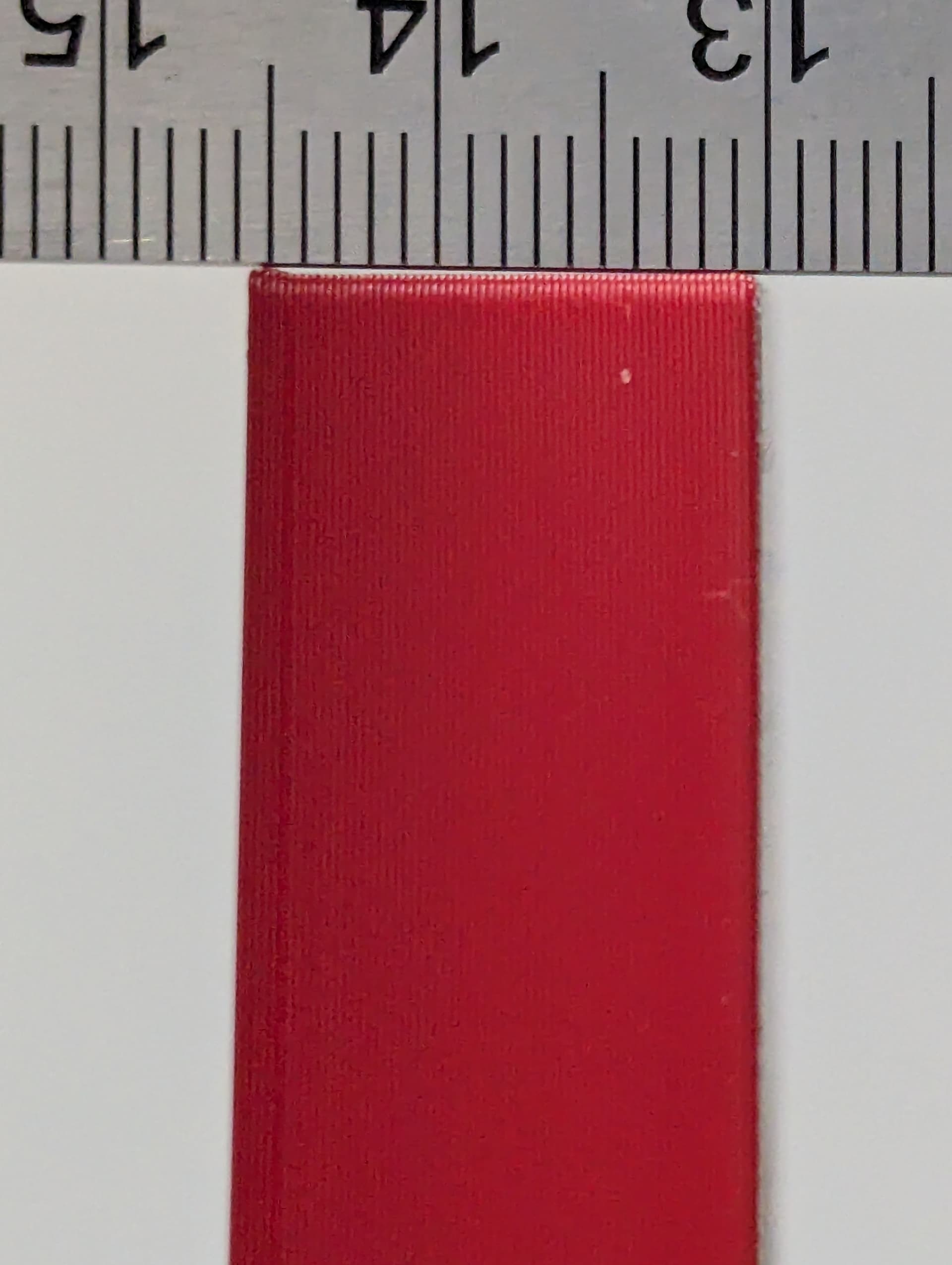

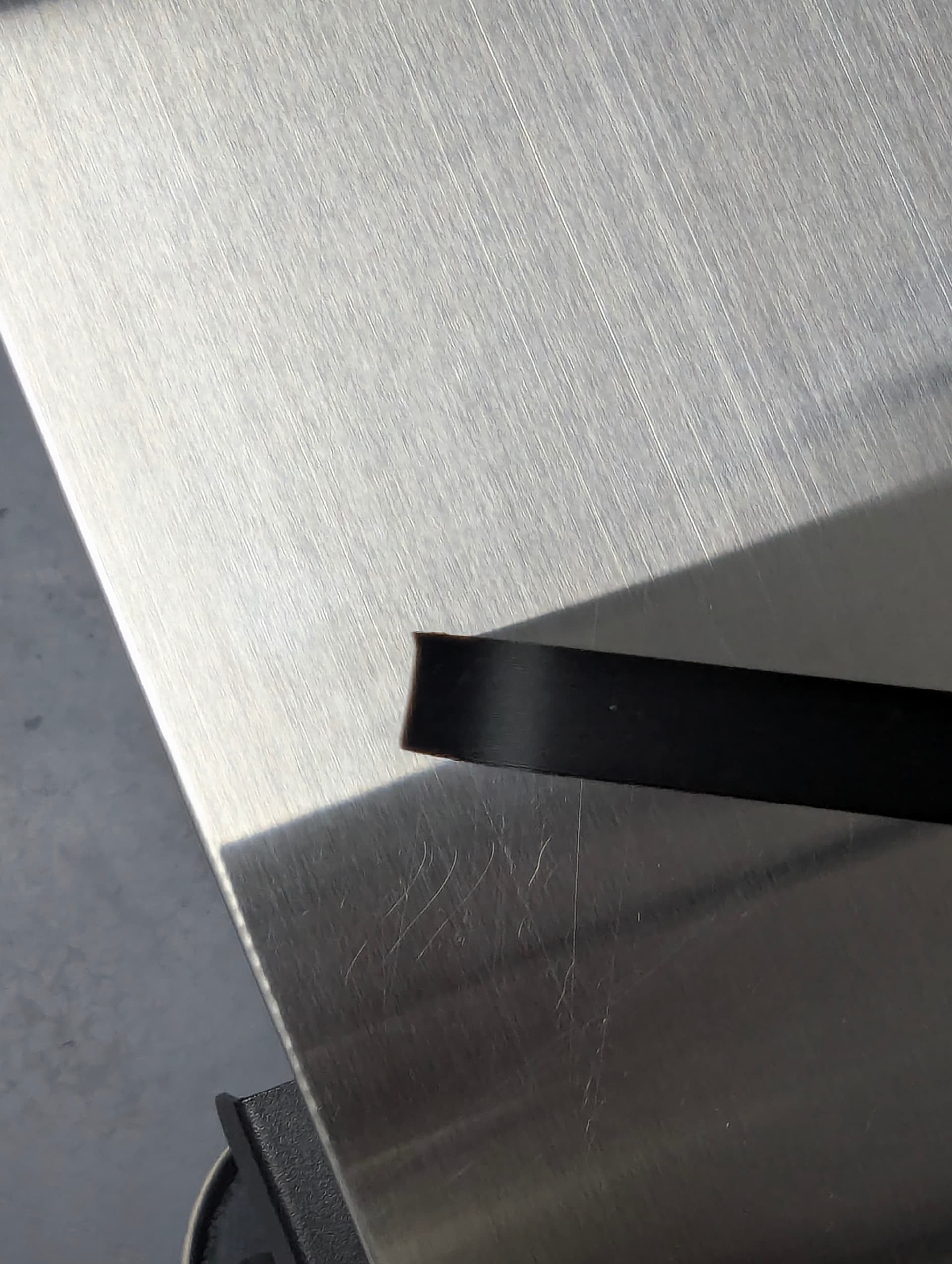

One of the problems I have since the beginning is that they are over extruding at the top layers (is that possible?) It looks like elephant foot but reverse on top. Bambu PLA filaments, stock profile with AUX fan off, no ironing. I have attached a couple of photos to show you.
The other major problem is bed adhesion with PLA (!), mainly on long prints and multiple parts on the bed. I have tried/trying everything with no success…!

Regarding the top layer, my feeling is that it is related to the adhesion problem as the top layers shrink and curl the part up it prints where the outside wall should be and this gives it the “reverse” elephant foot that your seeing. The top roughness is also a sign of the part pulling up.
The center of the part looks like you are slightly over extruding to me, which would also exaggerate the other issues.

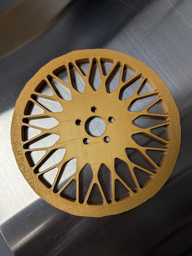

Looks like the gold part looks flat on the bottom. Never seen this one before. I would have guessed it was a profile setting causing it.
I’ll give it a try with completelly stock printing profile, not that I’ve changed anything essential…

The top layers problem remains, but definitely not that much!
This is before washing the bed…
And after…

I tried again the job with the wheel using the default printing/filament profiles… I got better result on the edge around the wheel but not near as perfect (like it’s on the centre)…! Should I open a ticket in Bambu or it’s a waste of time?

Problem solved (fingers crossed again)!!!
Whenever I use PETG as support material and PETG touches the bed (base/interface), Studio turns the bed temperature to 70c… as we know PLA bed temperature is 55c!
As a result PLA expands (?) and I was getting that over-extrusion thing!
