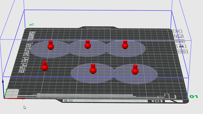

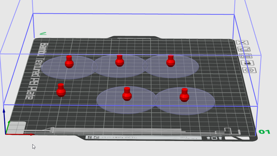

this is a small LED light cover for chiristmas lights. it’s 10 to 15 mm high, and about 10 mm diameter. I ShOULD be able to get many of these on the plate, and still print in VASE mode, PER OBJECT, as they won’t interfere with the nozzle. I have it set to do order of “front row left to right, then back row left to right”. but it only allws me to put about 6 on here. HOW to get this to better calculate this, so i can print PER OBJECT? I’m confused. thanks

I can get 12 without too much trouble, 13 if you you really push the corners.
no need to provide the 3mf, as your other post answered my question. I have to stick wthin the circles, even though that is a small part.
if i did not do it as vase mode, i could fit more, if i did it by layer.
i will experiment more, and in my 3mf file i can arrange it more efficiently, i was just doing a quick test, but the constraint of “having to fit within the circles” is key. Thanks very much for reply ! and have a great day !
