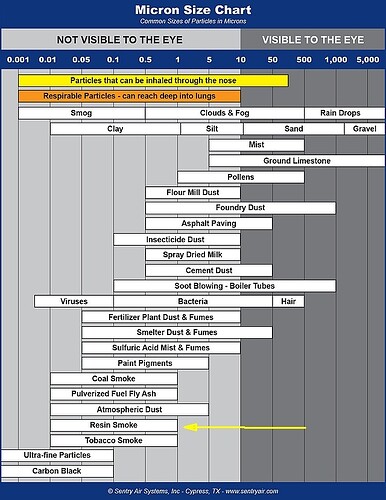

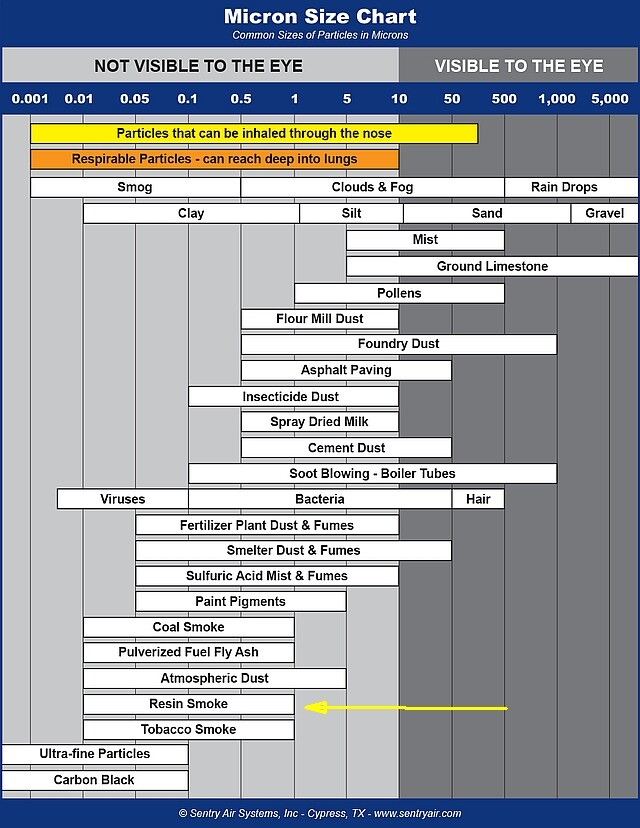

You’ll be hard pressed to find a purifier capable of filtering the resin byproducts from the air. Most high-end air purifiers can only capture down to 0.3 microns. Some will claim down to 0.1 micron but I have doubts on that based on their price. Even so, that’s not enough to extract all the resin byproducts.
Here’s a chart I found to show the particle sizes of various pollutants.
I’m having difficulty imagining what “resin smoke” even is but I am sure FDM printing doesn’t emit any.
Most of that stated particle size that shows down to 0.1 to 0.3 micron is the HEPA filter in the air filter. The activated carbon in the filter is what is going to pull those smaller particles out. So when you’re talking fume generating stuff which are generally particles you cannot see, you need a filter with activated carbon.
