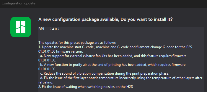

There was an update today. Couldn’t find any additional details about it, but it sounds like it will allow for a venting process after the print is done. That would be ideal for such materials I guess.
That’s only for the P2S. Hopefully we also get that level of fan control for the H2 series printers too.
Yes i would guess so. Something like opening the vents and start the fan after a print finished would be nice.
That is only interesting if you have an exhaust attached.

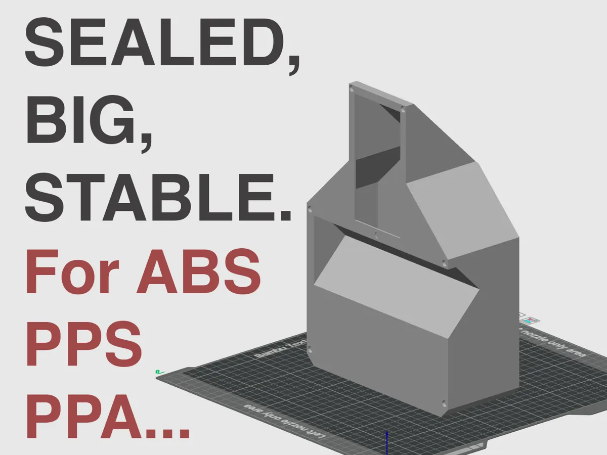

Time to shamelessly advertise my sealed poop box lol
