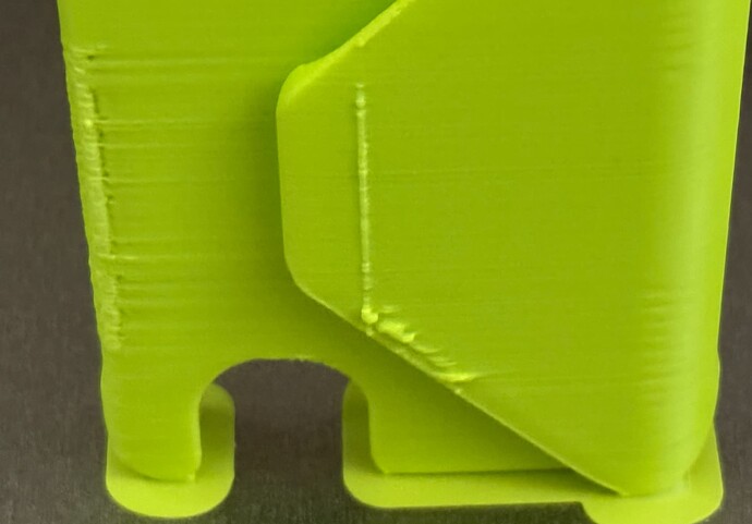

I tried printing this three times on my A1 Mini. First print is on the right second print is in the middle and third on the left. I dried my filament and changed from Sunlu PLA+ 2.0 to Bambu PLA Basic and it keeps happening. I tried a temperature tower and printed it at 210 instead of 220 and got the same issue. Any ideas of what is happening here and how I can fix it would be greatly appreciated. There is a vertical line on the clip section and the back corner with major stringing between them. There is also one around the thumb hole on the opposite side.

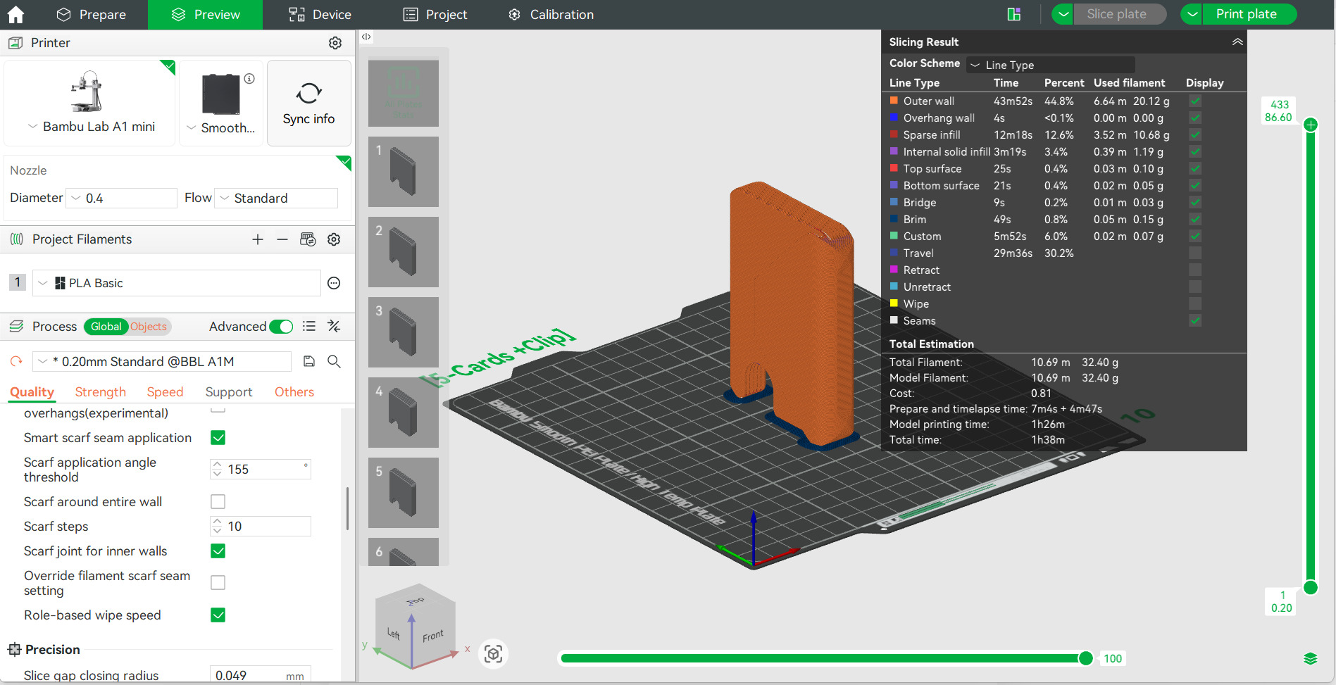

Please provide a screenshot of the Bambu Studio preview tab (sliced) using the line type view.
I wish to see the orientation you printed with any support material and the direction of axis travel.
Make sure we see the whole build plate in the zoomed view and the legend.
Here you go. I took one with Outer Walls and Sparse Infill turned off as well so you can see the seam location easier.
Why is it upside down?
Surely the best way up would be the other end on the build plate. It would have the best adhesion.
Given the A1 mini is a bed slinger (I love mine), ideally, you reduce the unnecessary movement.
If you rotated 90° so the whole bed isn’t moving as much. This will greatly reduce the potential for wobble. Combined with the upside down orientation, much of the movement will go away.
45° would also be good as it splits the difference.
It is likely the movement causing the issue as models that are tall and thin need consideration when on a bed slinger.

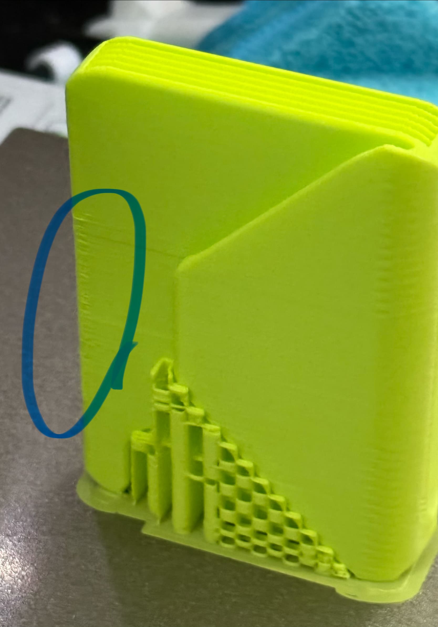

Here are the photos for you to see.
The first attempt printing as the designer intended failed.
I am trying again after adding support to the clip.
The version oriented by the designer with additional support I added has printed.
It printed this time.
However, the quality is poor.

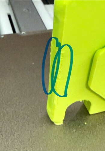

I am printing the same version without the clip, which seems likely to be the factor causing the imperfections based on their locations.
It is identical to the one in the profile with no changes or support added by me.
If this is smooth, it is the clip causing the issue. If it is smooth, I will print the clip version on one of my P1S printers.
The test print without the clip on the A1 based entirely on the designers profile worked without issue.
As I suspected, it is the clip causing the issue. Likely, the extra travel combined with the retractions from a mostly unsupported area so close to one that is.

I have printed the 5 plus clip model using the A1 Mini profile version with no changes other than the printer.
It printed well, but still had issues halfway up, nothing like it did on the A1 Mini though.
This confirms what I was thinking. I will likely just go with a version without the clip as it seems like that is what is causing the issues. I tested my cards on one of the failed prints and they should fit fine. Thanks for all your help on this!
