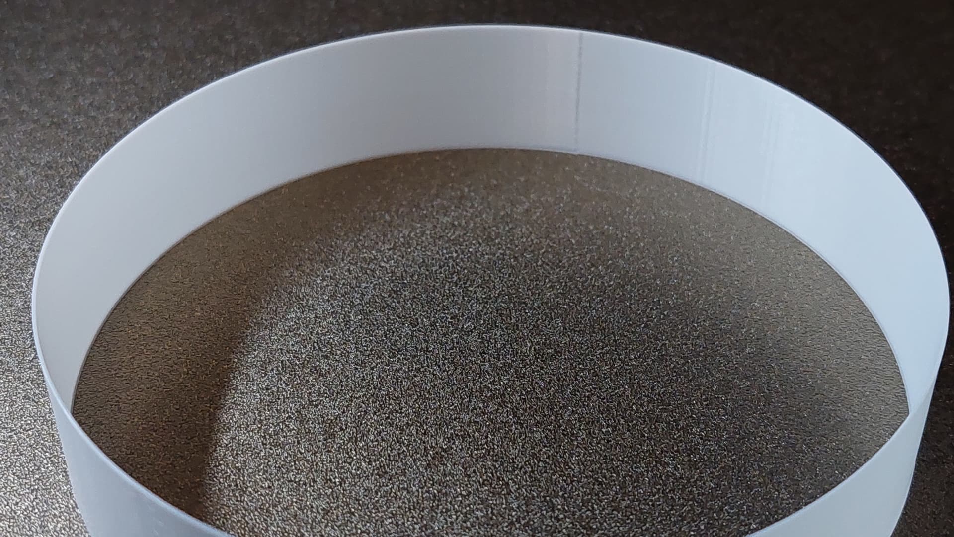

I need your help on this. I’m trying to print a led cover / diffuser in PETG translucent clear and after 10-15 tests, I still cannot get rid of the vertical lines. I don’t think it is VFA since I print very slowly.
Here is what I’m talking about:
You can see them a bit on the left and right and those lines show when light is diffused. Is it a limitation of the printer (the stepper motor?) I did all the calibration, check the belt tensions and alignment (I even tried different tensions).

Did you import the object as an stl or use a built in primitive?
I have found a 3mf export from CAD and subsequent import to give the best results.
If it is VFA, you are likely to see a variation of the pattern around the cylinder. If not, it is likely a geometry export/import artifact.

There’s another simple check you can do on the prior print. If the ripples have a pitch of 2mm, it is possible that they are VFA artifacts and therefore due to the printer.
If the pitch is different (it looks smaller to me in the pic), it is likely the model geometry so that a 3mf CAD export can help.
PETG has its own tricks and translucent again a few more. PETG rewards printing slower and using the Generic PETG cooling settings. It also needs to be well dried.
PETG Transparent shows VFA’s better than most other materials and there are special settings for best translucency. But first, it would be good to get a good geometry print to see if you want that or if you want to go for a more opaque diffusor.

I did 2 prints in PLA Basic white: Both a single wall loop, no top or bottom layers, no infill
A) Arc fitting enabled, spiral mode
B) Arc fitting disabled, normal mode, scarf seam
Both show VFA’s (2mm pitch) too fine to properly photograph but are good otherwise.
I have the same 2mm a lot more visible on transparent filament, I also tried in grey pla, they are also there but almost not visible, I guess the PETG transparent amplify the issue. I don’t know if the 2mm lines are coming from the belt teeth or the 1.8deg stepper motor.
VFA’s are usually associated with the toothed belt.
Unfortunately there are no easy fixes other than tuning speed to VFA’s.
The Bambu Lab Customer Support ran the same print on the H2D and the result was the same. Good to know
I was able to reduce by a lot the vertical line when printing at 20mm/s. but when I tried at 0.08mm layer height I did get those lines and it was very narrow. I think it would be related to the extruder this time. Because when I try 0.16mm layer height, it is fine. The next thing to try is 0.08 again but with a higher line width like 0.6mm, otherwise I don’t have other hotend to try
