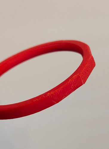

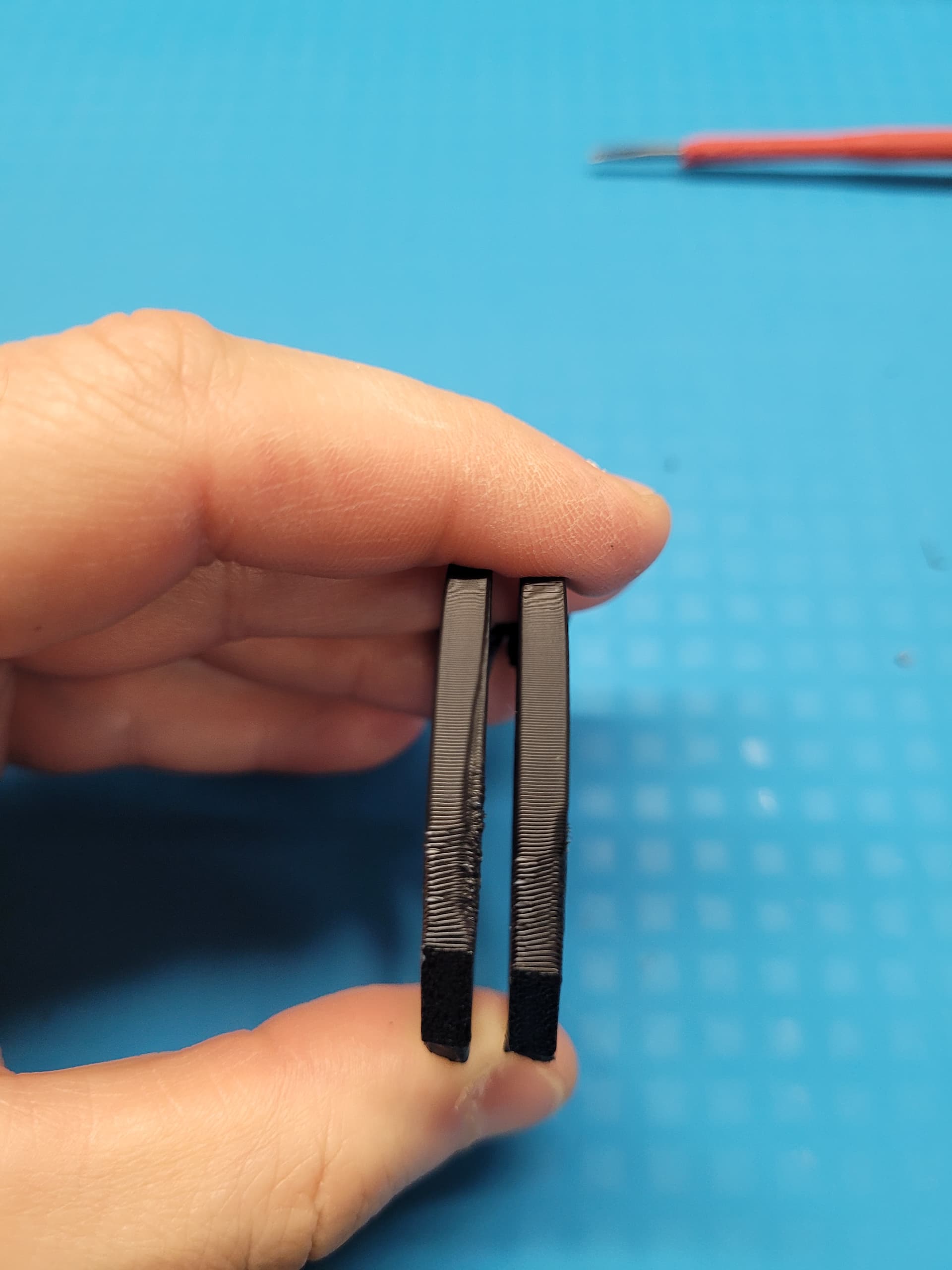

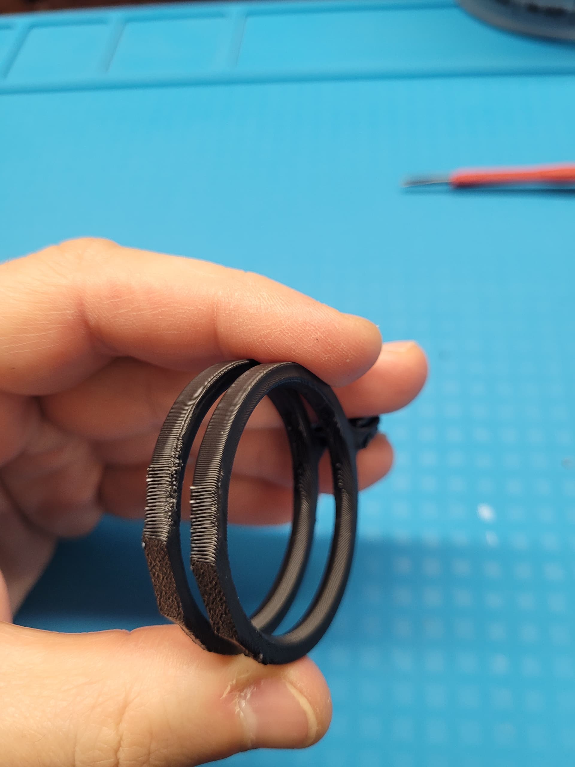

Hello,
I have my P1S several months now and already printed some rolls of different filaments with it.

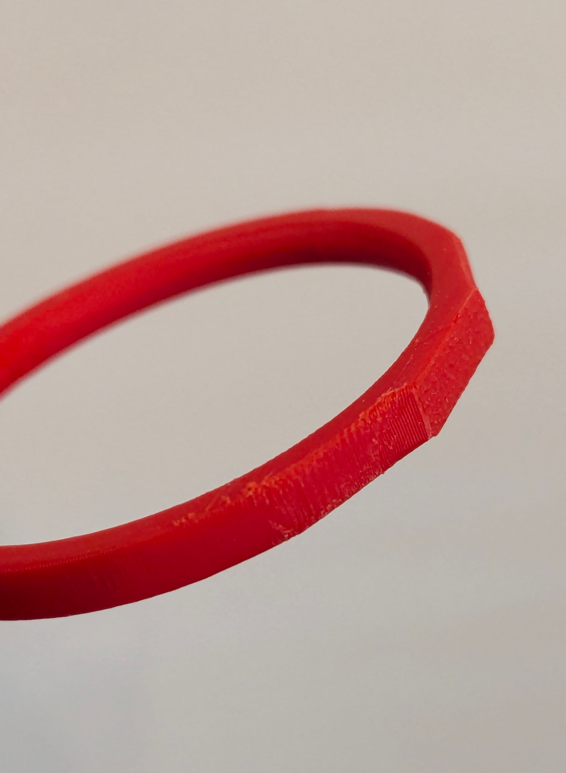

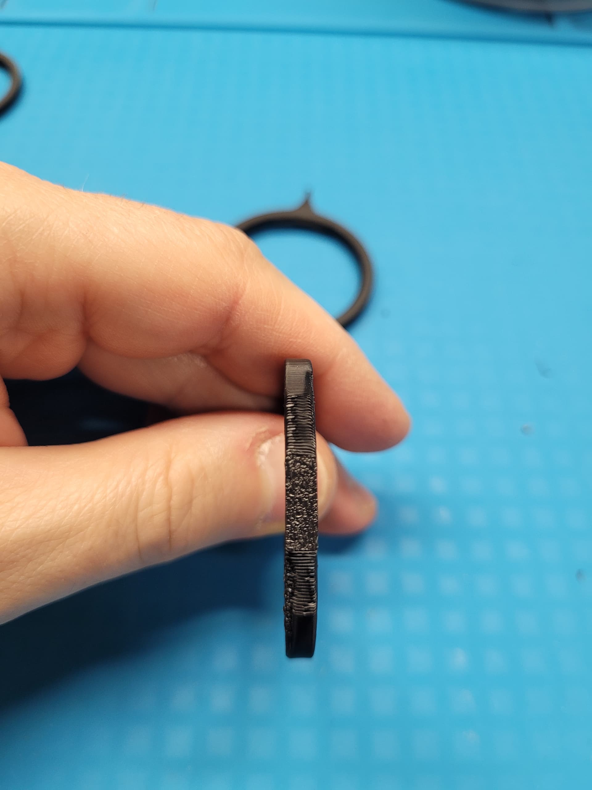

Now I want to print a ring-shaped object with Bambu PLA in a standing orientation.
The print itself worked, but there is some deformation happening at the lower end of the object.
Appended is my Bambu-Project and some pictures of the problem.
I’m still learning in 3D-printing, so I would appreciate every help to understand, what the problem is with this print.

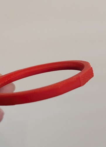

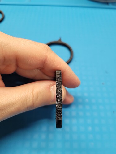

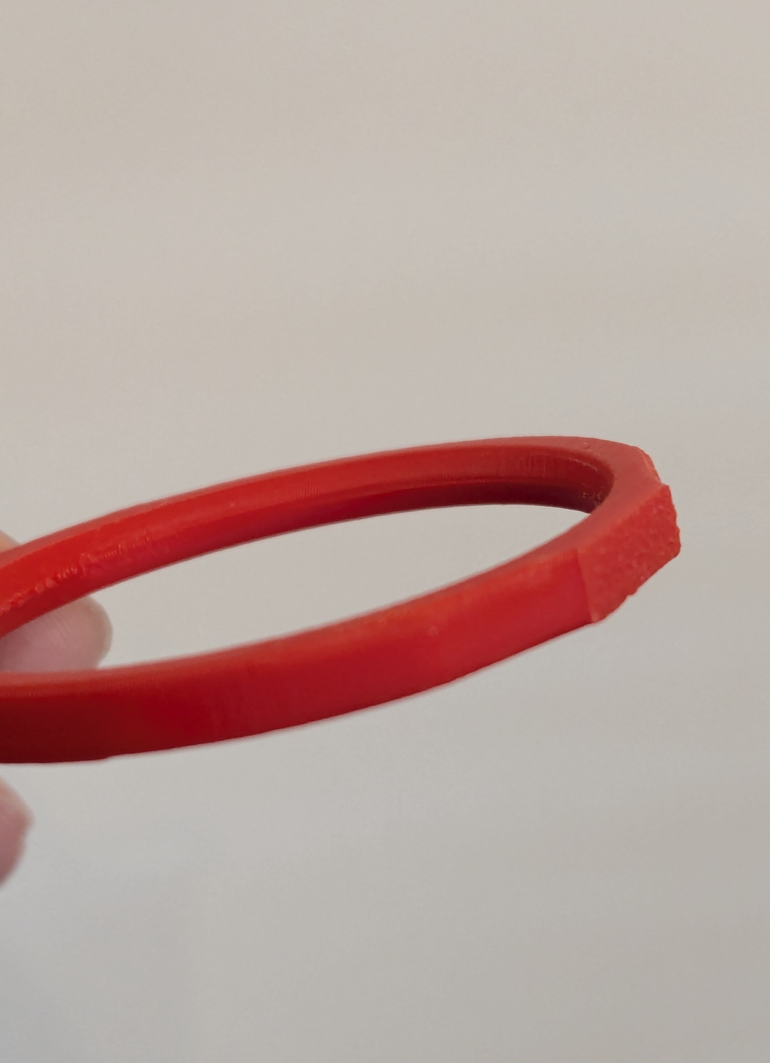

As you can see in the pictures, the deformation always happens at the first vertical angle, on both sides of the ring, but on each side always at one edge which is diagonally opposite to the other one.
I tried different support settings (angle %, standard and tree), different layer heights (from 0,08 to 0,20) and so on, but the results are nearly the same always.
Thanks in advance for any help.
Wolfgang

The area of the item where you are having issues is an overhang that is close to the limits for just standard printing. I used the variable layer height with smoothing so it would use thinner layers in those areas. I also painted the trouble spots with “seam blockers” because they can cause issues with small features.
When you open the .3mf file in Bambu Studio you can see the items I changed by the circular arrow next to the setting.

I have printed your file and it looks better now, but I thought that this kind of angle would be still fine for printing. Lesson learned…
Can you also tell me, why on my previous prints (see the pictures in the initial post) there was always one edge much more deformed than the other one? Is this a temperature thing when the lower layers are cooling and deforming the edges and bending them upwards?

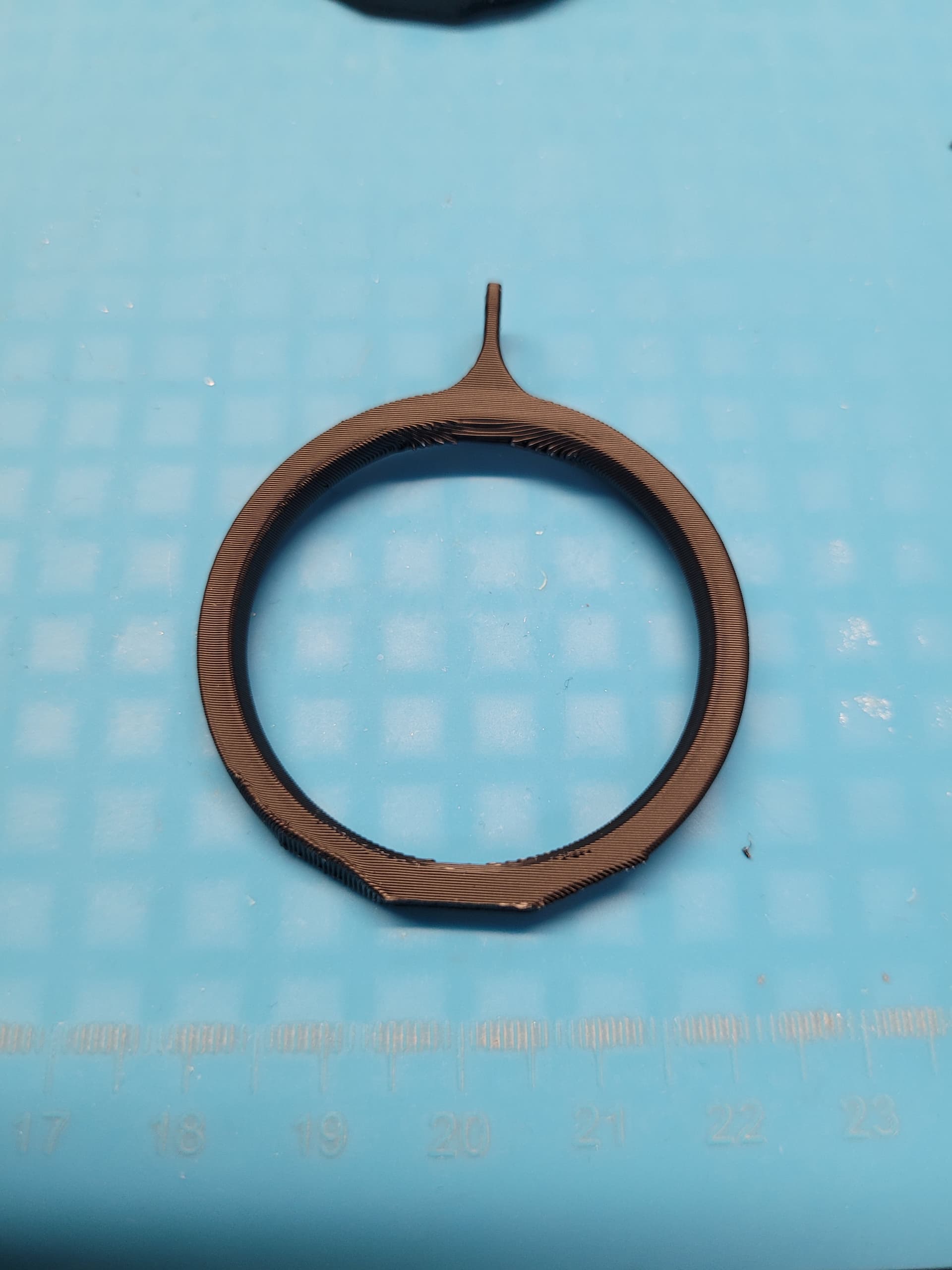

How would you do it, if this ring is printed horizontally?
Because of the small wider o-ring at the top, the ring itself can not lay flat on the build plate and therefore the ring is lifted from the build plate with a big support area underneath.
The issue is probably a combination of the overhang angle and cooling for such a small feature. I tried printing with the part rotated 90 Greg on the plate but the issue moved to the right face of the part (away from the part cooling fan).
If you keep your overhang angles >40 deg you will have better results. The lowest limit is around 30 deg, but that requires a lot of tuning to get it looking good. PETG and TPU are more sensitive to overhang angle than PLA. Keep the angle 45+ deg for PETG and TPU for easy printing.

Is this your design? If so, you could make it thicker so you can lay it flat for printing. Since you have an AMS you could use PLA support material to hold the body off the plate in a horizontal position.
