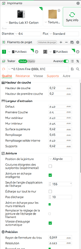

Detailed description of the problem : just receive my new BAMBULAB X1C I try a small box to configure support. The printing was perfect, but I had difficulties removing the supports and, finally I was destroying the aspect of the overhang. See pictures.
Beginner in 3D printing, your advices would be really appreciated.
I do want to print the small box as shown. I know it is not an easy position but I want to precisely test the configuration of the supports.

Are you not able to print the box as you have it shown in the picture here? I wouldn’t think any supports would be needed in that orientation.
I had seen a video about supports and have used the suggested settings many times without issues.
Support settings:
Top Z Distance: .24
Top Interface Layers: 3
Top Interface Spacing: .12
Support object XYZ Distance: .35
Initial layer expansion: 8
My preferred support settings are to use always:
  • [Layer Height] - 0.04 as Top Z Distance
  • 3 Top Interface Layers
  • 0 Top Interface Spacing [this is not z gap, this is how solid the interface is]
And then to muck around wtih threshhold angle / painting supports / build plate only etc until the model seems adequately supported in the preview.
3 layers plus 0 spacing means that the interface is a big fused mass and if you get any grip on it at all, it’s all coming off in one piece
