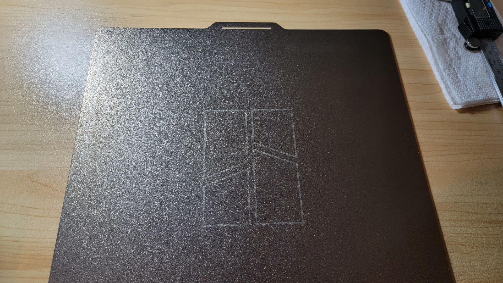

I’m hoping someone can help me understand what’s going on.
P2S, a couple of months old.
Standard included PEI build plate cleaned with 99% Isopropyl alcohol.
Multiple PLA filaments used with the same results.
Standard Bambu P2S profile, bed temp at 55c.
Auto-leveling is ON
One specific area of the bed seems to have adhesion issues on nearly every print.
It’s like the bed is super hot in this area but I’ve scanned the bed edge-to-edge with a laser thermometer and it’s consistent within a degree or two. I’ve examined the PEI plate closely and see zero issues in this area.
Is it possible there is a coating at play that I can’t see that has been eroded from this part of the plate?

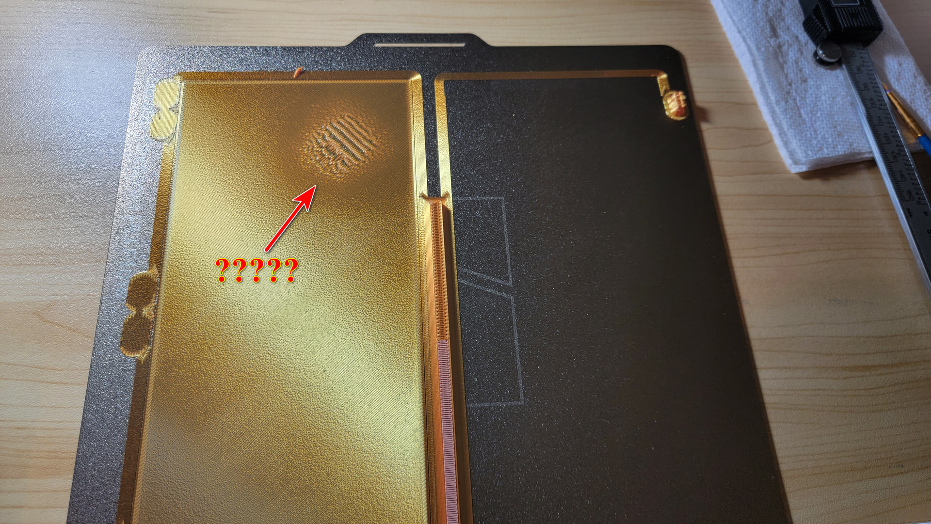

What happens if you flip the plate over?
Man, you guys are quick. I didn’t even have time to fix my posting errors before the replies started coming in. I’ll scrub it good with soap and water and try a test print. My gut says that’s not it but I’m willing to give it a shot.

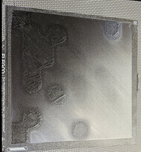

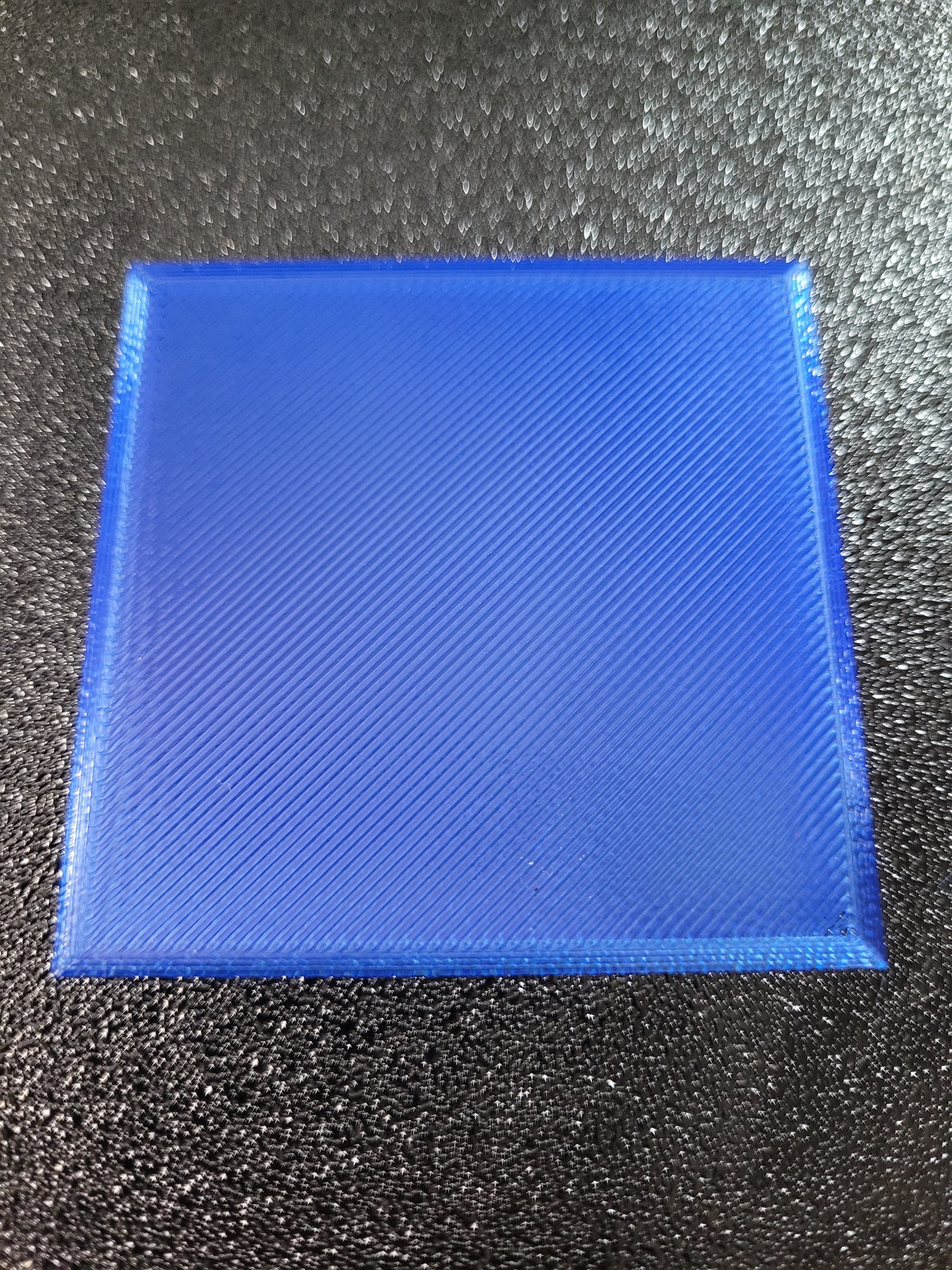

Might be just the picture but the whole layer looks weird to me. Really bumpy and that one part is just the worst of it…
The first layer should be smooth with visible print lines like this:
Maybe you can find an answer here:
Bad advice, the printer will be upside down.
Like me with the ladies!
I can report that scrubbing the heck out of the plate with dish soap and hot water did not fix the issue. Same issue at the same location. Maybe a defective build plate coating? I’ll try the plate from one of my other p2s’s after this partial print finishes (goofed object has been skipped) and see if that sprints smoothly.
Luckily the print did not flip upside down but there was a momentary anti-matter spike in the region of the printer.
And, the print did adhere fine in all areas to the left of center. I just printed half of the plate on that side for this follow up test and, of course, the trouble area is on the right side of the down side now so the final test will be to print something on the right-of-center area of the 2nd side and see if the issue occurs there.
If it doesn’t then there just has to be some erosion in that area of the “bad” side that is invisible to the eye and touch. If it persists on the right side of the 2nd side then there is some issue that passes through the entire plate in that area.

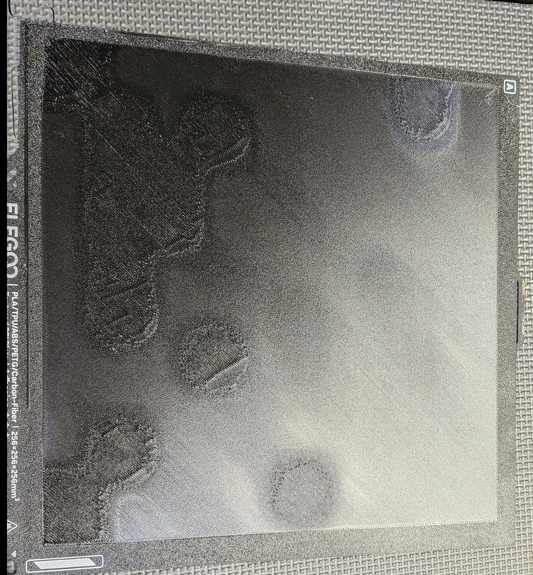

To me; it looks similar to when Bed Mesh Level gets 1 point drastically wrong [for many reasons]
clean the nozzle tip real well and then do another bed level calibration? Perhaps even a factory reset then calibrate, I honestly dont know which calibration in which bambus printer lineup get that info anymore.
I am posting this pic as an example when LOTS of Bed Mesh level points are drastically wrong [sensor failed, elegoo centauri carbon]
edit: I would add that while I was debugging the above issue, I could see the Z screws visibly turning a ridiculous amount when it was painting those sections of bottom surface, so if its bed mesh, you should be able to see that too with your eyeballs.
