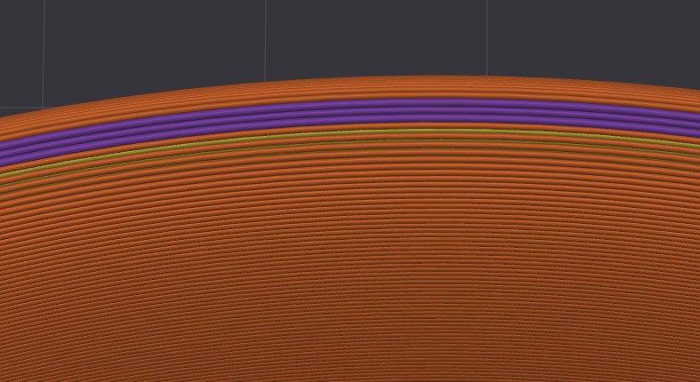

So here is a bit of a confusing issue and I’m in an awkward spot since I can’t post proper photos due to the models being highly sensitive for this client (managed to get a small section below). Hopefully I can describe it as well as possible!
Imagine the model as a large bowl (10 cm in diameter). The sides of the bowl are rounded (in and out) and come up to a rounded point. The top rim of the bowl isn’t a flat surface as the inside and outside meet at the top point.
I’ve printed hundreds of these on my X1C and the absolute top edge is nice and smooth.
Over the last few months, about 30% of them have sort of a bubbled top edge. Over the last month this has increased to 70%. I have to completely discard the print when this happens.

An important note is that the ‘top surface’ is ‘internal solid infill’ due to how the model is sliced and various settings. I have also played with settings around internal solid infill with no success.
Physically watching the issue happen, I can see the bubbling happening BELOW the top ‘internal solid infill’ layer (almost seems like too much flow, but the rest of the model is perfect). Then this layer lays on top but doesn’t smoothen out the bubbling. The layers where this is happening is 7 solid layers of ‘inner wall’. This is due to the model having 4 walls so the last 7 layers have no infill.

Even though I have used the exact same filament brand and colour for over a year, I think there was a small formula change. I dropped the flow for the filament profile by around 3% and the issue is completely gone across 4 100% prints (2 on each X1C).
I will keep printing to ensure that I get this consistently (I have had streaks of 10+ prints with no issue then suddenly it comes back), but going from close to 100% of prints having the issue to 4 in a row of perfection, I think I have nailed it.
It makes sense too. Too much flow near the top of the print will create mini bulges where the upper layers are unable to hide them well enough. Silk in particular will highlight these issues more than other PLA.
