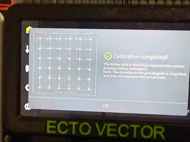

I just used my vision encoder plate for the first time and I was expecting to see results that show some type of measurement. Instead I got a graphic that doesn’t mean much to me. Did I do something wrong? Is there a log file or something I can review? This is all I got back from the printer:
This the new feedback, you get in the latest firmware version.
It basically gives you an exaggerated graphical representation of the dimensional shift on the points on the bed.
Unfortunately it doesn’t give you any dimensional feedback anymore.
The proces went fine, and the numbers in the past weren’t saying a lot either, because they were referencing the maximum correction relative to uncompensated measurements.
In your case there is definitely some skew correction.
It would still be nice to have that maximum deviation go with the graph.
On the other hand, what does that information bring you?
Goal of the procedure is a calibrated motion system.
