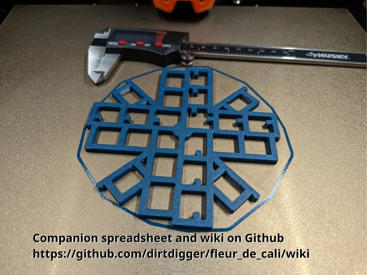

It might be interesting to print the califlower before and after the Vision encoder run to measure the skew before and after.
If you want a simpler model, you might use the calibration object from klipper.
I assume the skew is eliminated after the vision encoder.

I am still curious if the skew model differs before (after factory reset) and after calibration with the Vision Encoder.

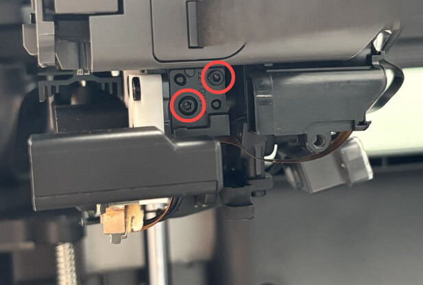

Maybe check that the screws that hold on the toolhead camera are tight. If they are loose, I can see that causing all kinds of issues.
Also check that the calibration sticker at the back of the heatbed looks okay and is clean. Might as well clean the toolhead camera too. HMS_0C00-0100-0001-0004: Toolhead Camera lens seems to be dirty. Please clean the lens. | Bambu Lab Wiki
Camera is clean and doesn’t feel loose, that calibration sticker in the back looks ok to me. If the camera is wonky then it’s gotta be a factory defect, not just loose or wobbly.

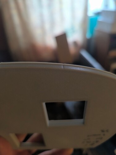

I do reset factory but i still have the “seam” around the last layers. i investigate on discord bambu but it’s really unandurstable. i follow all your comments and do the same thing.
That looks different than my issue. Mine slowly drifts. Every layer is shifted a little to the right until finally it’s printing in mid air and fails. That looks like an actual layer shift.
