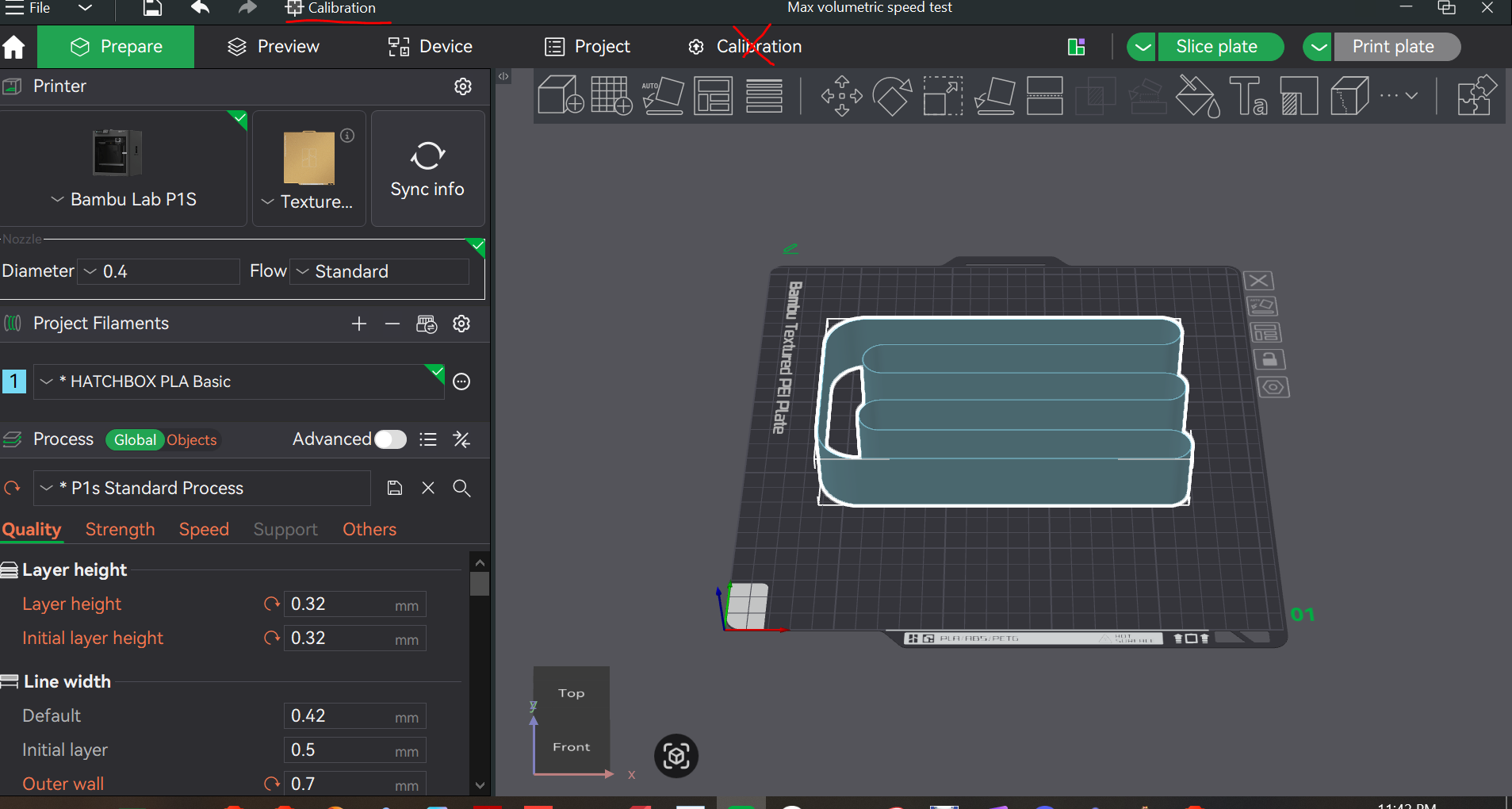

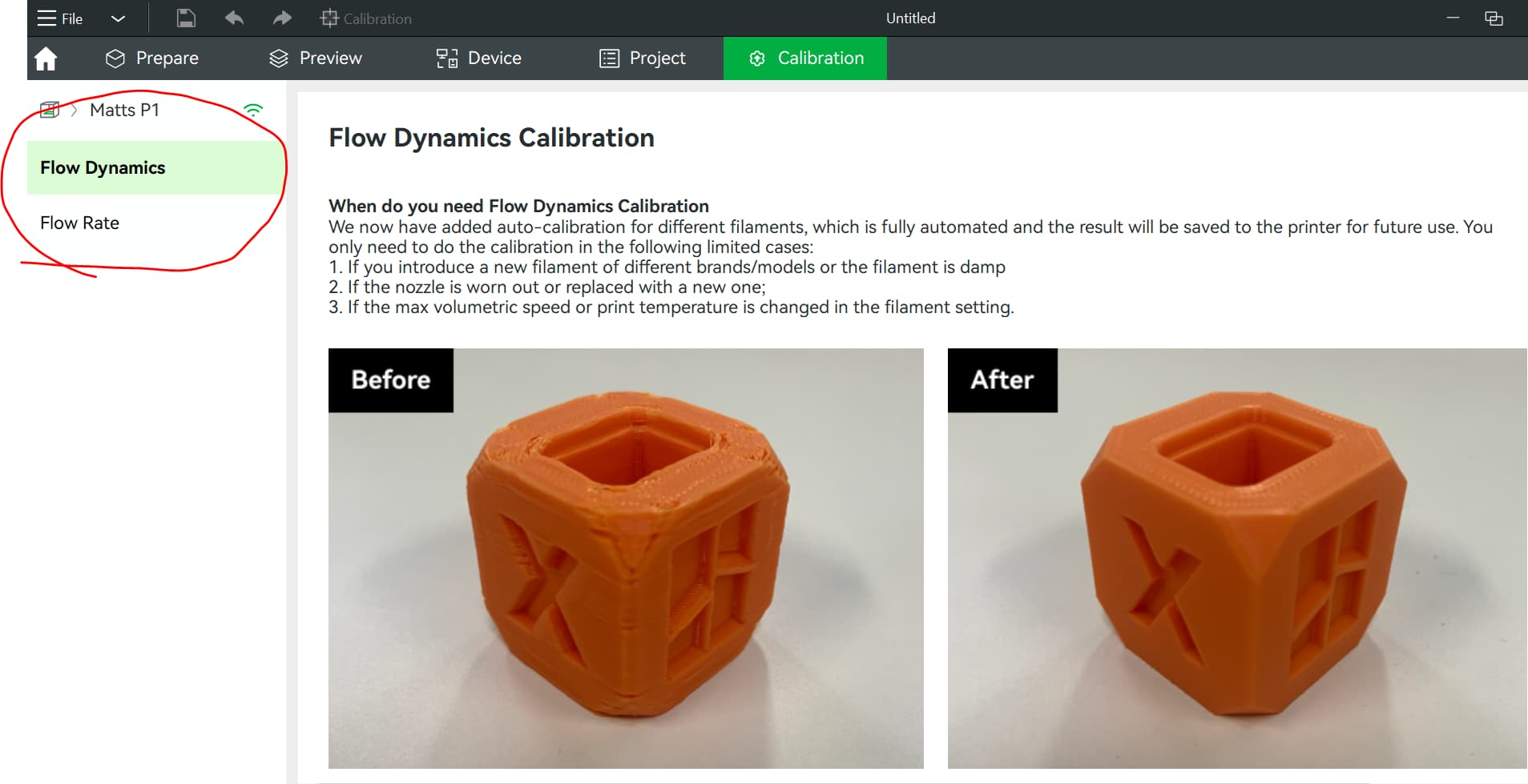

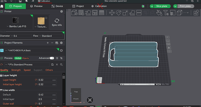

ok, i activated the develop mode, but under the calibration tab, nothing has changed, its still just flow dynamics and flow rate. There is no max flow rate

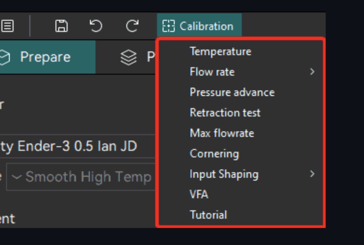

Should look like this

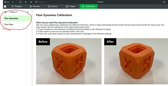

no, this is all mine shows
wait, i see another calibration button… it only works if i am on the prepare tab. let me try that button…

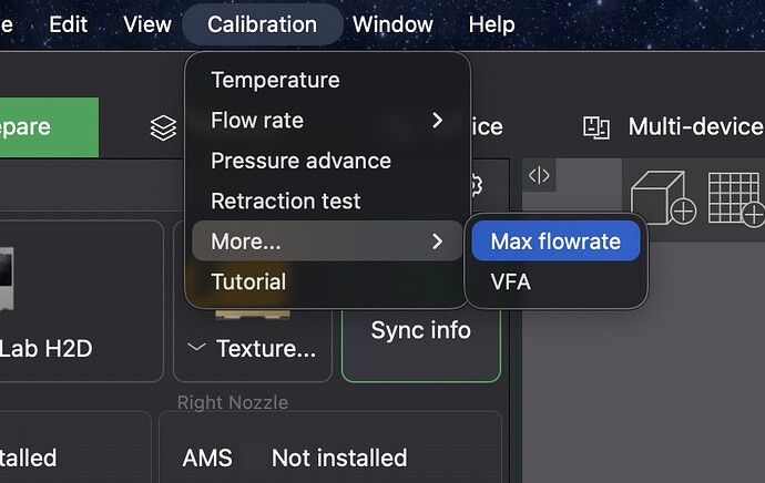

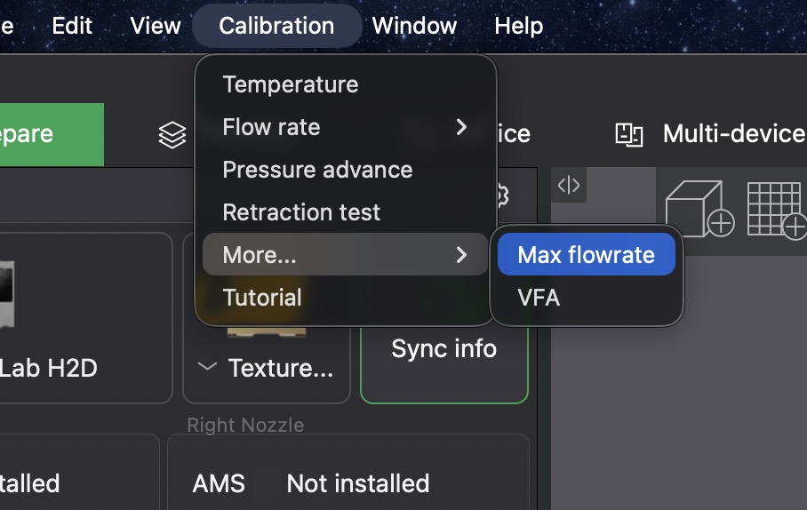

If you are on macOS:
yeah, there are 2 different calibration tabs, i didnt see the smaller one earlier haha
thank you. I was able to test my filament and it never deformed up to 20mm^3. But to keep things safe, ill keep it at 20mm3 rather than increasing it.
