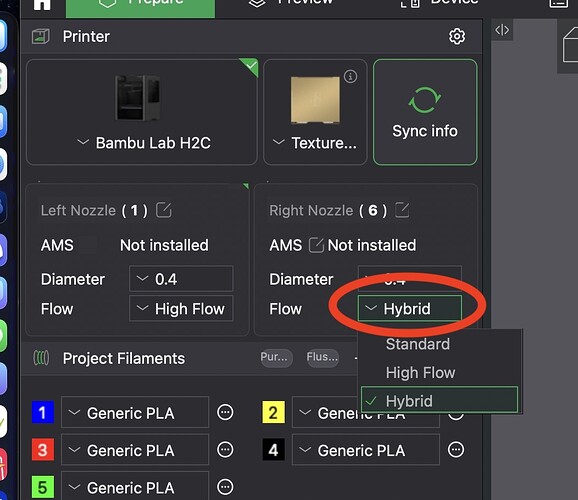

How about when it comes to standard and high flow nozzles. Are the Vortek nozzles supplied as default the standard nozzles, ie, not HF?
If so, can I keep the HF nozzle I currently have in my left nozzle and use it for support, while using the standard Vortek nozzles in the right?
Or do they all need to match on both sides?
I think until supply is good and they make different bundles they expect people to get the 5 nozzle 129 euro solution since that comes with 3 0.4 nozzles and the 2 missing left nozzles 0.2 and 0.6 if you want to do multi material with 0.2 or 0.6. The price of 35 euro’s for a 0.4 x 3 = 105 euro’s is close enough for the 5 pack where you pay 20 euro’s more for 2 left nozzles.
You can have mismatched HF vs standard nozzles, just not mismatched nozzle sizes. So yes, you can have have your HF installed on the left and a standard on the right.
You can have a mix of HF and standard between left and right and a mix of nozzles types on the Vortek. For Vortek make sure to pick “Hybrid” in bambu studio when slicing. It will default to using the available standard nozzles first, and HF nozzles last though.
