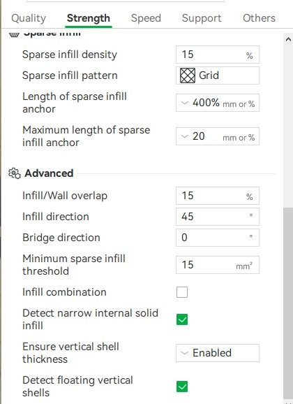

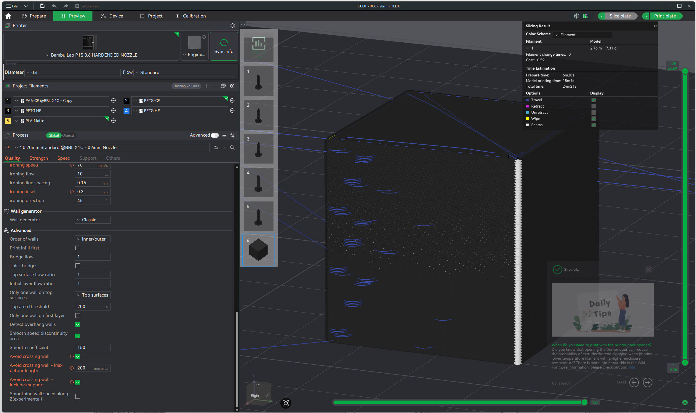

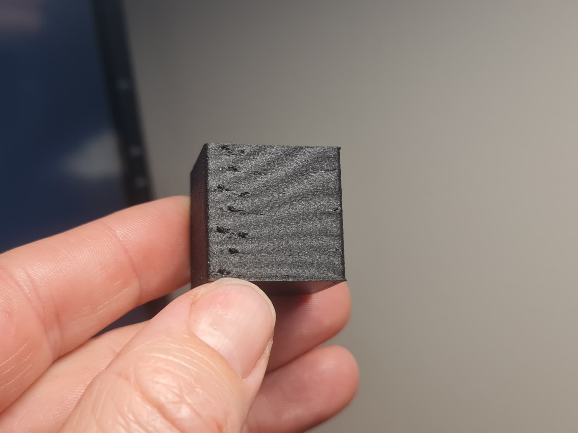

Hi All,
I’m trying to dial in a profile for PA6-CF with a 0.6mm Nozzle, but I’m getting an artifact that I can’t get rid of. It seems that travels for the start or end of the infill are crossing the wall, leaving a defect on the surface. I have ‘Avoid Crossing Wall’ selected, but that hasn’t changed anything. I tried printing infil first, but that just aligned all the defects in a column.
Any suggestions for getting rid of this problem? I didn’t notice it with the 0.4mm nozzle.

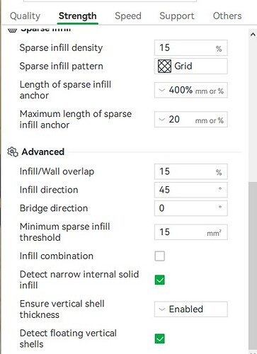

You could try increasing the number of walls or decreasing the infill/wall overlap slightly.
Don’t use Grid… not that that is your problem… Try outer wall then inner wall. See if that eliminates it. BUT, You see it on the studio preview. It is Most probably a MODEL issue.
