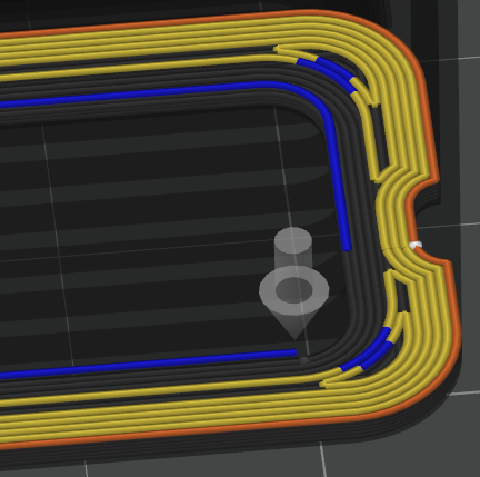

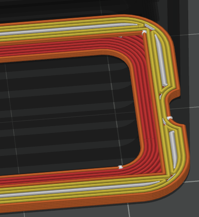

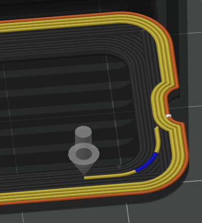

I have wall order set for outside-inside. The first overhanging layer does indeed start from the outside of the part but then jumps away from the new outer wall
and then full-on jumps to the unsupported inner edge of the overhang
This does not work, because the filament does not adhere to the frosted surface of the drafting film. The unattached free-hanging filament causes much stringing and a non-functional print.

I don’t know how many wall loops you have, but I think the blue line on your last image is the outer wall. The printer was doing exactly what you asked it to do.
When printing overhangs, it is better to be in the order of inner→outer wall.
Also make sure the overhang is not too much that it becomes unsupported floating regions that causes printing mid-air.

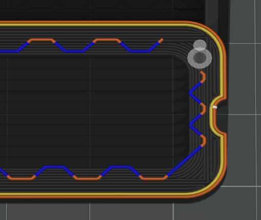

A possible quick solution: Stop trying to make it perfectly round your overhang. Instead, draw wavy lines so that about 30% is on the Mylar and 70% is on the object to be printed. There is no logical reason to make it perfectly round and print it 100% on the Mylar. Instead of waves, jagged edges are also possible, of course.
That is an interesting concept. Put “tabs” on the first layer above the recess and then full layers above that. I will give that a try after I stop typing here. :slight_smile: I do need a full light seal around the mylar strips–this will go into an ultrasensitive piece of optical lab equipment.

On topic, this object, since it has a hole in the middle, has two outer walls. :slight_smile: So despite telling it outer/inner, the ordering of WHICH outer will be a small bit up to the slicer. “Outer” meaning a skin path that touches external air vs “inner” being repeats of that contour but inside filled space.
The middle of your model is hollow, so there are two outer walls, one on the outermost and the other the innermost. The slicer did treat it as overhang, as indicated by the blue color. If it were a normal outer wall (without being an overhang line), the color would have been the same orange color as the outermost line on your image.

I will know in a few minutes about that. The “tabs” are at least theoretically anchored on the existing layer
Part is just starting, I’ll know in about 5 minutes or so… :slight_smile:
:+1: :+1: This is working perfectly, at least for the first two of the 15 inserts. thank you again! I am still going to try Bullock’s sideways orientation–I can use my original STEP file and just put one pause… Even though the printer is just across the hall from my office, I find myself just staying over there between pauses to watch it…
