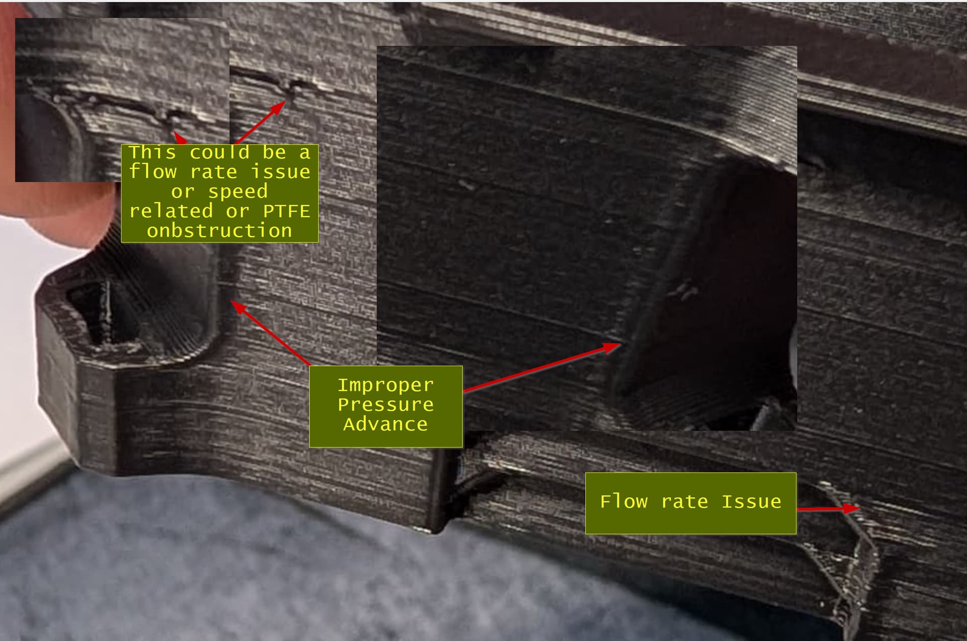

Have some strange print quality issues with PETG HF. Dried in AMS HT for 12 hrs. The layer artifacts I’m having trouble tuning out. H2D (1100hrs).4 Nozzle.2 layer height Stock PETG HF profile Any suggestions?
Putting dry vs not dry filament aside - since you already addressed that - what I’m seeing here points to multiple calibration-related failure modes rather than a single defect.
Based on the surface features in the photo, the likely categories are:
  • Flow rate mismatch
  • Pressure Advance error
  • Filament path friction (PTFE / AMS related)
Here’s what I would suggest as troubleshooting steps. Do these in order.
  1. Switch to a known-good PETG profile using a different spool. Generic PETG is a good baseline.
    • Do not rely on auto calibration.
    • If the symptoms change, perform manual filament calibration. Start with flow rate, then Pressure Advance, then temp calibration. Last do a volumetric flow calibration.
  2. Remove the AMS from the troubleshooting path.
    • Print directly from the external spool holder.
    • If the symptoms change with the AMS removed, inspect the entire PTFE path before putting it back into service.
      • Look for inner wall wear.
      • Verify bend radius, especially near the toolhead. Excess slack right before the toolhead can create a sharper bend, add friction, and show up as flow instability.
  3. Inspect the Z screws.
    • Clean and lubricate.
    • This is less likely the primary cause of the defects shown, but it is easy to rule out and can contribute to inconsistent layer behavior.
Net: all of these artifacts are most commonly explained by improper filament calibration, with mechanical friction as the next most likely contributor. I would rule out calibration first before chasing hardware faults.

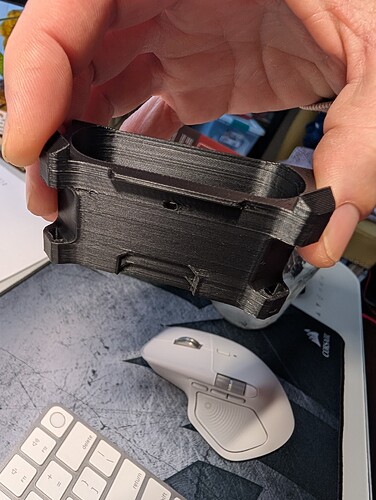

My experiments with PETG HF. In the first photo the walls/sides have uneven and kind of doughy texture, I had lifting on an edge and there is minor stringing.
The second photo is the same part, same print profile, same filament even - after drying. Walls are flat and smooth, no lifting, hardly any stringing.
The only difference was water in the filament and it wasn’t even all that wet. PETG HF hates water.

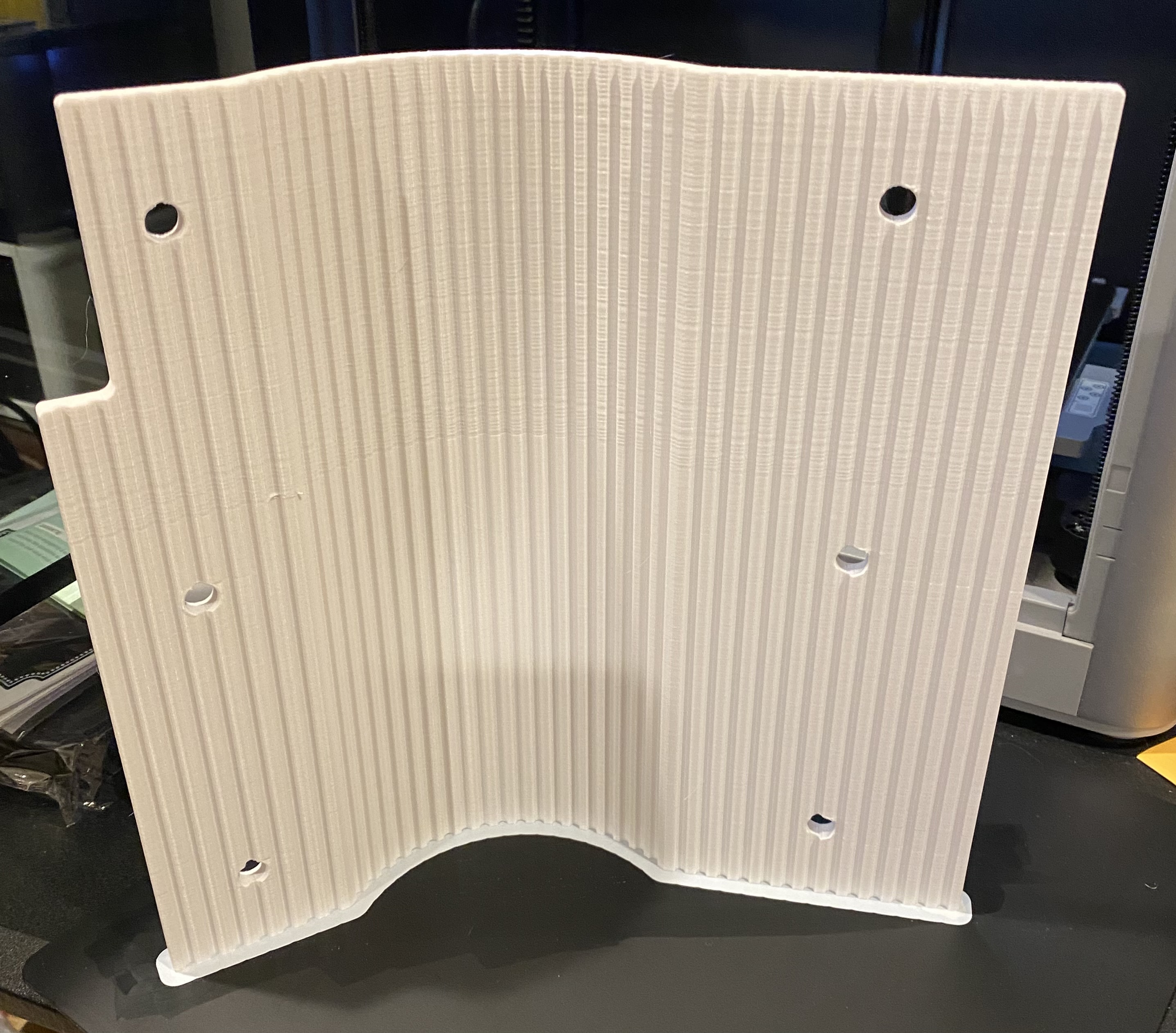

Here’s another example of a repair part I printed for a friend. The print started with dry PETG HF and looks ok. I was running low on filament so started another spool drying but it didn’t have time to get as dry as I usually go. You can see the point where the filament ran out and the new spool took over near the middle left hole. (Tiny bit of filament sticking out) The upper part of the print had higher water content during printing. There’s a clear difference between the two spools in how they print. I didn’t check lot numbers but both spools were bought at the same time so maybe even same filament lot.
That’s my experience with PETG HF. Dry it and it prints great with smooth walls. Not dry enough and you get doughy walls or worse.
Maybe the same issue.
