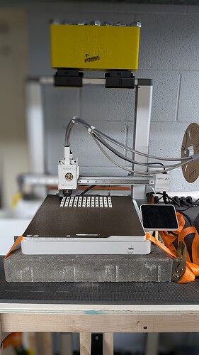

Listen, sometimes an A1 goes thru some things and gets the ultra-gravity applied to it.
results were inconclusive on quality, btw, but it sure did feel like it was quieter. I wasn’t measuring
