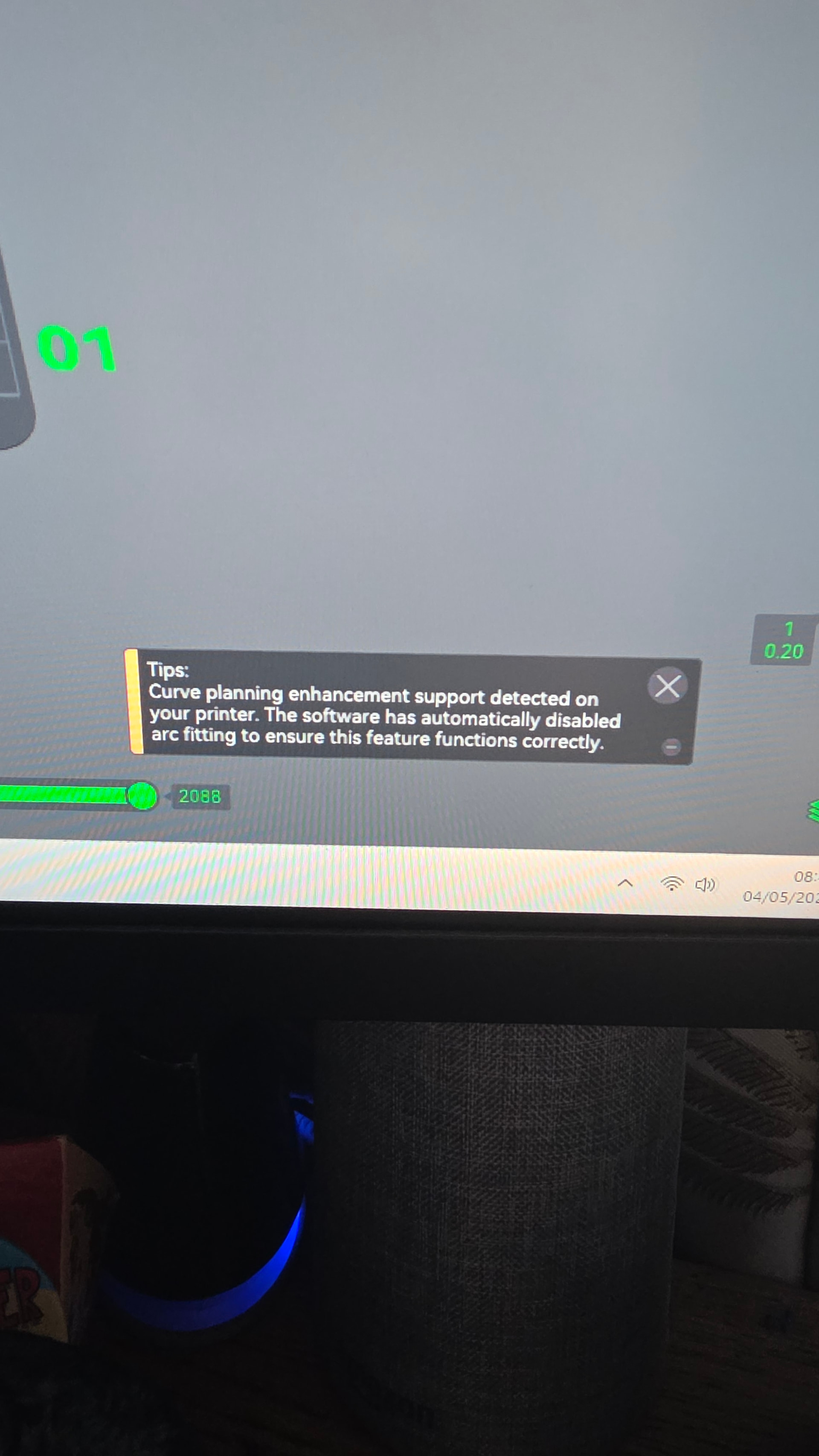

I recently got my X2D delivered and I’m loving the printer. I seem to be getting an warning message at the bottom left of the screen which says (curve planning support detected on your printer. The software has automatically disabled arc fitting).
Is there anyway I can stop this warning coming up after I slice my print files?

Well for starters, that’s not a warning. It’s a tip.
Nothing to be concerned about.

Just as an explanation, arc fitting and curve planning are two ways of the machine figuring out how to move - old school machines used linear interpolation (breaking up every curve into little tiny line segments), arc fitting was an improvement that treated every non-linear section as an arc (smoother overall), and now curve planning uses splices to be even more precise.

Simply disable the arc fitting and save the preset without arc fitting enabled. It looks like it is the only way of getting rid of that tip/message
I have done exactly that and it still brings up the message. So even though it hasn’t changed any setting, because it was already adjusted, it still claims to have disabled arc fitting :disappointed_face:
I hope that they will donate us a switch in the future to hide this very valuable information.
Arc fitting is disabled and I still get this message every time. So annoying.
Here there is a possible solution: Arc Fitting on H2S - ON or OFF? Studio warns to disable but it's ON by default! - #8 by James_Brown
