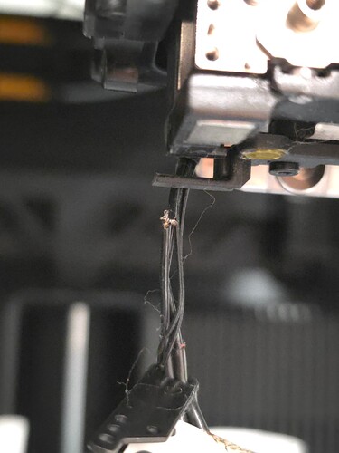

WARNING - Your Left Nozzle Heating Assembly Will Break
Excuse the sensationalism. With perhaps 1400H of purely 2+ color printing, the left nozzle heater wires became damaged from the thousands of cycles, each time dragging the cable across that lip, and would no longer heat the left nozzle.
Seems like the heating cable could use some extra chafing protection and is an actual flaw in the current configuration and may eventually happen to many of you. The left heating assembly on the bambu store consistently being out of stock seems to resonate with this opinion
Looks to be an easy repair if you own or know someone who owns a soldering iron and a bit of heat-shrink tubing. Once repaired, a sleeve of heat-shrink, or even a wrap or two of electrical tape should significantly extend the time before you’d need to deal with it again. I’d probably remove the part it chafes on and if there’s a sharp edge, break it down with a hand file so it’s rounded and smooth.

what can be done to prevent chafing on the wires…
I’d probably start with some teflon tape wraps or even simple electrical tape in the area that is getting frayed (on the replacement, not as a repair).
I would even consider using some heat shrink over the wires that are fraying (but not shrinking it down) to act as an abrasion barrier.
What’s causing the chaffing? Is it the hot-end moving up and down (something the right-hand hot-end can’t do), or the vigorous back-and-forth nozzle cleaning, or unintended abrasion against the print while executing travel moves, or…?
I’d expect it is the left nozzle raise and lowering action. There should be no relative motion of the hot end to the extruder body during wipes or printing.

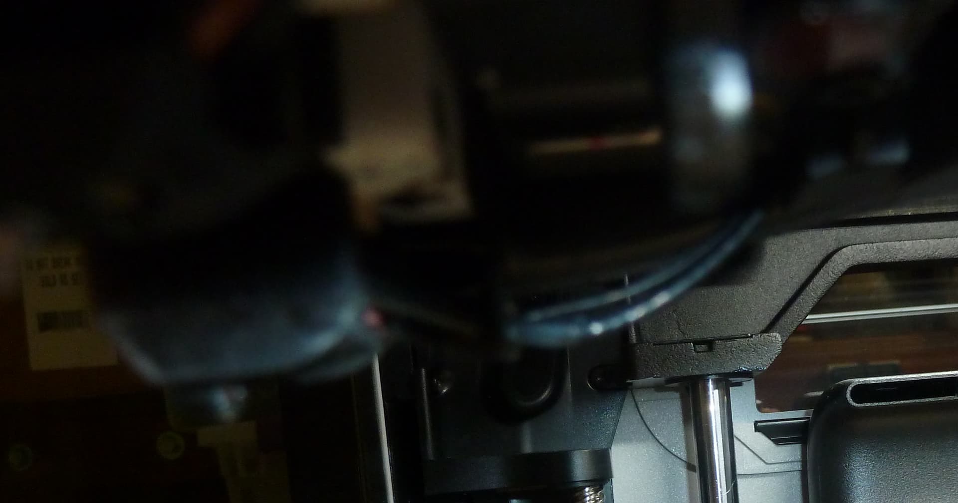

I’ve tried with a couple of different cameras, and I apologize that I can’t seem to capture a photo of the wires in focus. The photo below was the best I could do. Anyway, I don’t want to make a big deal about it, but it always struck me even from the beginning that the wires in question were hanging very low–I mean seemingly barely above the nozzle tip, especially when printing.
Kinda “flapping in the breeze” as Dave Jones would say.
Is this Bambu’s attempt to give as large a bend radius as possible in relation to the issue the OP raised?
Is it the same with everyone else’s H2D, or is my H2D just unusually “low hung”? Jokes aside, I mean it as a serious question.
My H2D’s is so low I was afraid it would potentially get snagged on a print, but I guess it’s just barely high enouugh that such snagging hasn’t yet occurred.
I know that in the CNC world there are special cables that are much more resistant to fatigue and chaffing failure for use in drag chains and such, but they do come at a premium price.
