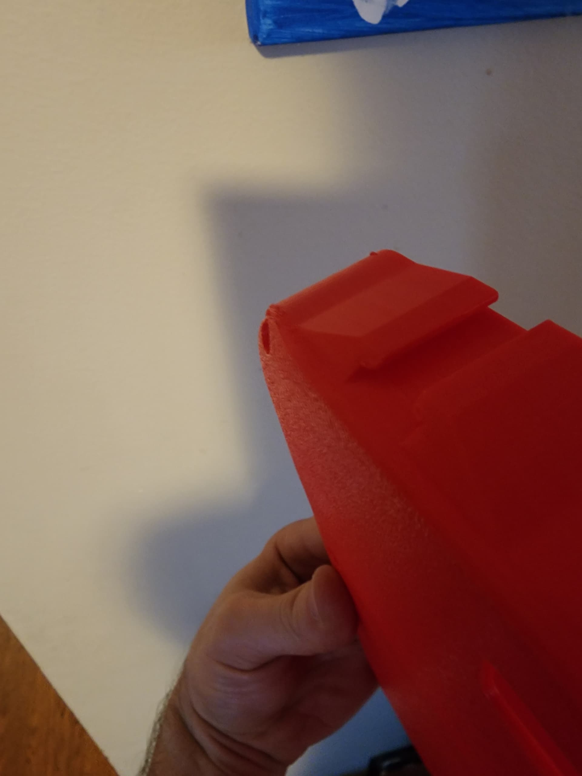

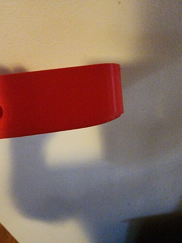

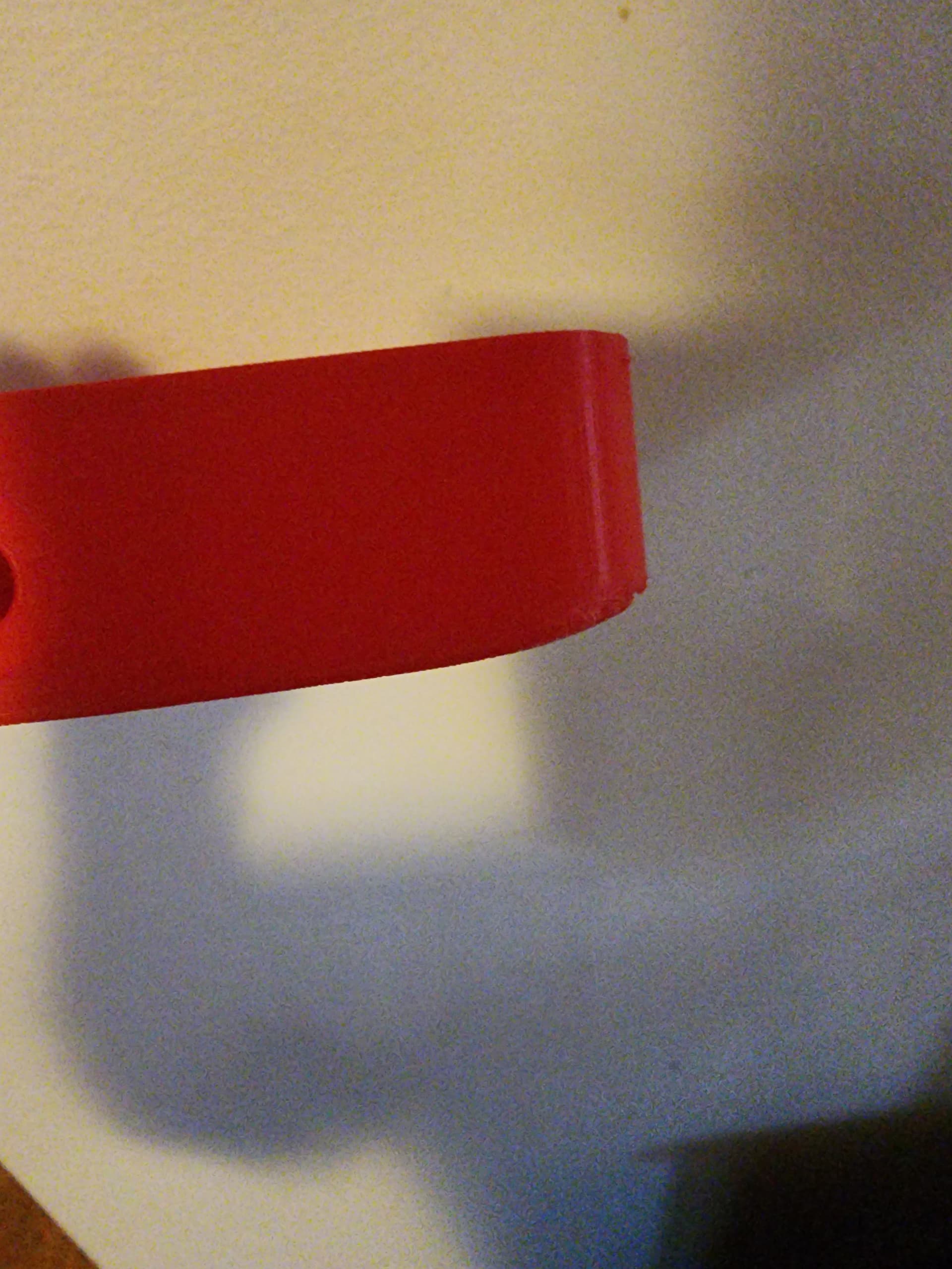

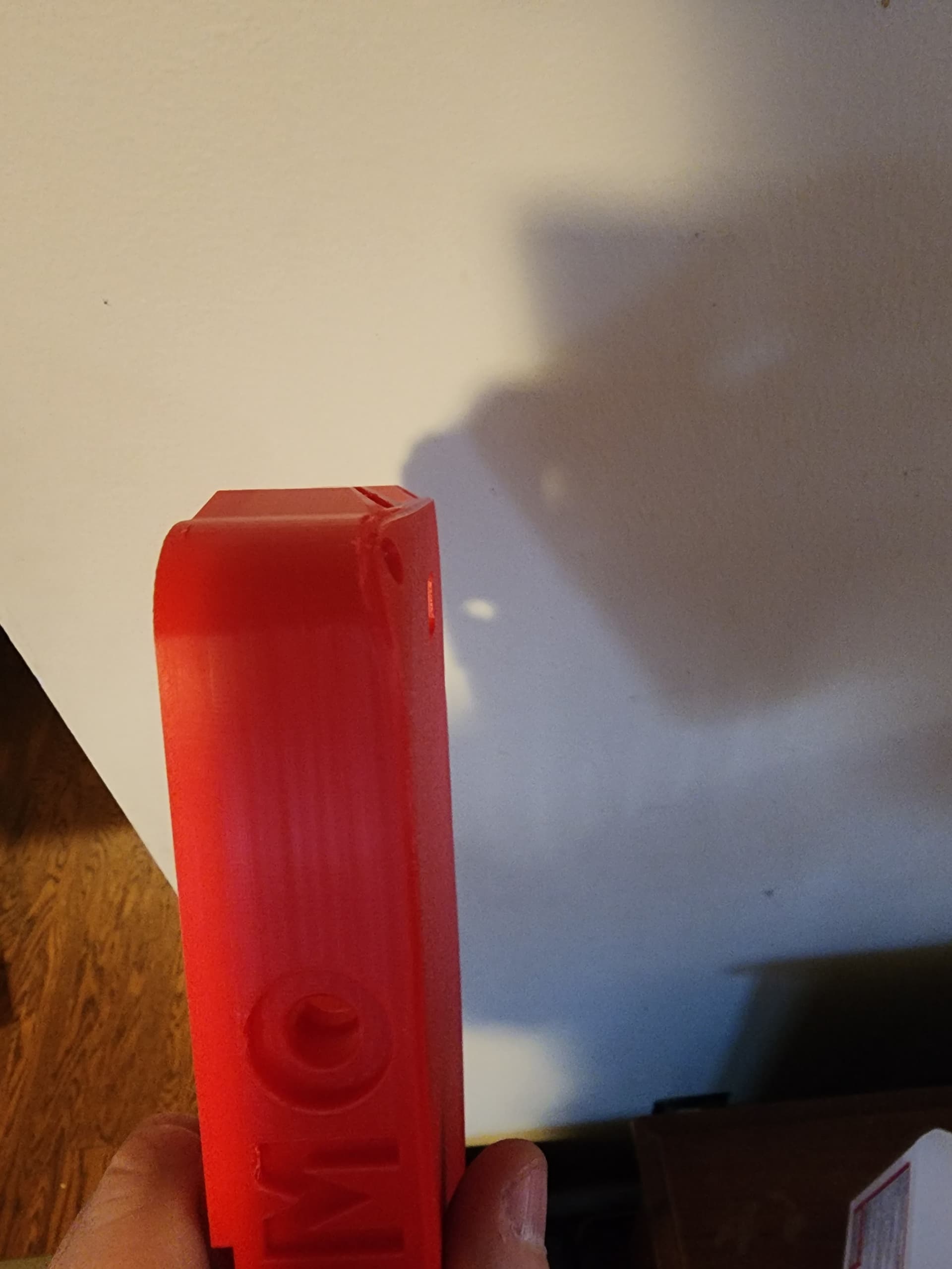

I am looking for some ideas on how to solve warping issues on larfe flat pieces. I am using the Bambu A1. Bed temp is 65C. I have tried 70C it kind of helps. Build Plate is PEI Plate with .4mm hardened nozzle. Any help is appreciated. Thanks in Advance.

Ended up modifying the original print profile. They were doing .08mm layers instead of .2mm layers and the issue went away. Print quality is still fine with good detail. Also prints much faster.
