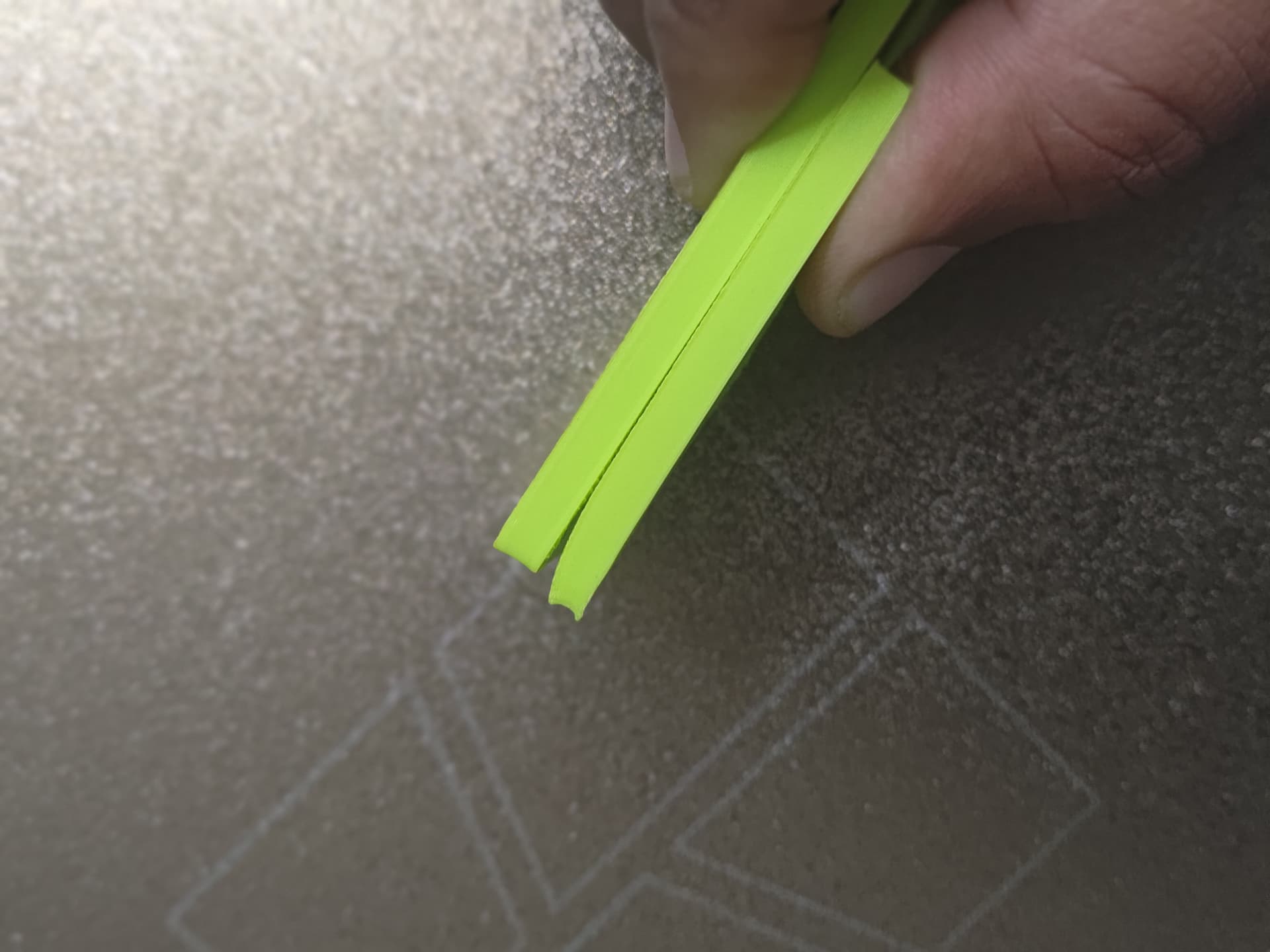

I’ve been using the Babmu Lab A1 for a while now and have been dealing with warping issues. I’ve tried the usual solutions like increasing bed temperature, covering the printer, and drying the filament in direct sunlight. These solves my problem most of the times.
Recently, I discovered that printing in “Ludicrous” mode significantly reduces warping, almost eliminating it entirely. Additionally, printing smaller portions on the plate (like half bed or quarter bed) also helps to prevent warping.
Has anyone else noticed these effects? I’m curious to know why smaller, faster prints seem less prone to warping. Why forums do not mention this as a solution (I have suffered so long with wrapping :unamused:)
Is there any way to set the printer to a speed faster than Ludicrous mode without sacrificing print quality? Ludicrous mode barely effects the quality of my prints, so I want to try higher speeds. But if I print in standard mode, with custom profile having every parameter under speed set to 166%, then I get a much much worse quality.
