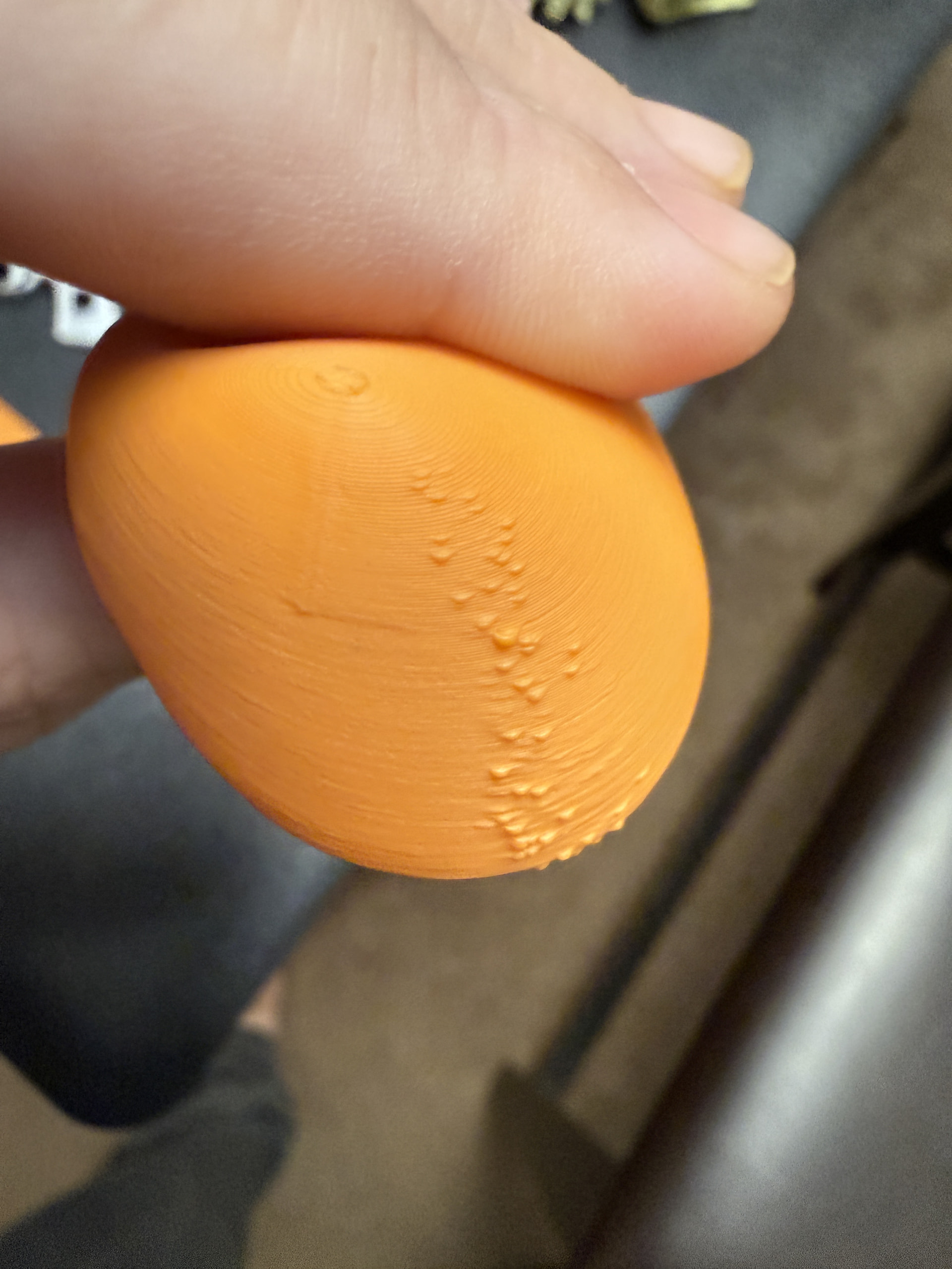

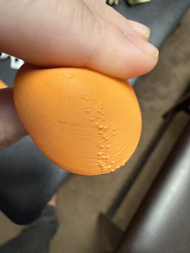

I have 2 X1C’s in my farm that recently updated firmware. Since then my prints have some serious surface defects. I have reprinted these flawlessly in the P2S using the same rolls of filament after this occurred. Whatever the issue is its not wet filament or model issues. Honestly I have no idea where to start. This is not occurring at a seem or a overhang or anything.
The only commonality is the location. It only happens to the section that’s facing forward towards the front of the machine on both printers.

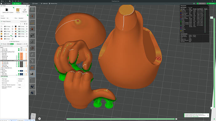

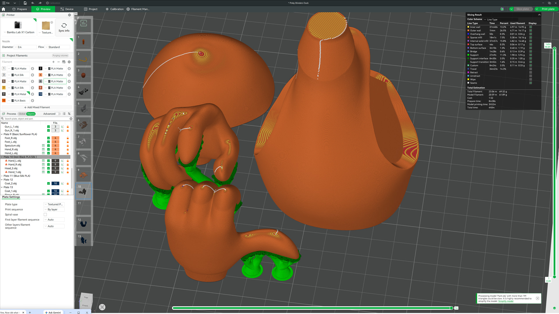

slice, preview, line type, take a screenshot of that side

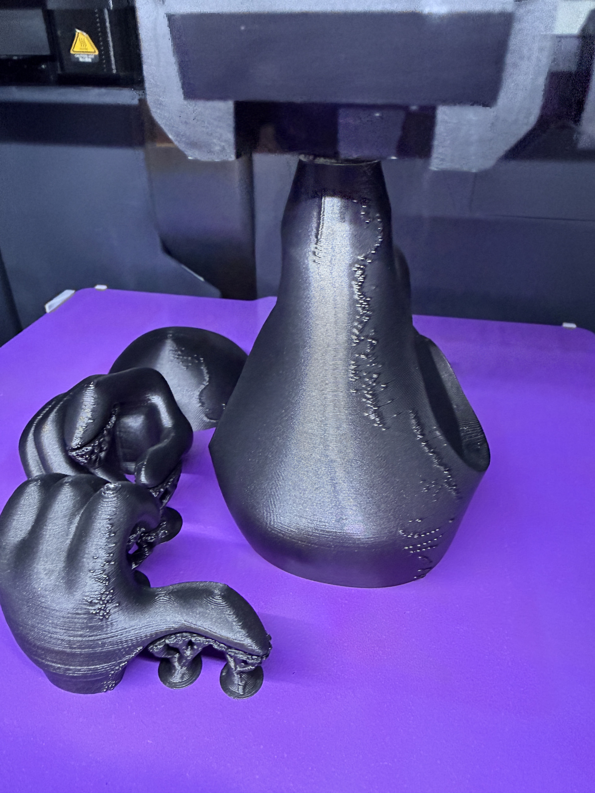

I am having same issue attempted to rollback to v2.8.0.50 with no luck fixing it. I noticed it is only happening to some object. I tried printing two sets of two object merged in pairs with print by object turned on. one of each object had the zits issue, the other object printed fine.
