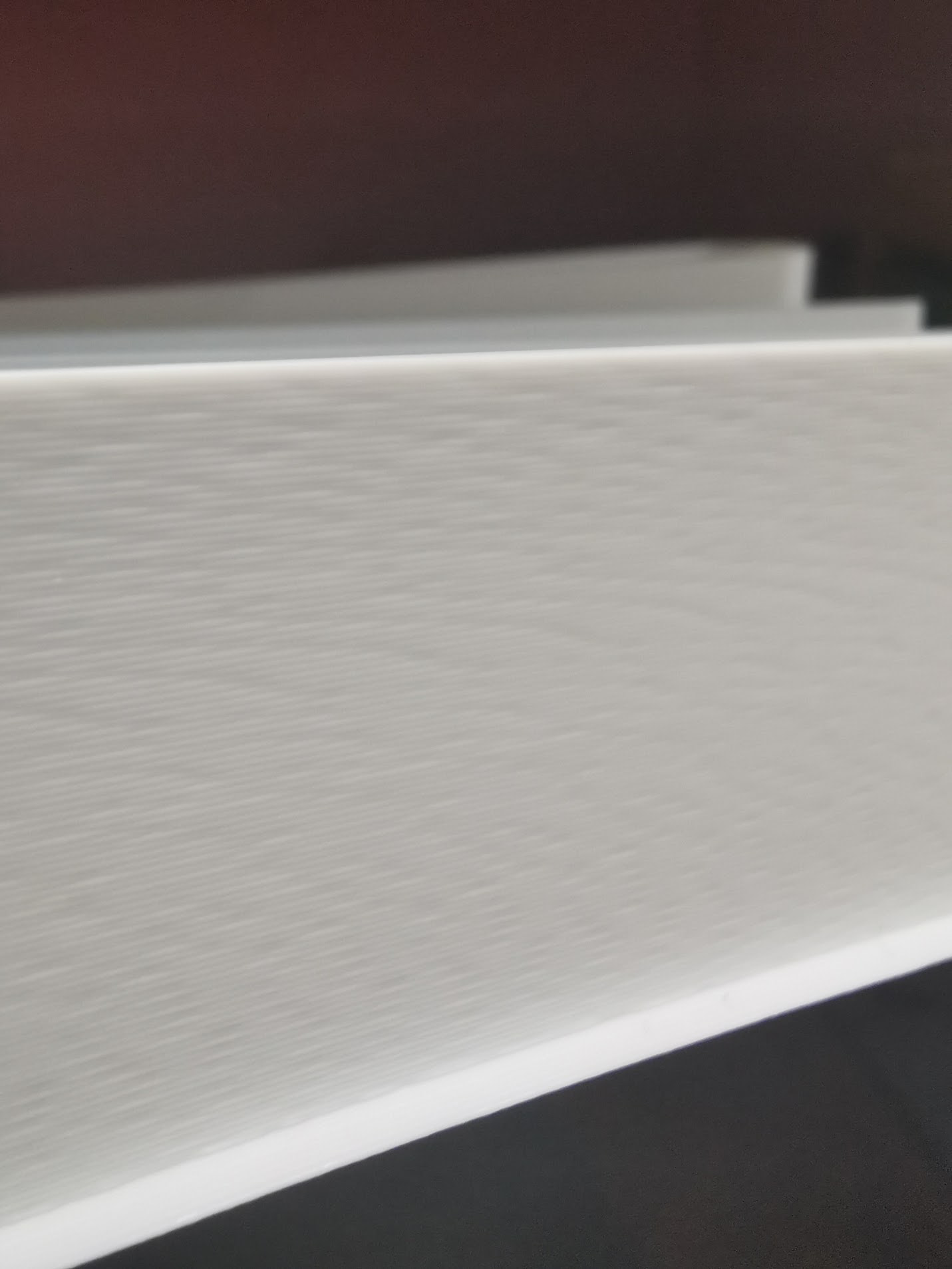

What is this wavy/bumpy pattern? I don’t get this when printing with the main nozzle. And I have calibrated my pressure advance. this is elegoo pla basic. This is actually the model to calibrate max volumetric flow that went from 5 to 20 mm3, i couldn’t really pick a good value because of this pattern which shows up on every layer.
White is terrible because it shows everything as more serious than it is. Shadows and all.
To me it looks like you might be overextruding a little bit as well.
