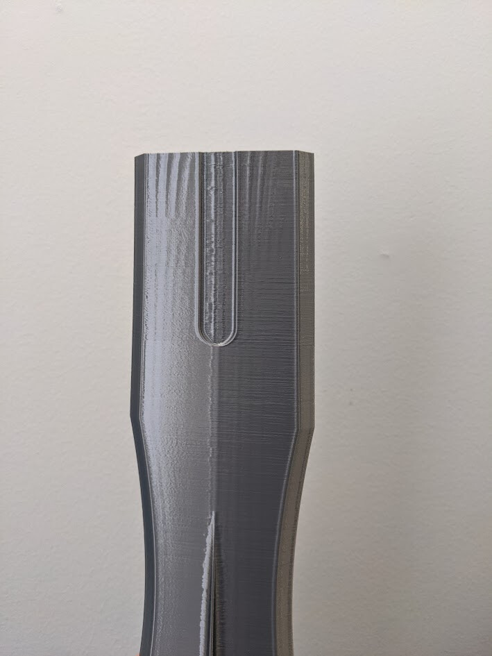

I am printing a tall model using PLA Silk+ on my A1 and I keep getting a wavy surface near the top layers:
I am using the 0.20mm Standard @BBL A1 profile with these adjustments to speed (slowing it down):
Outer wall: 30 mm/s
Inner wall: 150 mm/s
Sparse infill: 150 mm/s
Internal solid infill: 150 mm/s
What causes this wavy surface and how do I eliminate it?
is it a thin wall? have you tried printed it even slower (i.e. with the silent 50% profile)
I do not think it is thin walled, Wall loops = 4.
I could try even slower, is speed the problem?
I am not sure, but clearly it is vibrating on the top and the waves maybe come from the inside, so if you go ultra slow it wont happen, but I dont know if is the real solution
Thanks for the help, I’ll give it a try.
I was thinking vibration might be a problem since it’s a bed slinger and the model is pretty tall.
