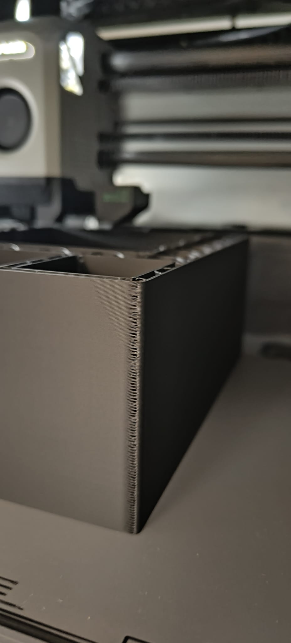

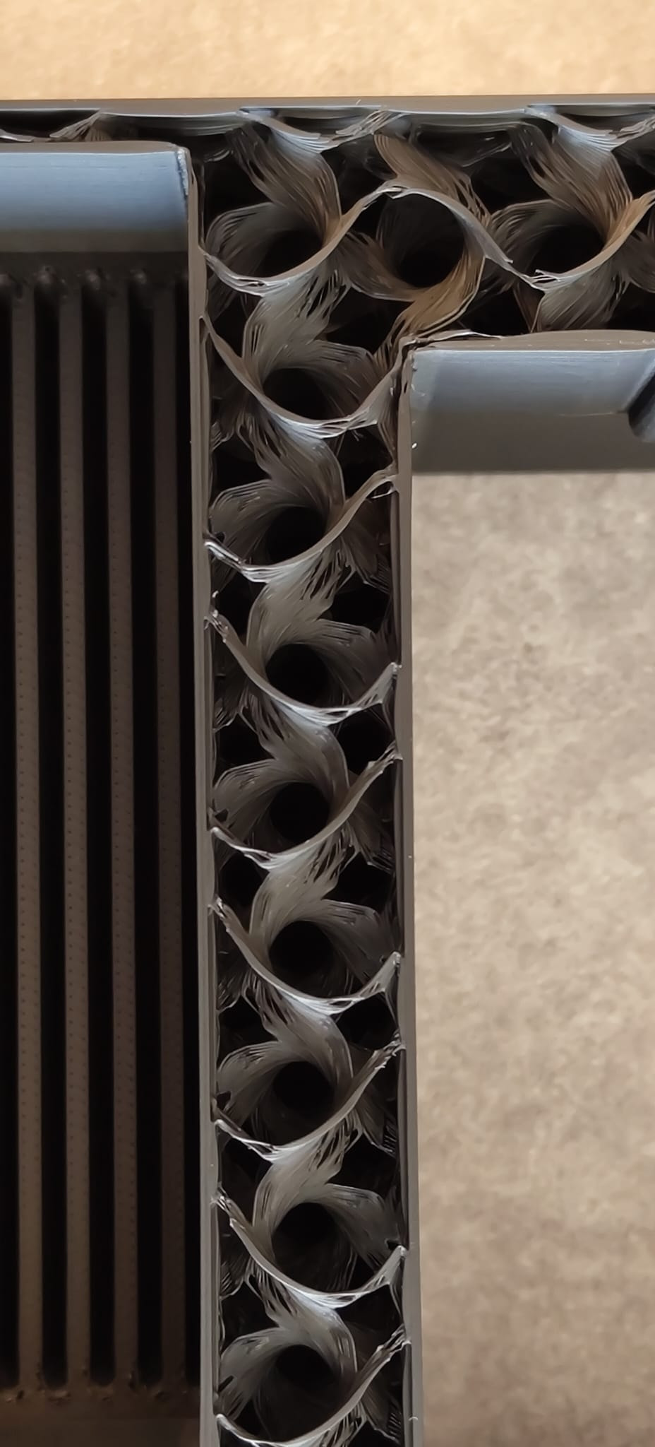

Weird Layer Defects in the corners and infill of the Print
Hi,
i have a X1C and right now have an weird issue that i have not seen before (look at the corners in the picture) and I am not sure whats the reason for :smiley: . I have tried to recalibrate the printer and cleaning /swapping the nozzle but i don’t think its a nozzle issue because on the straight paths its printing nicely.
I have printed the same model already a few times with no defects before. Not sure if something went wrong on the newest slicing. I guess its something with either the belt or the x/y axis.
Any Ideas?
My first suspect for underextrusion only at direction changes is incorrect pressure advance. Did you change anything lately?
Not really, not sure if i updated the bambu slicer in between the last print and now but good idea. I will take a look at that.
Thanks already, i am currently printing a test model after some additional maintainance and callibration maybe that helped a bit too :D.
If you open other peoples’ models in Bambu Studio, it may have updated all your settings with the ones in the model you opened. It warns/asks if you want to update things but it’s easy to click through and inadvertently overwrite settings.
It at least used to be easy to overwrite settings. Happened to me a few times until I finally figured out why things were mysteriously changing. Some print profiles may have weird settings either on purpose or possibly the person who posted it somehow had wonky settings themselves.
Update: after doing an automatic flowdynamic calibration and a PA calibration with the bambu lab auto gen models and now its printing awesome again :D. thanks for your help, it seems that the update messed up my settings a bit.
