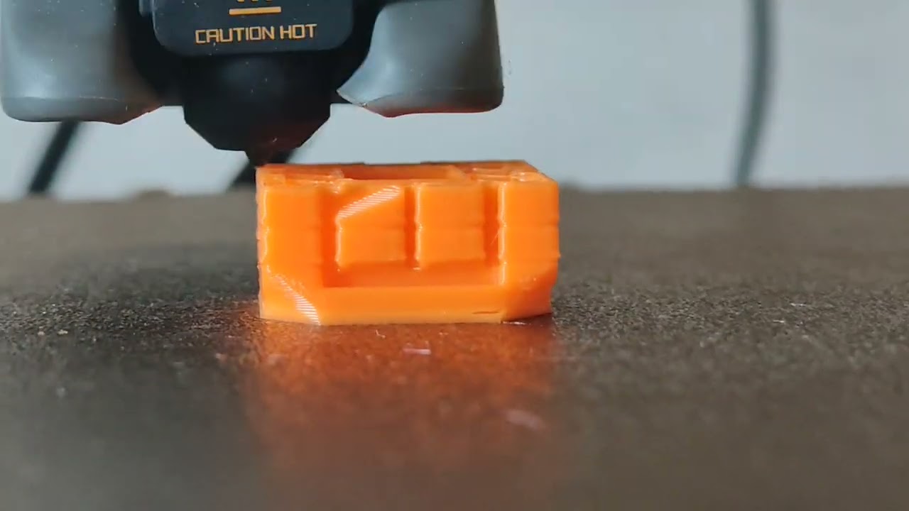

I have the a1 on irregular usage over the course of 8-10 month i guess.
Lately all my prints, doesnt matter the profile ,filemant or nozzle, are all messed up like you see in the pictures.
Someone on reddit pointed me towards a bended z axis, but how? and why now,after several good prints?
Would appreciate any sort of feedback. Thanks in advance.

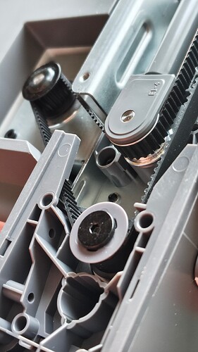

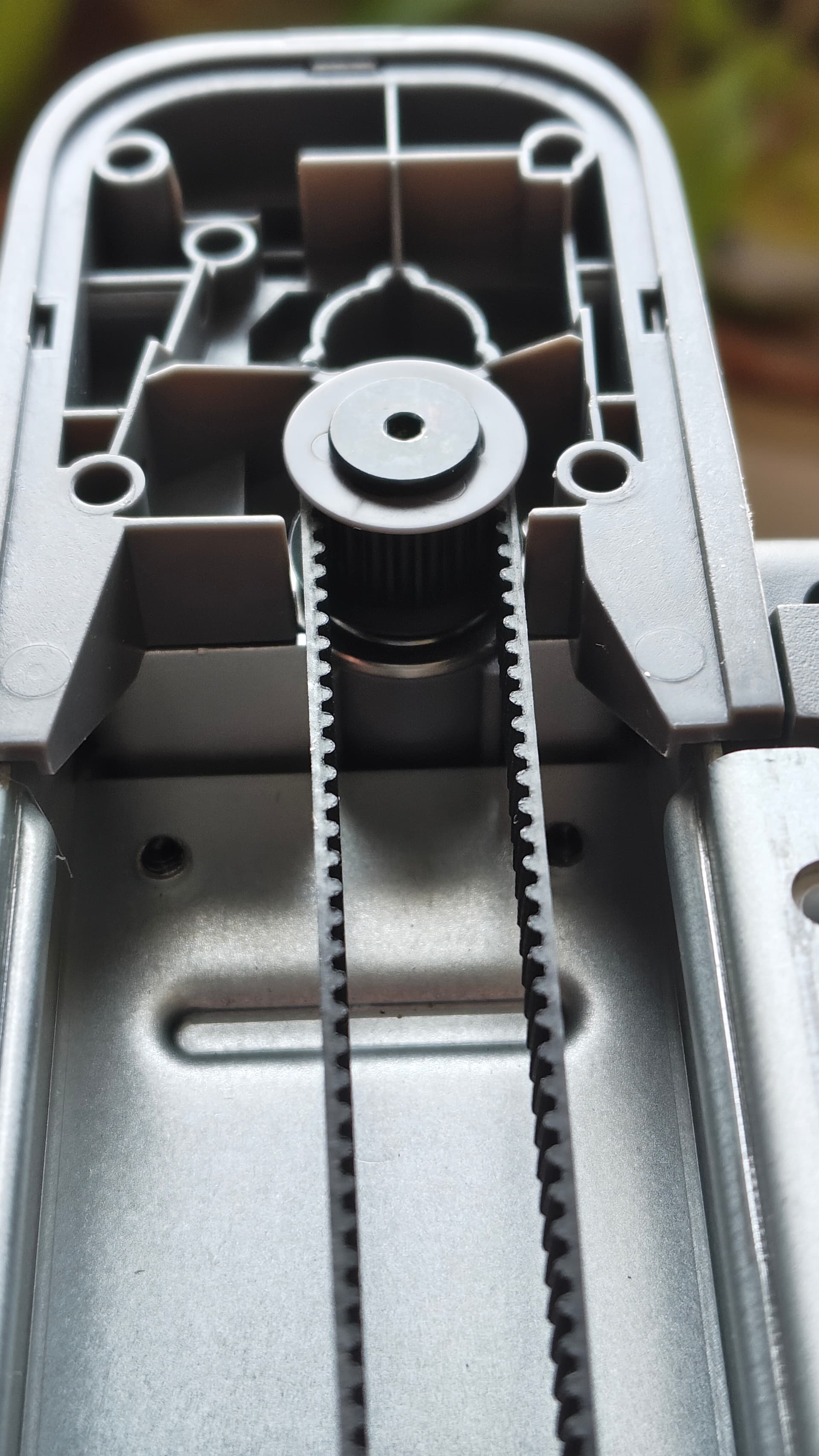

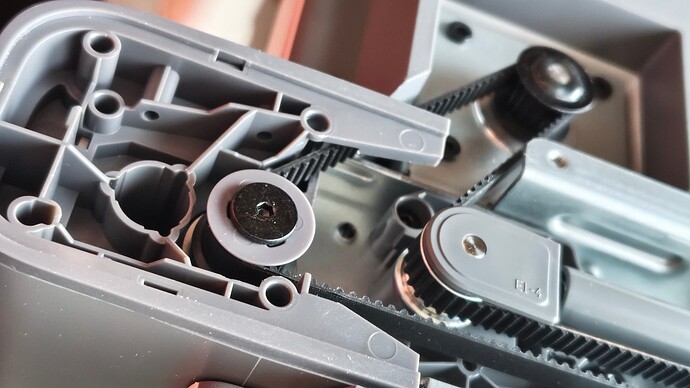

I don’t know enough about how the A1 is built to suggest anything else. The issue you’re having looks like a highly-repeatable Z axis error. If there’s a belt that drives the screws, you might check that to see if it’s damaged and/or if there’s some printing debris stuck to it, or maybe one of the pulleys the belt rides on is wobbling…

So got finally time to do everything you said and… nothing.
No debris, no damage. Calibration did nothing, aswell as default setting for everything and resetting the printer.
What i noticed is some “clack” sound. I’ve recorded a little part of the standard cube print and near the end of the 1 min video you hear the sound.
