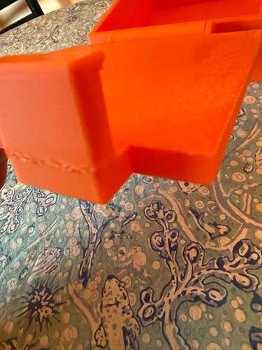

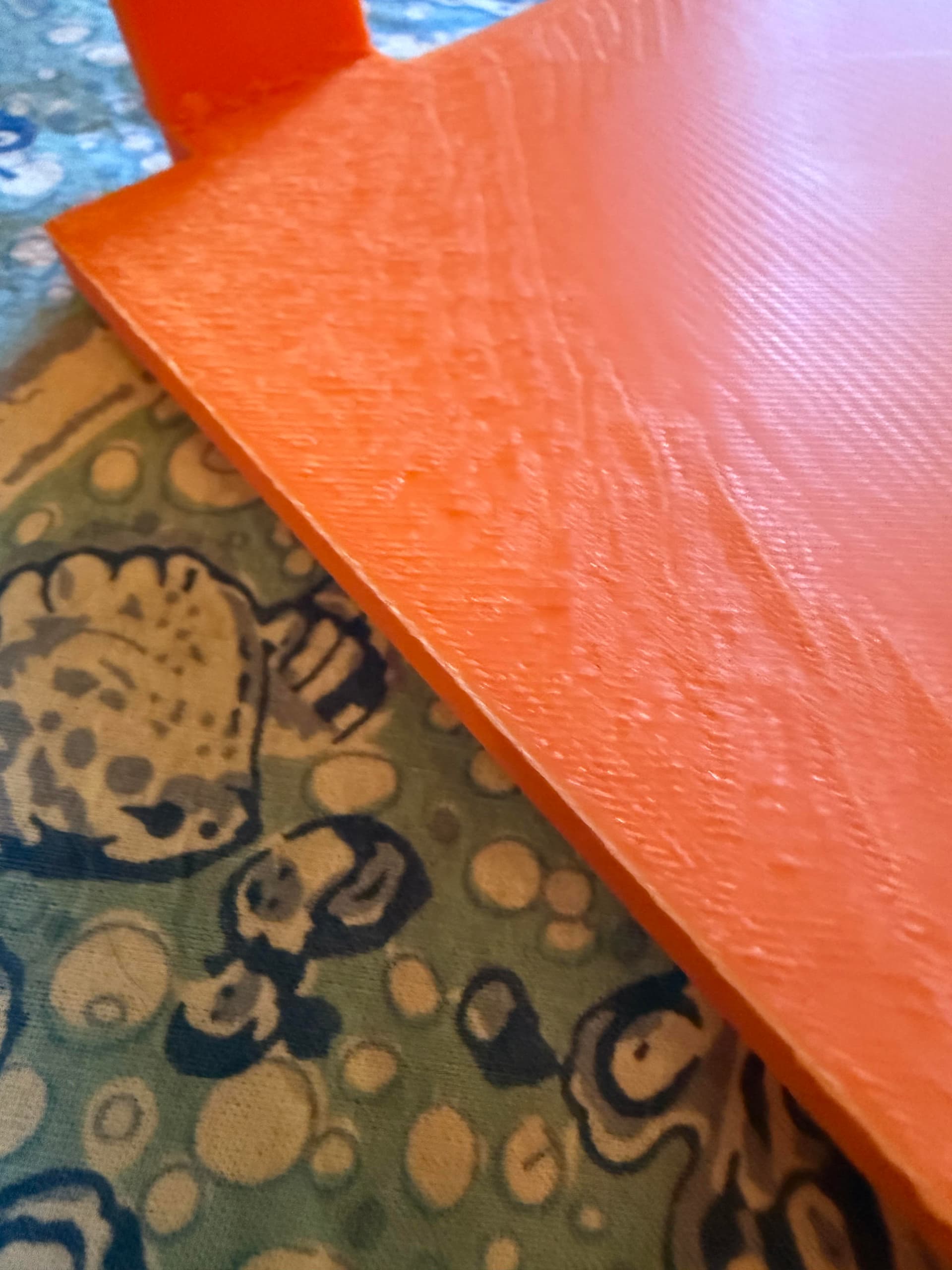

Weird pattern on top of print?
Finished a print with my P1S and the last few layers look sort of weird. Not a huge deal since its mostly cosmetic but what might have caused this?
Top surface patterns like this are usually caused by the print slightly warping up off the print bed.
