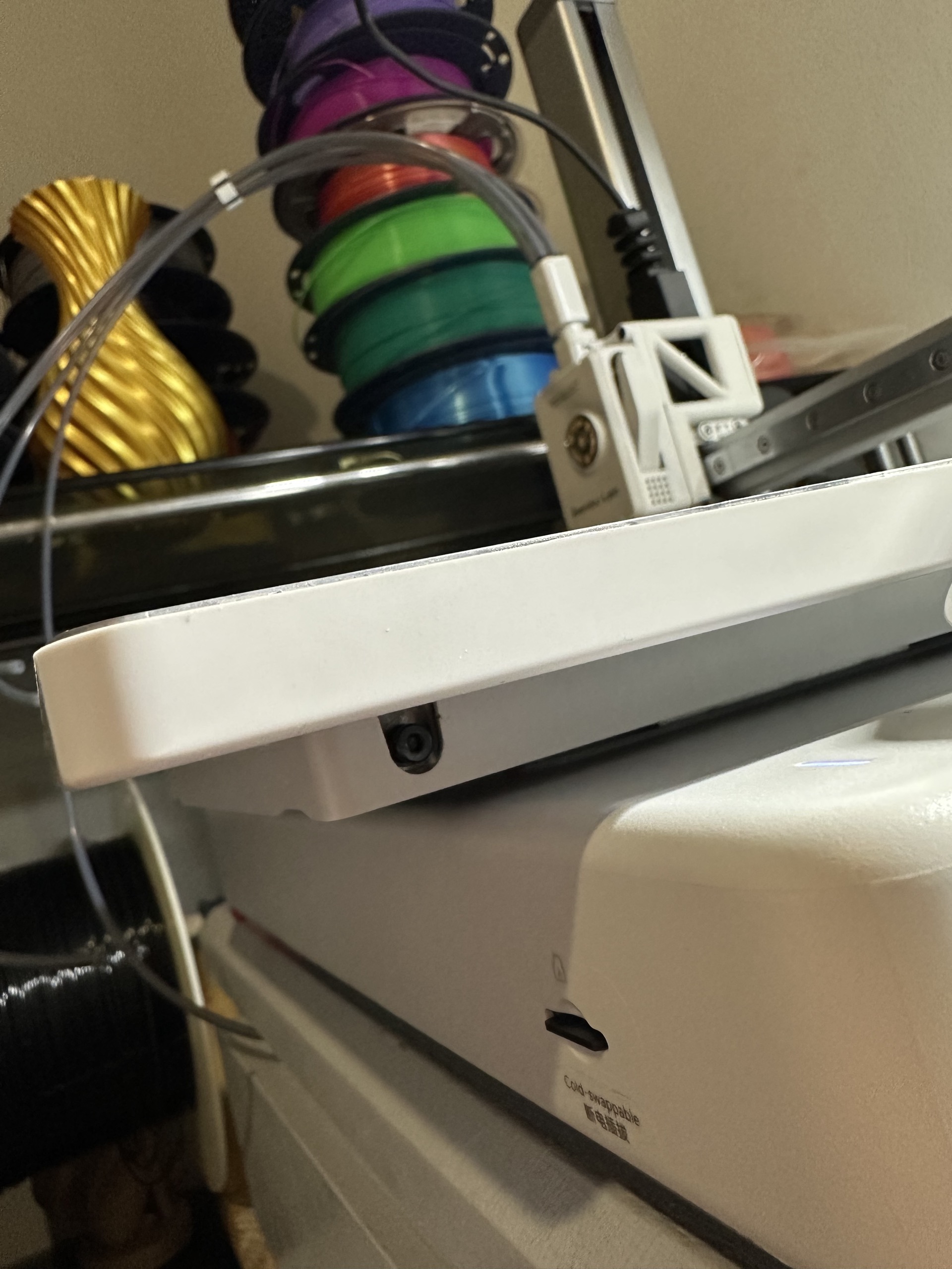

I recently modded my A1 and put the AMS on top. One of my spools fell of the AMS and hit the X-rail.
Now its pushing against the print. Is there anything i can do?
Bed tramming is failing on the right side, as the screw is tightened completely and the nozzle still touches the bed…
Anyway i can make the adjustments myself?

Nothing looks damaged, its just dragging on the print like hell… might have managed to do the bed tramming though, just noticed the screw on the side… :melting_face:
I was looking underneath, as for the A1 mini :person_facepalming:

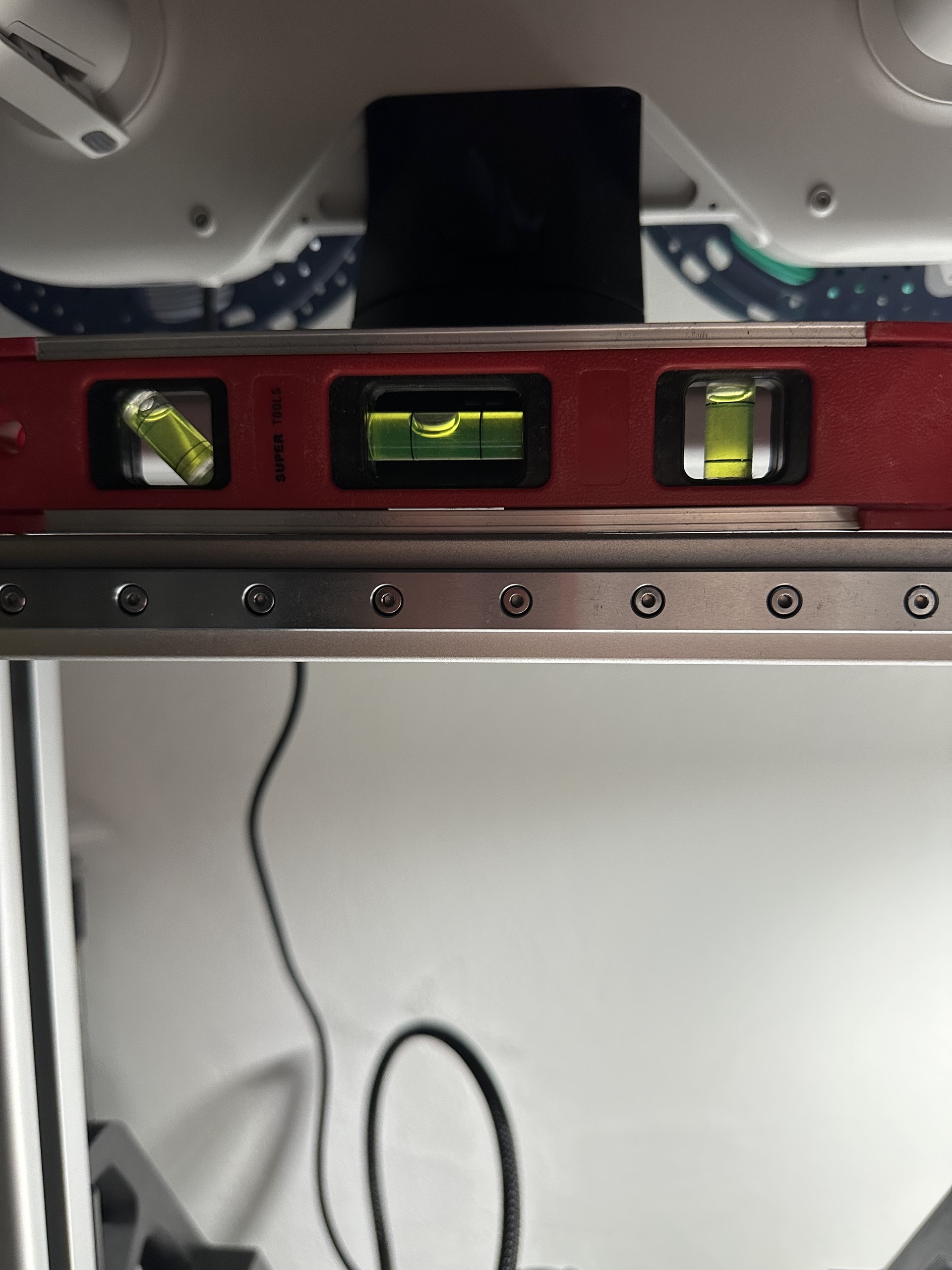

If the tramming works and stops the dragging I’d suggest the first thing you print is a square - then use a professional square to make sure your printed square is really square. If it is you should be all set, but if it’s not you’ll have to get the x-axis more parallel to the top frame. It’s not horribly off from the picture, but it would make me paranoid just the same.

The bubble is off all over the frame so it might of not hot the x-rail but the bed itself. The offset might be what the printer stands on.
