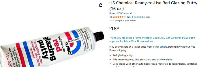

I use this - it comes in 16oz tube:
I mix it with acetone and brush it on.
Lots and lots of sanding follows…
