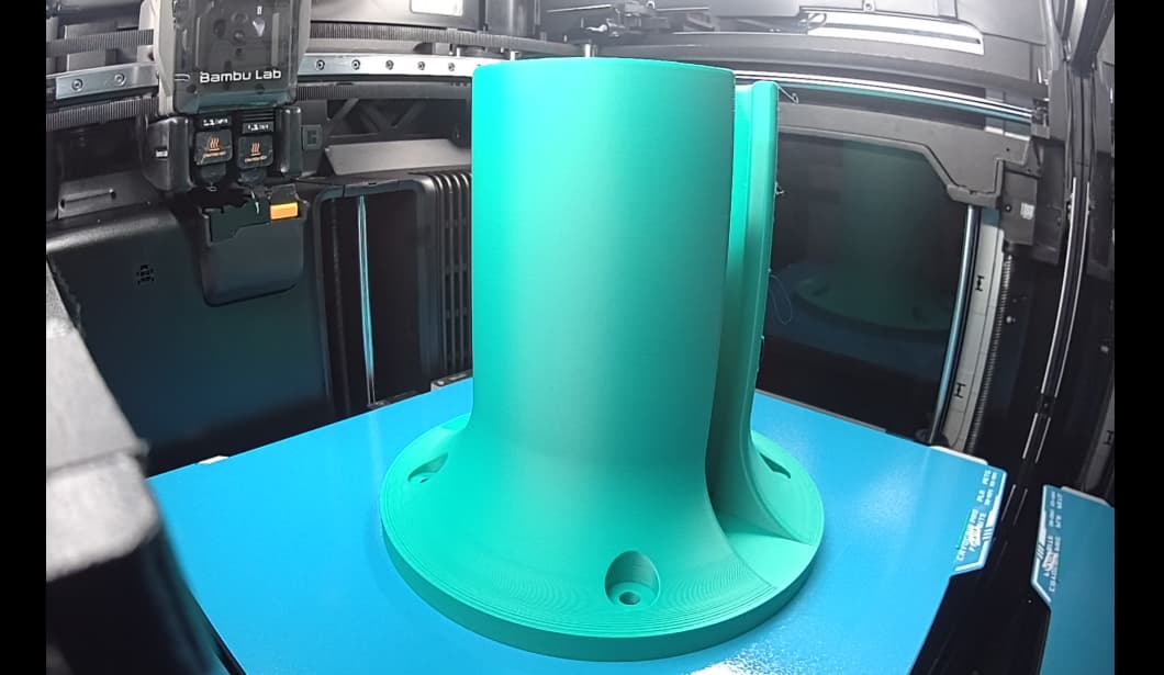

What causes these obnoxious lines on the H2D prints?
And what’s the solution?
You can see the horizontal lines where the wall should be smooth.

File looks good to me, should be some sort of hardware issue, most likely wobble nozzle. or just wipe your z lead screws a couple times then re lube them
Try greasing and oiling all the metal parts, then rerun all calibrations. It helped when my prints looked much like yours.
There’s a good chance this may be it, because the onset was about the same time that I did exactly that maintenance. I was very thorough at removing the old oil and grease, but maybe I didn’t get enough of the new oil and grease in every nook and cranny that it needs to get.

It turns out the printer has big time “nozzle wobble”. When I last changed the hotend-nozzle, the clasp unexpectedly flew off. I pressed it back on, but evidently it’s now shot, as I just confirmed that I can easily wobble the nozzle even when it’s closed… So, I guess I’ll have to order a new hotend heating assembly:

I’ve printed this model before, and I can confirm that prior to the “unclasping malfunction,” for lack of a better term, it printed the walls extremely flat without all these lines.
It turns out there’s a correct way and a wrong way to close the clasp, and on the right nozzle I inadvertently did the wrong way. I re-clasped it the correct way, and now it’s solid. No wobble. No big deal. I’ll pay closer attention in the future. :slightly_smiling_face:

What a great community we have! Just wanted to thank everyone for their suggestions and comments. Here’s a photo of a new print, freshly completed and still on the build plate, without the nozzle wobble. All those obnoxious lines are gone:
Final proof by inspection that it worked. QED.
