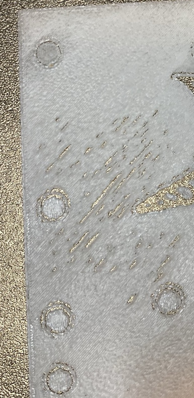

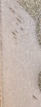

What could be the cause for this?
This is initial layer. It does not happen to fill in whole the design in overall, but the perimeters (at one side) appear to be detached everywhere, it’s like nozzle lost its alignment. I noticed when printing circles around screw holes the nozzle does NOT perform full circle, the circle looks like incomplete which is very strange.
Where to look into? ABS. Layer height=0.2, initial=0.24. Width=0.24. Speed=20mm/s. Plate was cleaned with spirit beforehand. Filament was dried,
Hm, hard to say. I tend to wet filament but you’ve said filament is dry. Too much resistance for filament feed may lead to similar results too.

  1. when screw holes are drawn the head does NOT perform full circle, the perimeter is open.
  2. Why there’s an offset between the hole perimeter and the fill.
I did not get what you wanted to say.

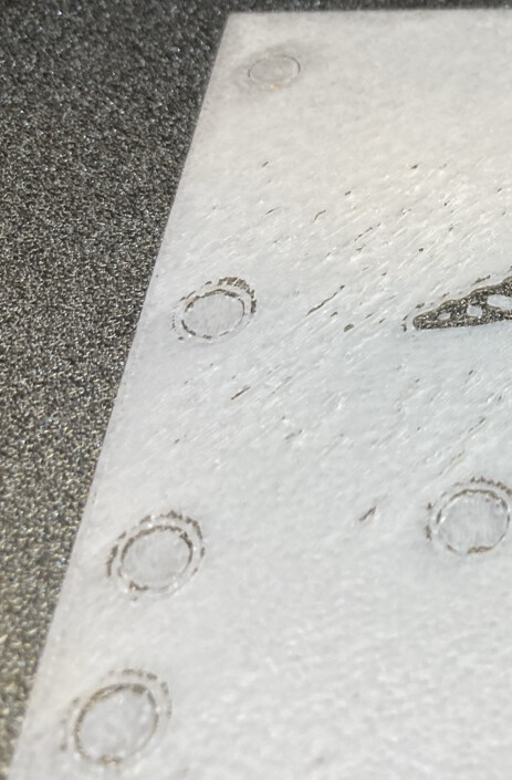

Double check the slicer preview. I wonder if what is filling in those holes is just support for the bottom of the hole (which is above the plate)?
If that’s what those are - the beginnings of support for the bottom of those holes, depending on what the hole needs to look like, if you chamfer that bottom of the hole to the sides of the hole, you can eliminate support in them entirely without sacrificing anything.
But I wonder if that’s what you are seeing maybe?
Re: hole rounds - they are incomplete because they are support. Thanks, you are right.

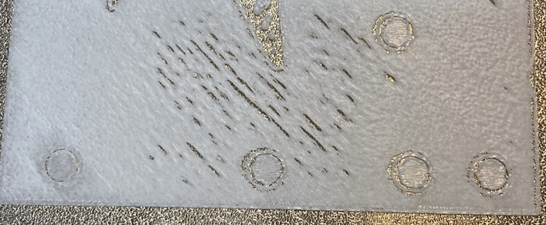

I am totally frustrated. I have three identical pieces on the plate, and all three are printing differently. They are located far back, middle and front. Far back is having issues in the pictures in this post. Middle one if being printed PERFECTLY. The front one prints even shittier, with perimeter closer to the plate edge not sticking at all. Sounds like plate temperature issue?
I have set default line width as 0.24. However infill is 0.4 and walls are 0.4. But, for the initial layer, Studio only provides single override “initial layer”, if I set it to 0.24 then EVERYTHING is being printed 0.24, including perimeters/walls which do not stick properly. If I set it to 0.3 or 0.4 then I lose details on the art of the initial layer.
Is there a way to make studio to at least have thick walls? I asked AI it started to hallucinate on “initial layer infill width” which I can not find. If I will make walls 0.4 at the initial layer they (hopefully) will stick properly.
It also proposed to create modifier for first layer - sounds ugly workaround though.
Update: WTF setting “initial layer” width to 0 seems to be the solution. But I think I tried it in the past and have got negative wall size for arachne wall generator.
