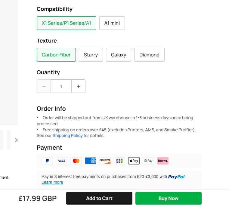

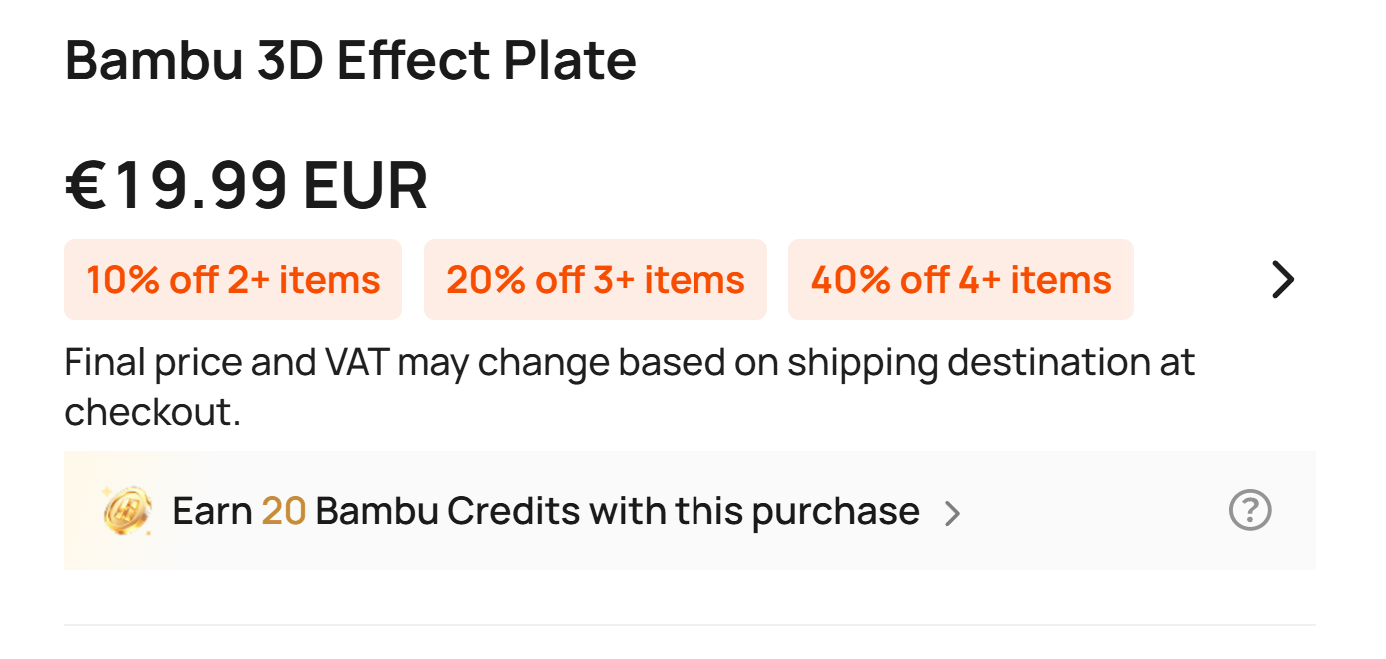

Hi if I order a 3D effect sheet as shown below, what do I get? do I need a plate of does it come with one? If not what plate do I need?
It depends on what exactly you want to order, which unfortunately isn’t clear from your screenshot: If you order “plate”, it comes with a plate. If you order “sheet”, then it’s just the sheet.

You get a rolled or folded effect sheet that has to be applied to one (if you have more than one) of your Bambu plates. For how to do it, either check Bambu’s Wiki, or read the first reply to your post.
It depends - if he orders the “plate” set, it will come with the plate and foil already applied. If he orders the “sheet” set, it comes without a plate, and he’ll have to attach it himself. Bambu described it a bit confusingly.
